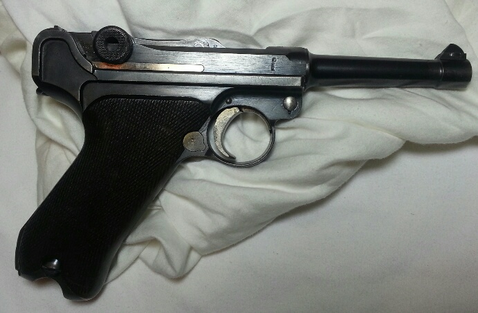

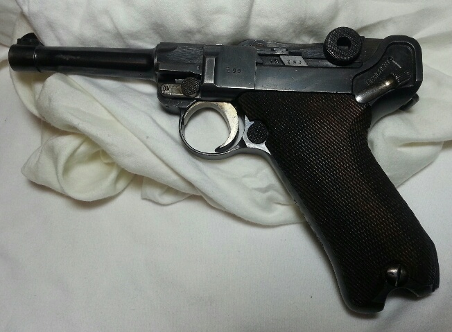

This luger was brought back to the states by my husband's late father-in-law around 1946 (As family lore goes). I knew absolutely nothing about guns, let alone Lugers, until I found my way here. I have to admit I'm hooked!
I have read and searched these forums, and the more I learn, the less qualifiedI feel to even post a question. I am humbled by the level of expertise represented here and will try not to waste your time.

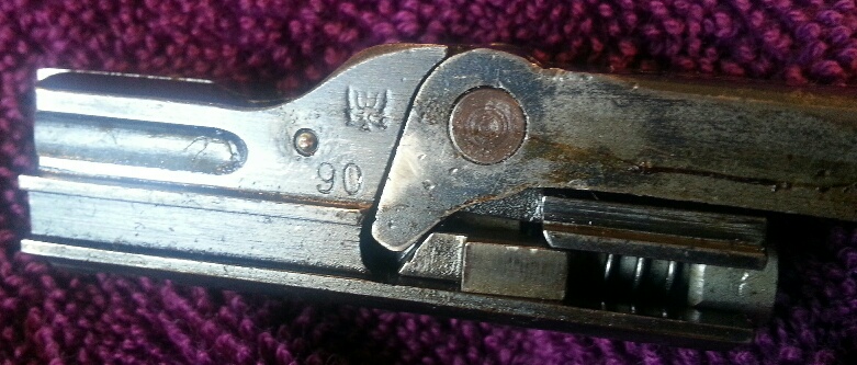

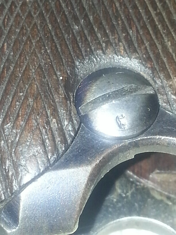

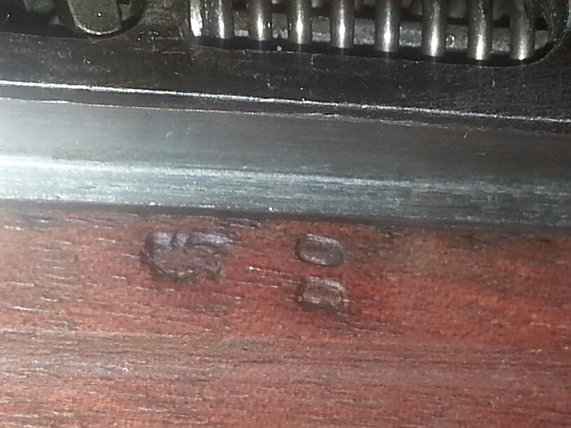

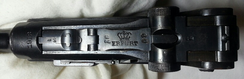

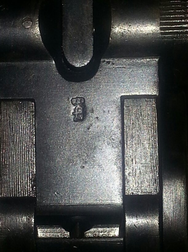

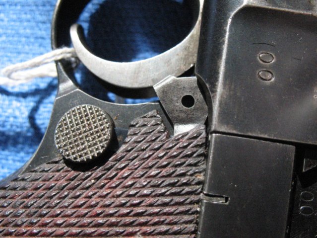

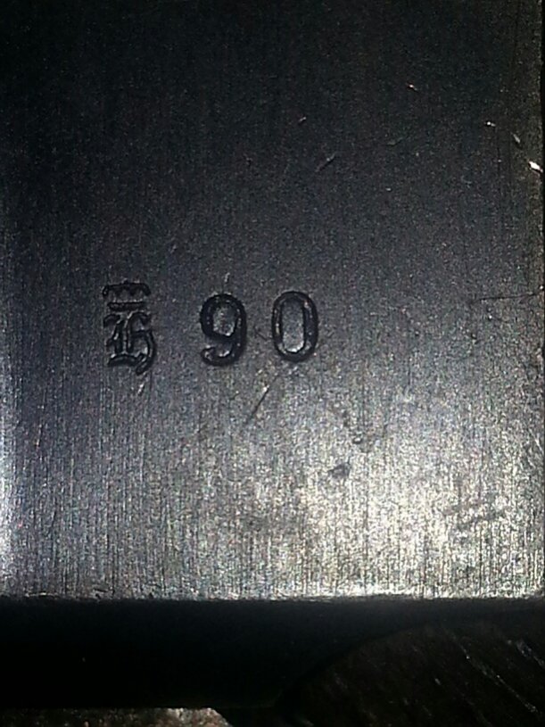

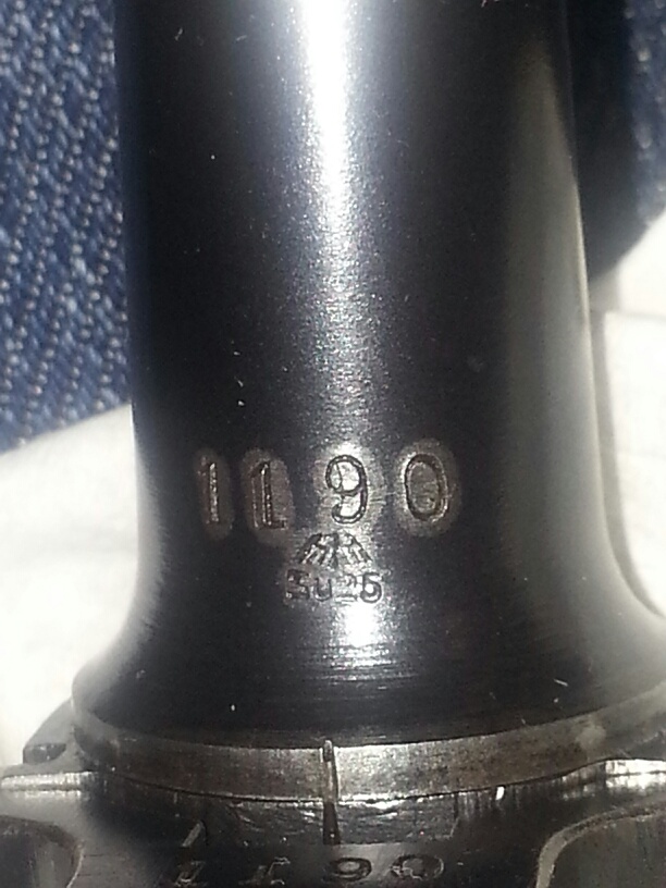

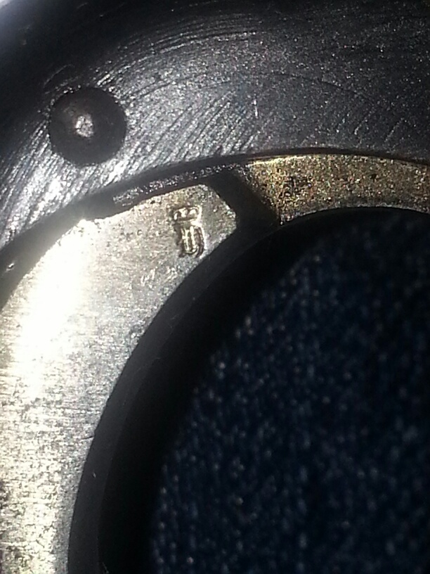

I am confused by the double striking or mistriking of the 90 on a two places on the gun. Pictures below. It almost looks like they stamped 89 and then stamped 90 over it. Makes me very skeptical. We know it's been in a safe for the last 70 years, but before that is anyone's guess.

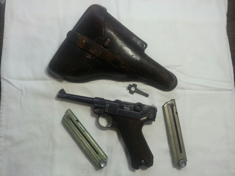

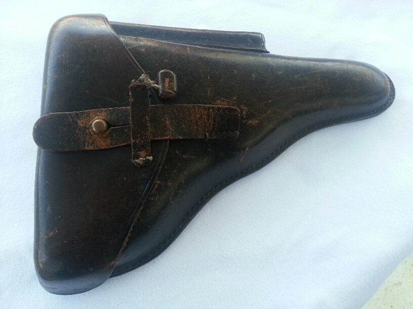

I've been told the vertical strap on the holster means it's a police holster, but I'm confconfusedby the unit marking P.A.L.II.409.

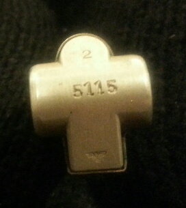

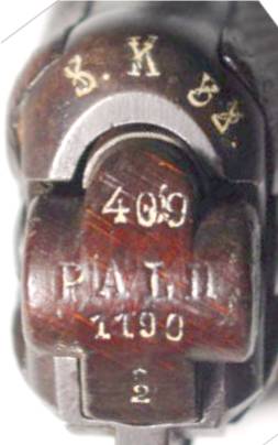

One magazine has a matching serial number, the other does not.
There are numerous markings, even on the grip screws.
Any input would be much appreciated.
I am still working on my photo skills but would be glad to provide more photos.
Thank you in advance for your time.
Sincerely,
Diane

Hi and welcome to the luger forum.
You have a late Imperial dated 1918 Erfurt made luger, taken into police service during the Weimar Republic era.

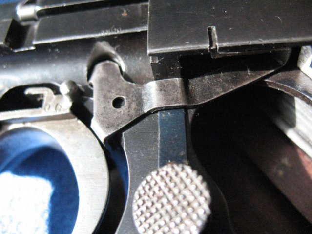

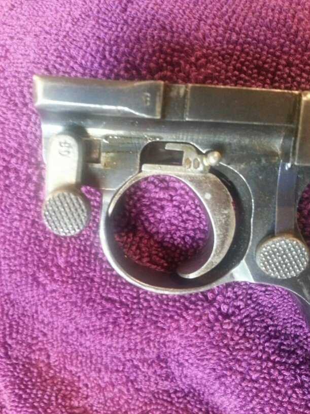

It has an added safety above the sear bar, which is peculiar to police luger pistols and was added about 1932-3. The luger may have been "reworked" at that time and the part that is overstamped renumbered to match when replaced- no way to know for sure- but any needed replacements were commonly re-numbered.
The marking is that of the PolizeiAmt Leipzig, The Roman II is a sub area, and 409 is the weapon number in the police system of Leipzig. This info from the great book by member Don Maus,
History Writ in Steel, pp220-221.
Your holster is also the police pattern, with the "up" strap and no buckle. The one matching magazine is a nice extra, and has the police acceptance of eagle/L - which dates to Third Reich times.
This luger no doubt served through the Weimar era and through WWII.
Good pictures, but a little more light would help, a grey or other darker than white background will help get better exposure..
The holster may have markings on the back and/or inside the top flap, if marked , please show more pictures.
Check out the stickys with a lot of info in the new collector area.

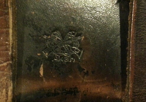

The holster has a marking on the back between the belt loops.
I'm also posting a pic of the other restamping.

That is the makers mark of Akah, a manufacturer of sporting gear still in business today. Your holster was a Commercial before it saw Police service.

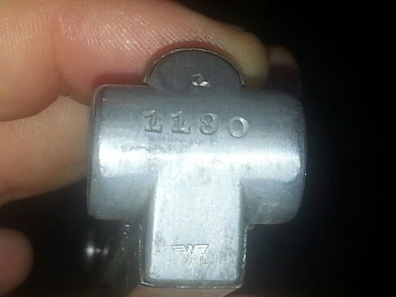

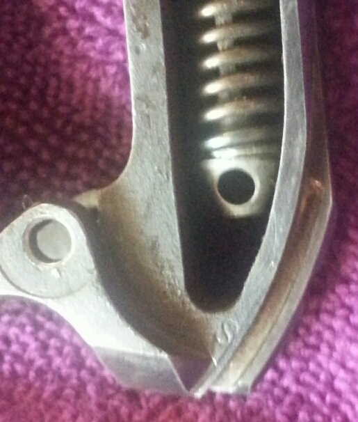

The number 1190 MAY be on the back of the tool or someplace on the holster. If you are skilled enough to take the pistol apart there are many more markings to be seen inside.

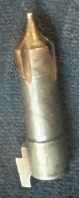

Many of these pistols were re furbished by Mauser..It is discovered by seeing if the rear toggle pin is numbered or if the firing pin is fluted. Neither of these were on the original pistol.

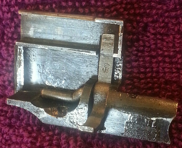

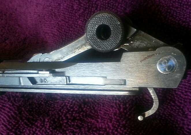

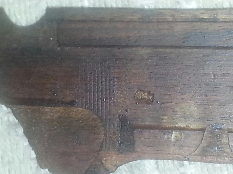

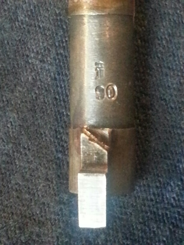

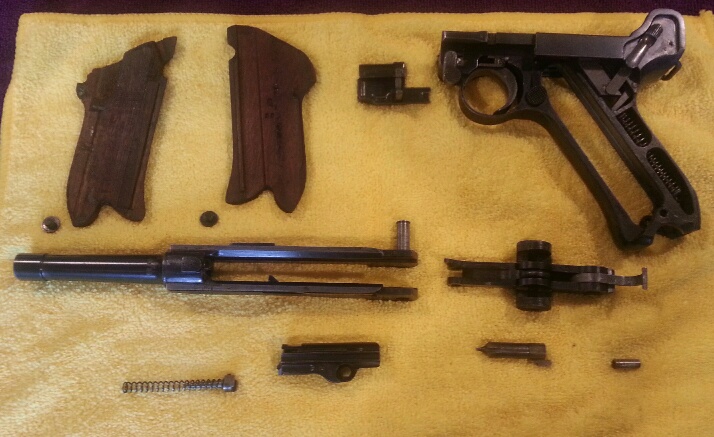

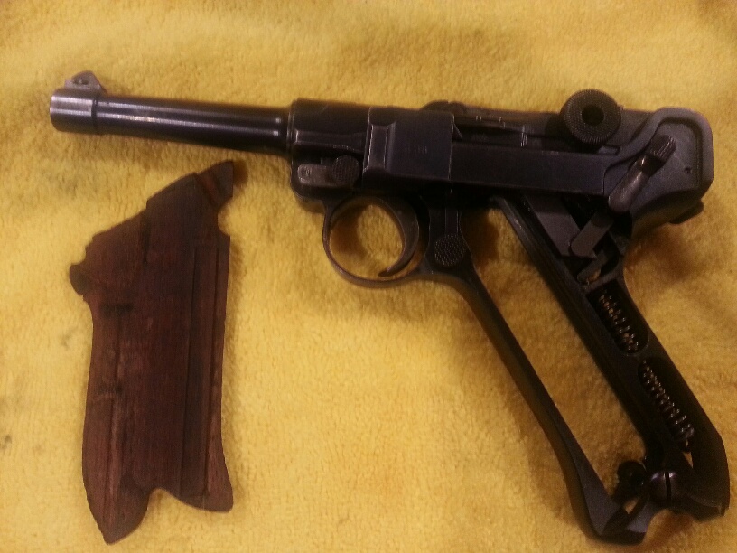

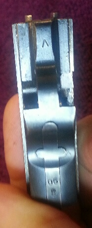

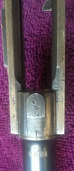

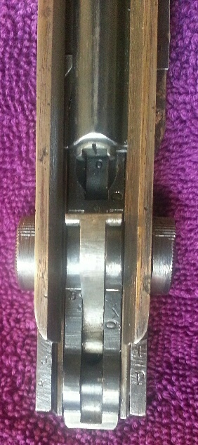

Here are a few more photos. There was only one mark and no number under the left grip. The right grip has a mark and the number 90.
There are marks on almost every piece and plain.
I included a pic of the other magazine marking.

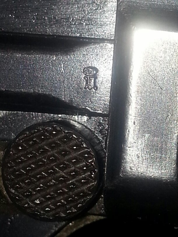

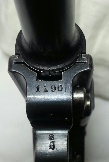

I also included another photo of the serial number and the marking underneath it. What is under the eagle? I haven't seen another like it but I haven't gotten my hands on any books yet.
I understand how guns were turned in and double dated and reissued, but this only has the one date of 1918. Does that mean it was originally issued to the police? Or was it manufactured and sat unused until the sear safety was added and then went to the police?
I also find it odd that all the other 90's are so clearly marked.

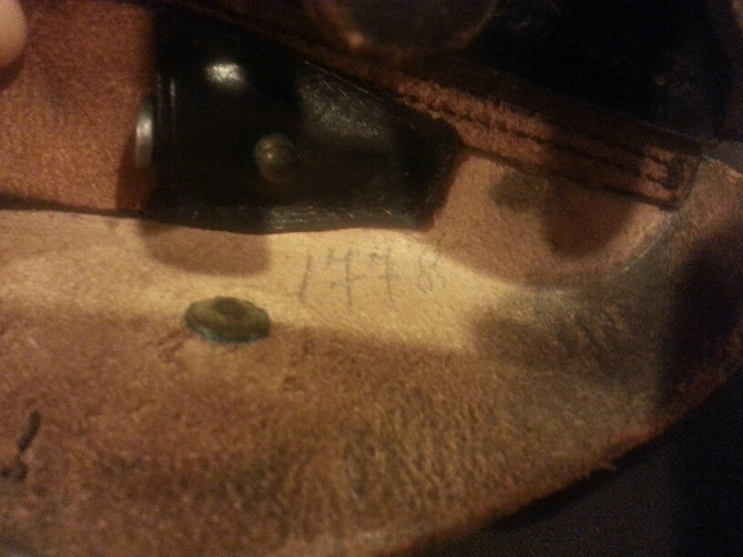

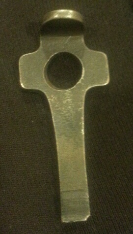

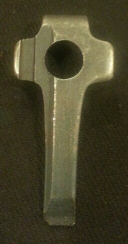

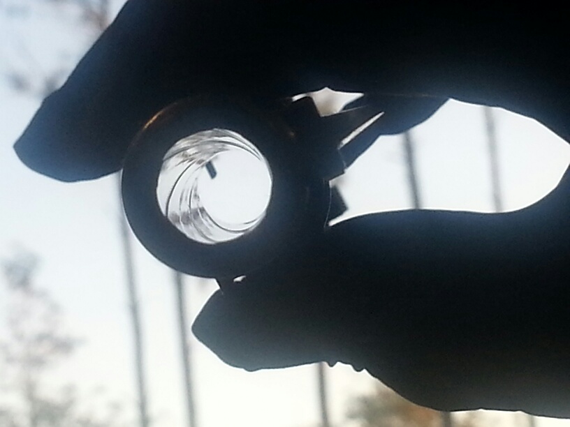

Jerry, there are no numbers or marks on either side of the tool, but II did find a penciled number 1778 on the underside of the holster flap. Could that be the original holster number? We're they written in pencil? Do you think any of our scribbling will be so cherished 100 years from now?
We have not checked out the firing pin yet.

The presence of only two acceptance/proof marks on the receiver indicate it was a "spare" receiver and perhaps not used or assembled until after the 1920 marking (which lasted only about a year from 1920-21, though only 1920 was the property marking applied).
The "Su25" seen on the bottom of the barrel, also indicates a replacement barrel, assembled/used when built/rebuilt at the Spandau arsenal ca. the late 1920's.
The numbered right grip is likely the original grip, the left grip was often replaced - especially if the pistol received the magazine safety during "upgrades" in the 1930's. The mag safety was later removed or inactivated as they caused function problems, but the grip which was cut specifically for the mag safety was often retained, or replaced with another grip at the time.
A picture of the upper grip area with the left grip off would help, as would a picture of the inside of the left grip in total or just the upper half.
The spare mag is the #2 mag from another police luger.
Don't worry too much about the over strikes, they may simply indicate use of a previously numbered part during the extensive rebuilt that this pistol received; it was likely refinished during the 1930s update, and appears to be original to work done in that period.
I'm not sure what you mean by "squibbling" and 100 years, but it has been 100 years since this piece was first made, so maybe that answers the question- in the future- who knows.

Diane, 1778 is likely a pistol serial yes. Not done in the usual Police serial number manner but not much other reason to see such a 4 digit number. Usually the German Police stamped serial numbers in the back right corner or along the front body leading edge of the holster. This being a commercial AKAH holster..anything is possible.
The tool looks original. Might just be the original commercial tool.

Having a commercial holster is a bit odd, as most police "rigs" have government contractor marked issue holsters.
I'm not convinced the hand written number inside is a "police" number- but it makes little or no difference to the value or desirability of your rig; if it were the same number as the pistol it would be an enhancement. JMHO.

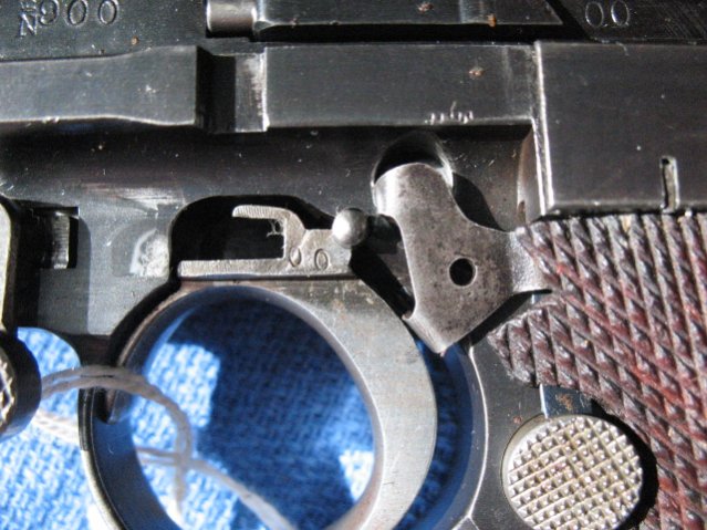

Wow!!! This doesn't happen often. I have recorded in HWIS Table 14-4 a wood-base mag stamped 490, PALII , 1190, 2 (vertical orientation). These almost certainly indicate the inventory number, police headquarters, gun serial number and spare magazine. Note the difference in inventory numbers. Fortunately, I have also included a photo of this base in HWIS on p. 222 and can see how I misread this number. It is actually 409. This is the original spare magazine for your gun!!!!! How it got into this other gun is a mystery.

This is the original spare magazine for your gun!!!!! How it got into this other gun is a mystery. So another mystery..where is it?

Something to consider - although Mauser might have refurbished guns after WW1 - before that was DWM and later the police armory in Berlin was capable of doing just about anything, from what I understand.
Nice Erfurt - parts made by Erfurt, left over parts were either put together by police armorers or DWM (even some small gun smith shops were doing this) during the Weimar period, but it went into police service and likely served into WW2.
