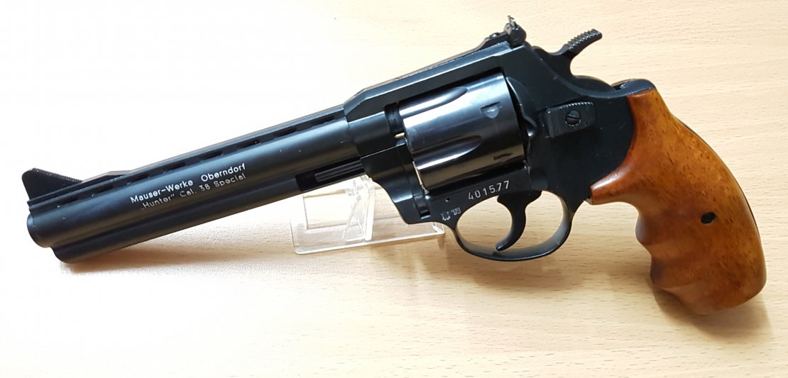

Nothing wrong with a .38 special sixgun. Provided the branding is right

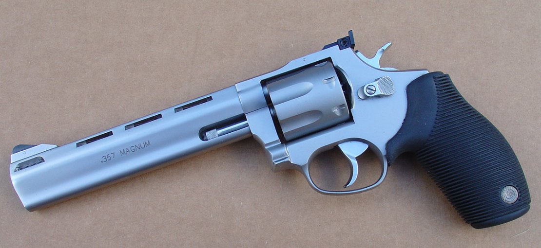

The gun arrived this afternoon. It is not a Smith and not a Colt, and I anticipate ridicule for that. It is a used Taurus 627. My friend has a Taurus 608 in .357 and I was impressed with it - excellent trigger and the ported barrel virtually eliminates muzzle jump. I was prepared to buy a new one but I was put off by the giant "TRACKER" logo on the side of current production. I got this one on Gunbroker for $325. and I am satisfied.
KFS

Unread 08-23-2018, 02:07 AM   #18
gunbugs
gunbugs's Avatar
Join Date: Sep 2013
Posts: 683
Thanks: 375
I've got about 6 or 8 S&w 38's. Other than the 52, the revolvers generally get a 158 SWC with 5.5 of AA No5. Kind of my "go to" load. I've been shooting it for decades. A little faster than a true "target" load, but it shoots well out of all my guns.
Unread 08-23-2018, 03:03 PM   #19
Thanks: 2,750
KFS
You will get no ridicule from me concerning Taurus revolvers.....I own three(3) of them, all big bore(44Spec and 45LC). I have owned them for many years, and they are some of my favorites to take to the range. Don't get me wrong, I own S&W revolvers(no Colt DA revolvers), and what is not to like about them??
Enjoy your new revolver, and with trial and error, you will find a load that is the "sweet spot" for it. Once you find it, then make a bunch of it, and shoot the snot out of it!!
