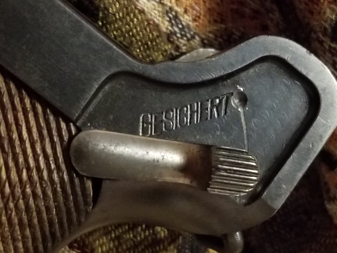

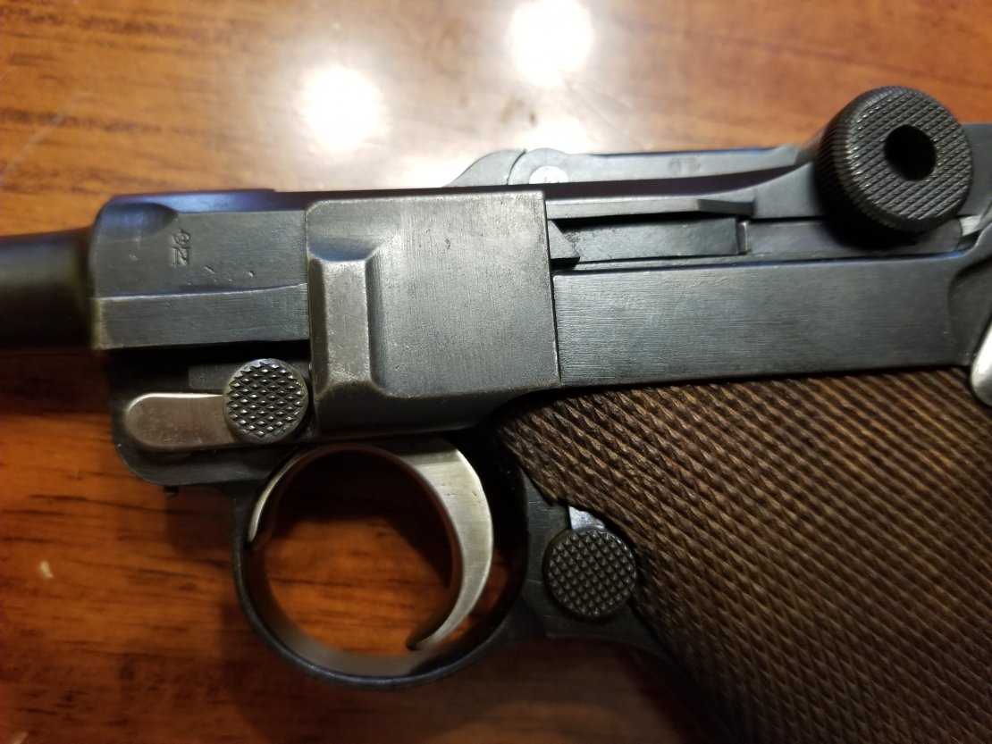

Hey everyone. So I have a german .30cal luger. Can anyone tell me anything about it? It has matching serial numbers,no numbers on the magazine and it is marked dwm on the top if the toggle. If anyone has any info I would appreciate the help. Thank you.

You have an interwar “alphabet” commercial Luger as indicated by the 4 letter serial number and the “i” suffix as well as the crown n proof mark. The blank wood based bottom is a correct style of magazine for this gun. Iirc “i” suffix Lugers are actually quite rare so this may have been a real steal for you, especially given its 9000 level serial number preceding the suffix. Need more pictures to tell you anything beyond that and I’m sure the others will enjoy the look at this too. Congrats on your piece of history and welcome to the forum. I’m sure one of the moderators will direct you to the FAQ and new collectors forum if you wish to look up some other basic pertinent information about your gun.

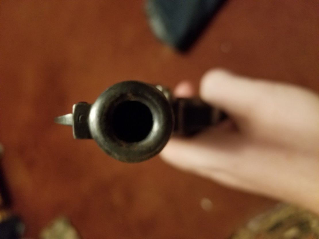

Pictures of all numbered parts you can see, all proof marks you can see, pictures of the barrel's rifling and such, and the muzzle for starters. To get pictures of some parts, you'll have to disassemble the pistol. Though on commercial pistols, they aren't always fully numbered and many parts are instead unnumbered (like the firing pin, grips, toggle pins/axles).

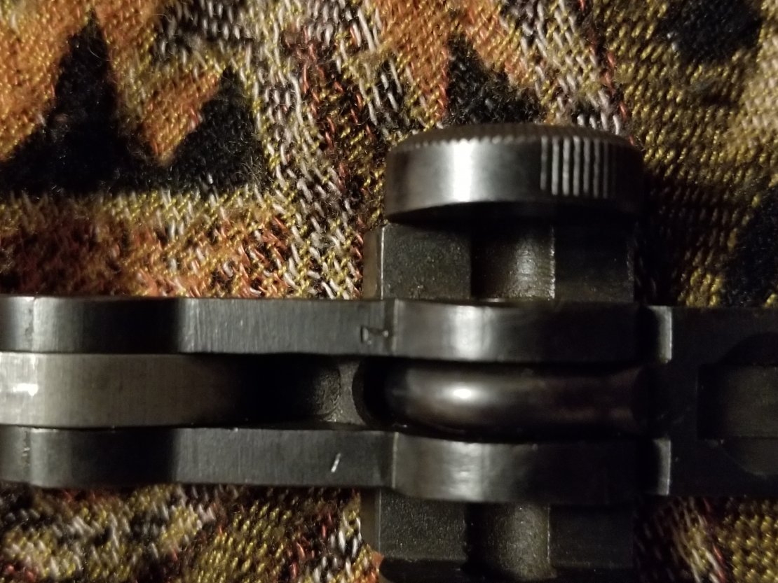

Your numbers are “hidden” in the commercial variations like this. On the bottom of the takedown lever and side plate is a number, the one for your breech block is also one you’ll need to take down to find. Same with extractor (if numbered). Bottom of safety lever will have one (if numbered) and will the sear block. Again, many don’t. My all matching commercial has only a numbered barrel, frame, toggle train, takedown lever, and sideplate. Those are the bare minimum, after that it’s spotty on whether the other parts get numbered or not from the reports of others.
