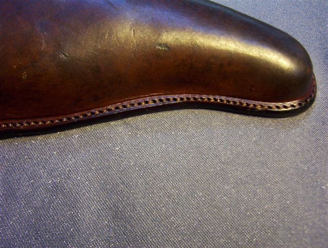

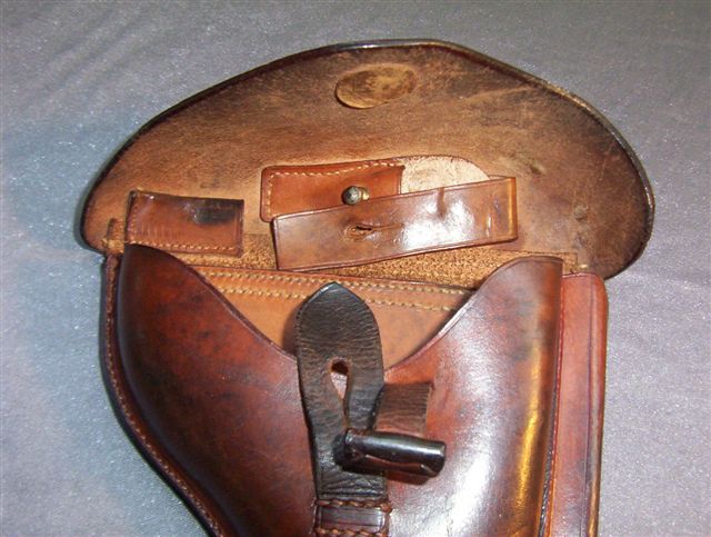

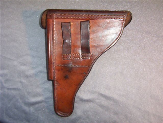

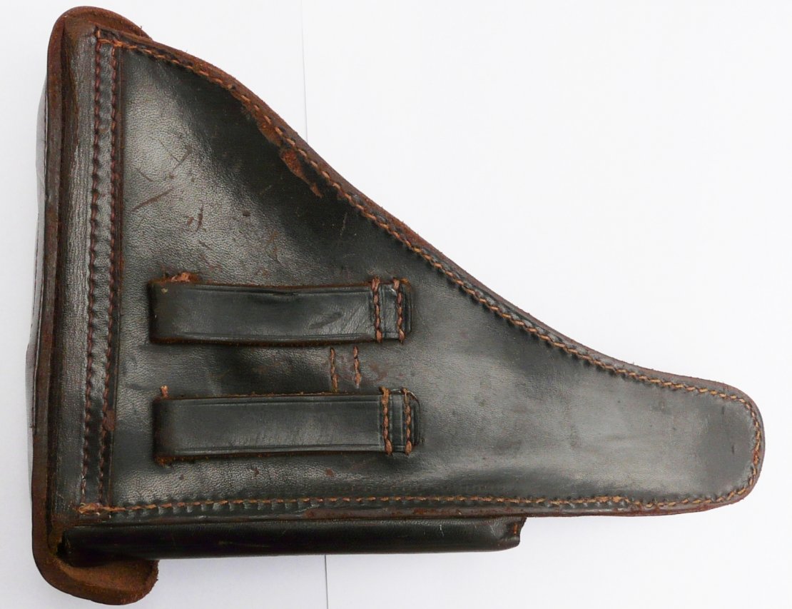

I've owned this holster for a while but have never seen an other one exactly like it. It came with my 1900 Commercial Luger and is similar to a P08 holster in some ways but the main points of difference are...
*from top to toe is about 10mm more than a P08 holster
*the stitching is much closer spacing than a P08
*the lifting strap and finger grip are wider
*there is a tool pouch and another loop inside the lid
*the belt loops are spaced closer together
The holster is well made and seems old but has no markings at all. Is it an early Commercial model? I would be most interested to hear any comments from the forum members.

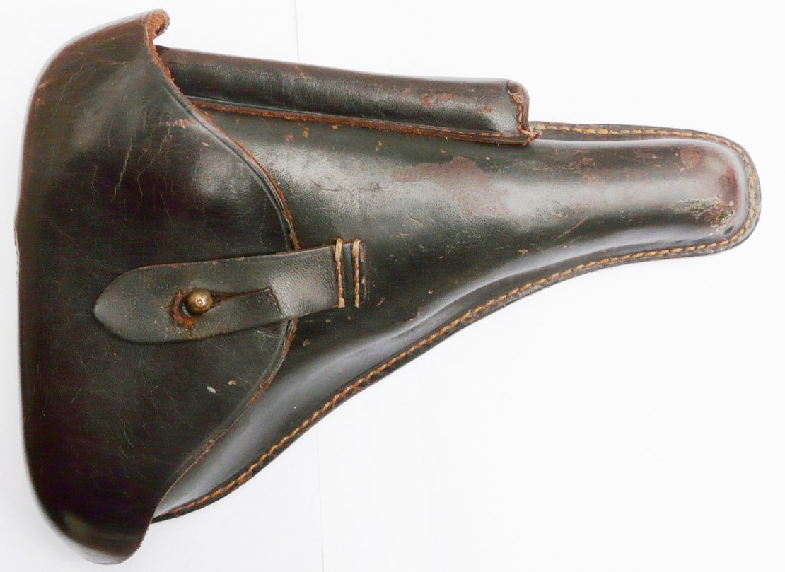

It looks like the typical commercial holster made by AKaH (Albrecht Kind aus Hunstig, a German holster maker and dealer since 1853) from the 1920th.

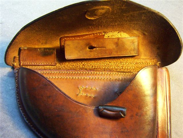

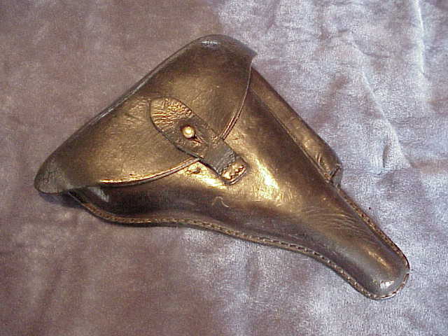

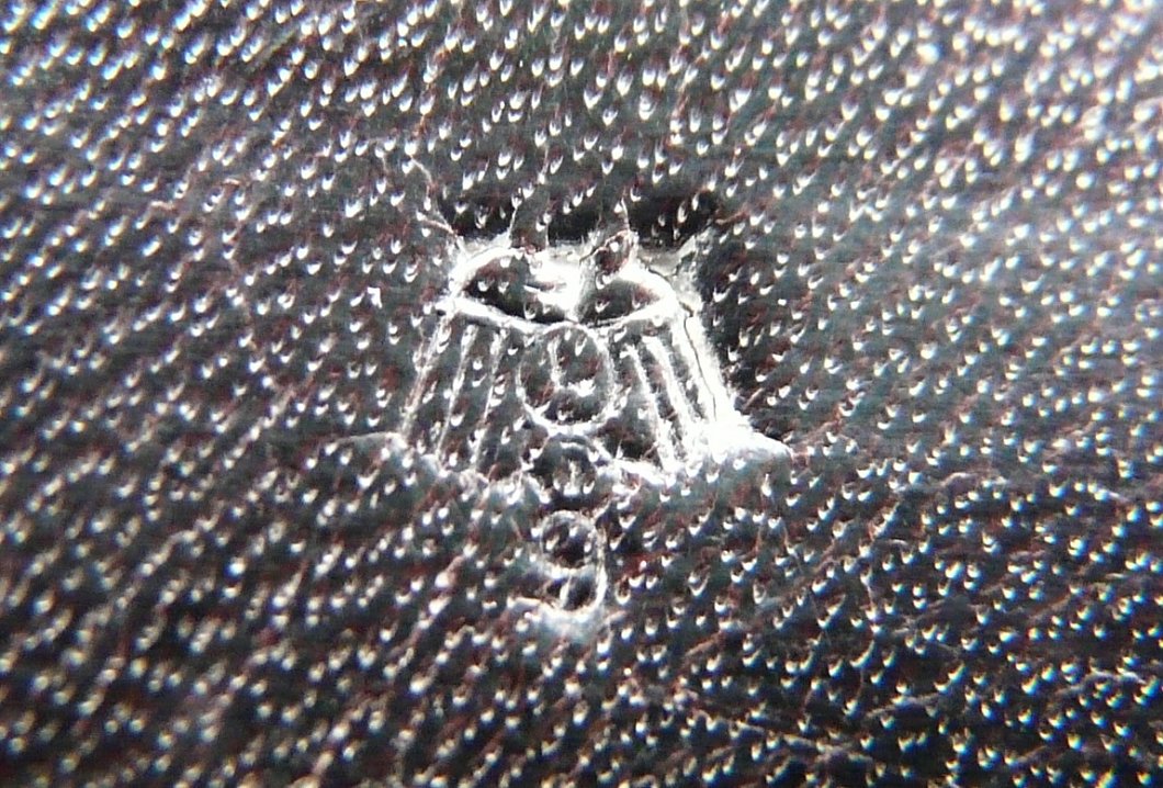

It seems that some were issued to the Army. This one has a Luftwaffen stamp.

Unread 06-13-2018, 11:32 AM   #5
MP38
MP38's Avatar
Join Date: Mar 2005
Location: Wisconsin
Posts: 464
Thanks: 36
Thanked 113 Times in 60 Posts
Yes, I've seen them unmarked, and also marked with "eagle/2" as well, just above the closure stud.

Unread 06-14-2018, 05:01 AM   #6
Mark1
Join Date: May 2008
Location: New Zealand
Posts: 72
Thanks: 332
Thanked 74 Times in 25 Posts
Thanks for the photos Klaus and Matt.
Very similar to my holster for sure. Apart from the colour the only obvious difference is the absence of the line of stitching below the belt loops.
Do your holsters have the same tool arrangement inside the lid?
Mark

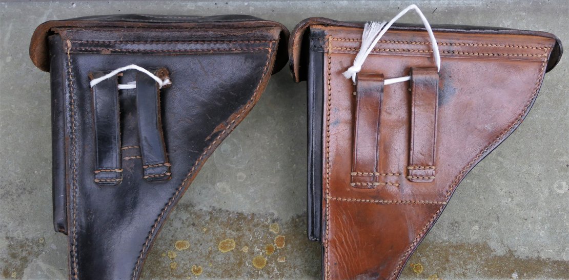

Unread 06-14-2018, 07:24 AM   #7
klaus 3338
Join Date: Jun 2009
Location: Germany
Posts: 524
Thanked 432 Times in 165 Posts
one has one not...

Unread 06-14-2018, 10:08 AM   #8
That "line" of stitching holds the lift strap in place; in one case it is stitched separately, in the other it is stitched as the front belt loop is stitched.
I would think an "improvement" to reduce handling steps in production.
Unread 06-15-2018, 04:52 AM   #9
Mark1
Join Date: May 2008
Posts: 72
Thanks: 332
Don,
Yes I see what you mean and that had not occurred to me before.
Perhaps I should have said "the line of stitching across the back panel, about 10mm down from the belt loops". That's the stitching I was referring to and it is present on Klaus's second example. Thanks.
Mark
Unread 06-15-2018, 08:51 AM   #10
Hi Mark,
The "horizontal line of stitching across the back panel" that you refer to secures the lower edge of the interior liner of the back panel. It was mandated on military holsters very late in 1918, too late to appear on WW1 military holsters, at least I've never come across one with this feature. It is a convenient way to date holsters, those with the line are post-war, as Klaus meant when he said "from the 1920th".
Regards, Norm
Unread 06-15-2018, 10:38 AM   #11
Originally Posted by Mark1 View Post
Don,
Mark
Yes,
I "assumed" you meant the partial "short" line above and behind the front loop.
Norm explained the lower row of stitching.
