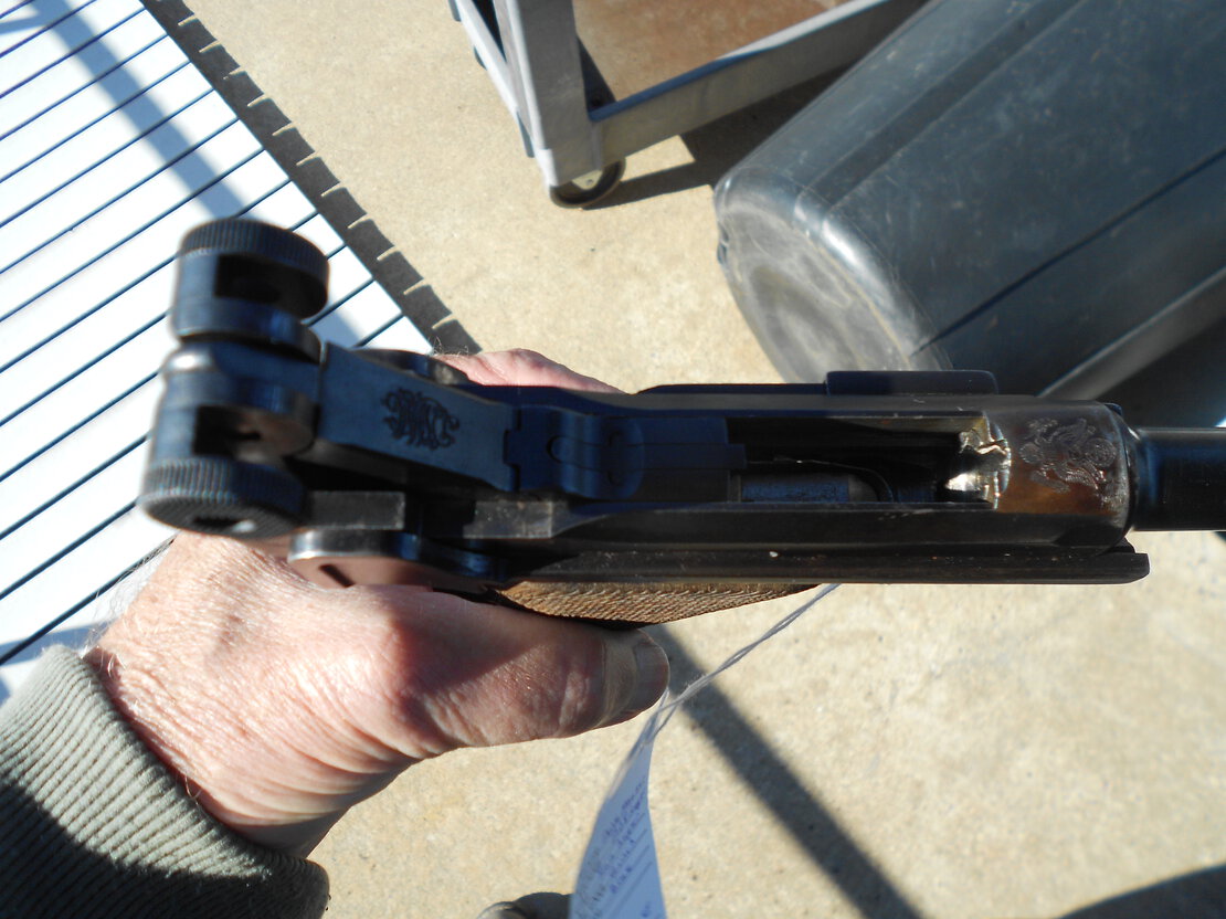

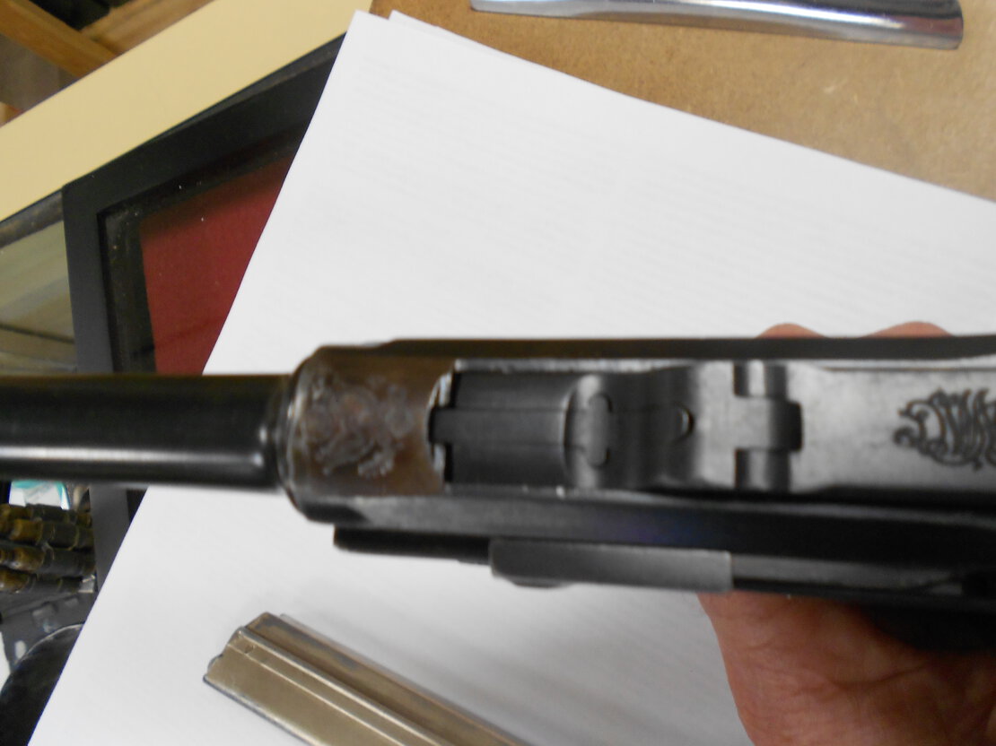

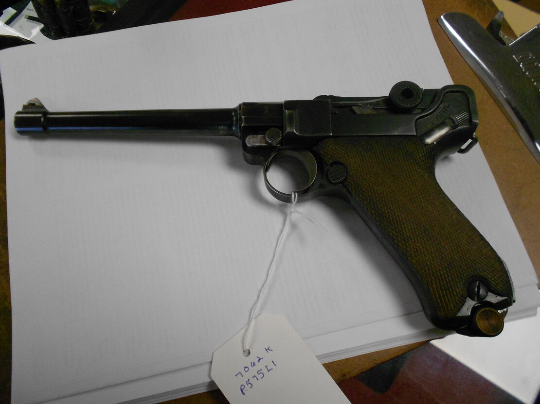

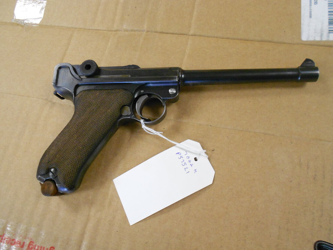

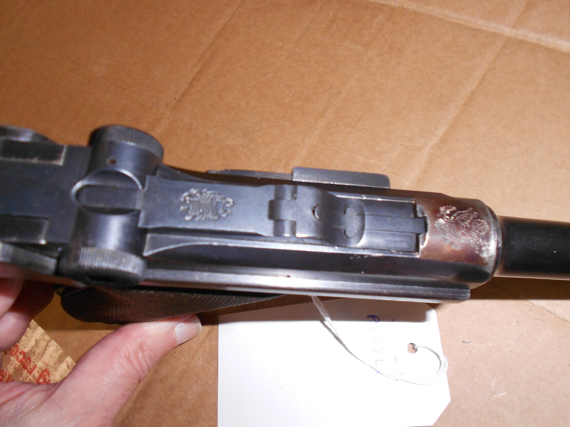

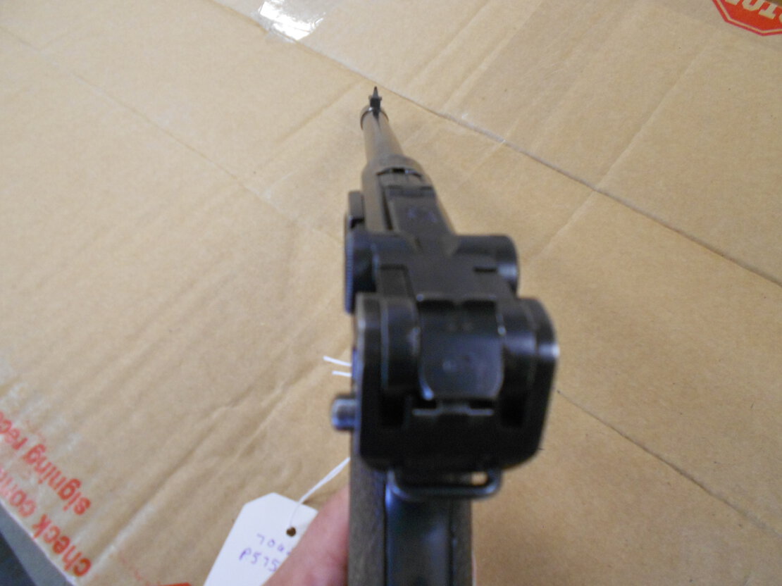

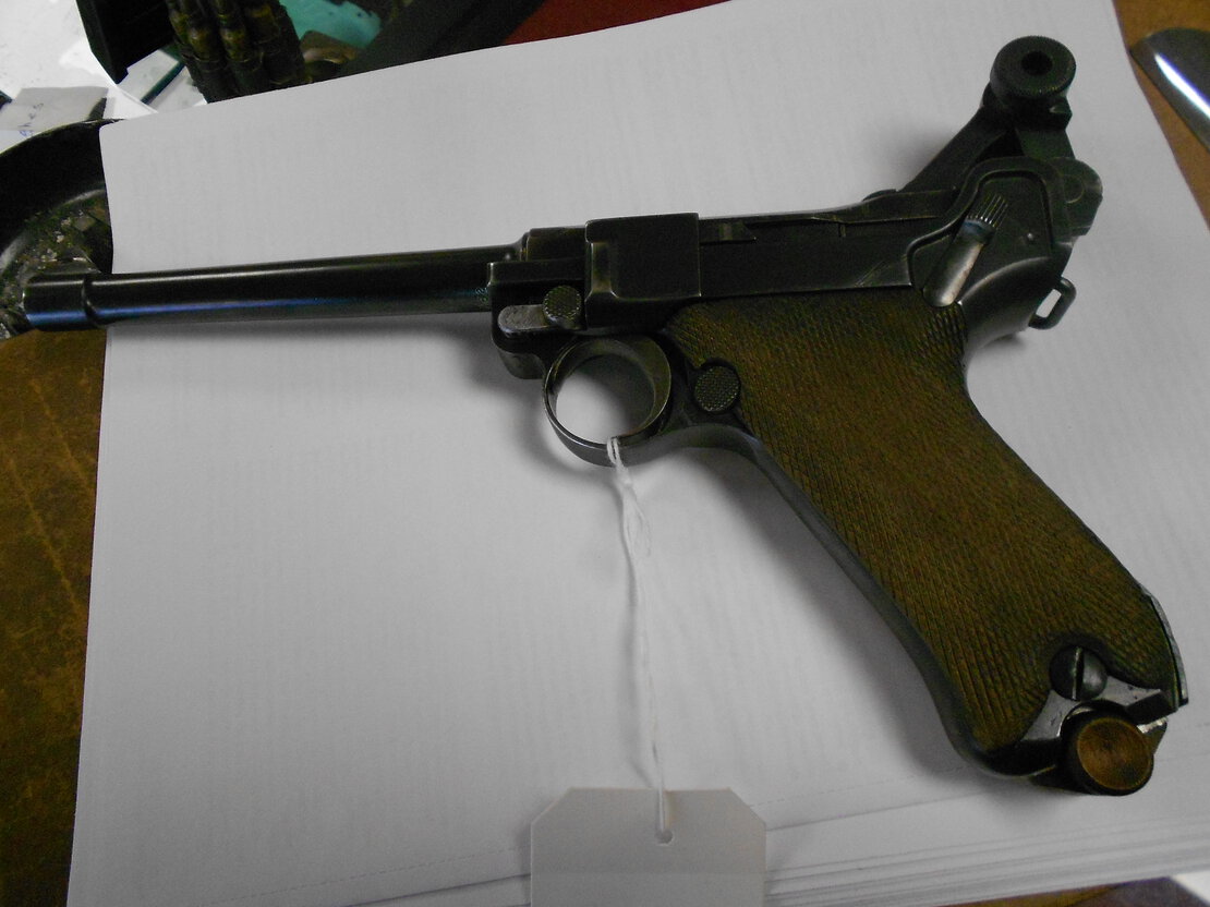

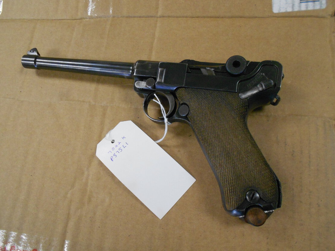

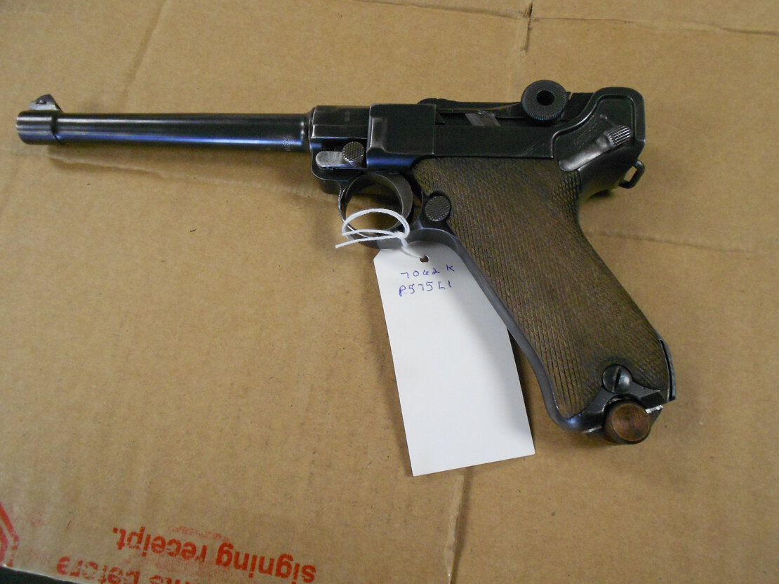

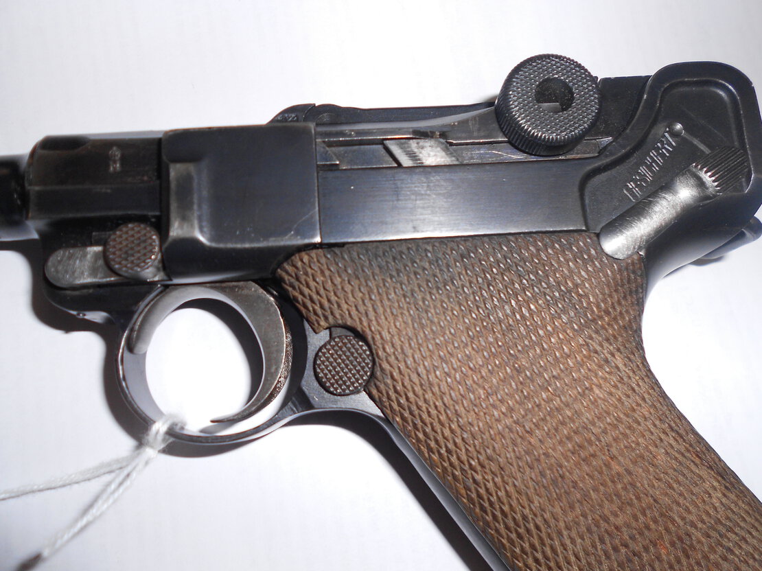

need some help on this american eagle , it is now at a local gun shop and for sale for 1200. seems to be all matching , 9mm s/n 7062 dwm, no import stamps , i know it looks good , but does it all match? and is it all correct , and if correct is this pistol worth the 1200 price or is it worth more or less /ty for your help DSCN0016.jpg

Looks like a 1920's commercial luger to me.
It may not have a lot of numbered parts.
I'd very surprised if it is an AE with no export stamp somewhere.
Sometimes they are on the backside of the frame...
I can't make out any numbered small parts from the photos - a bit dark.
The strawed parts look silver to me. They should be strawed (gold colored).
The GESICHERT looks blued over, so look carefully to see if it's been touched up.
No suffix on the serial number ?
Kinda looks like a 7.65mm barrel, to me.
Price isn't bad, but you should be able to negotiate down for condition.

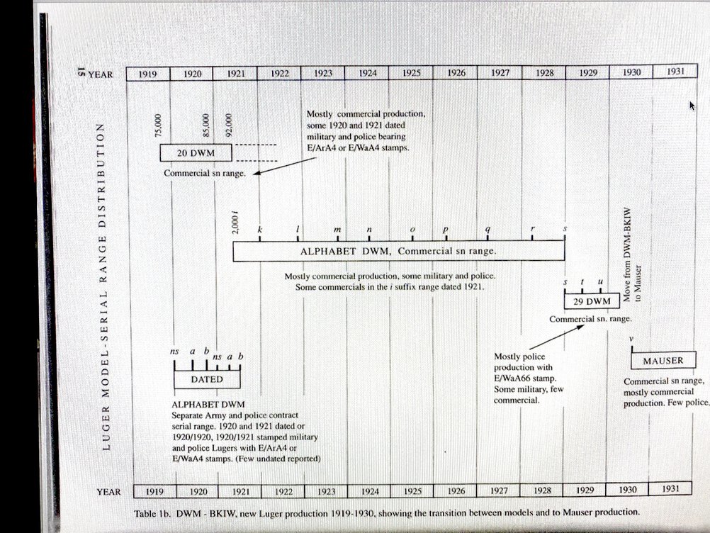

Oh, now I see the "K" on the sales tag after the serial number.
That might help dated it to 1921-22.
That would make it an Alphabet Luger
The table below is from Jan C Still's Weimar Lugers (p. 15).

If the bore is decent then that Luger is easily worth $1200. The parts that should be numbered are the frame, under the barrel, under the side plate, under the locking bolt (take down lever) and the rear of the toggle link. The breechblock may be numbered on the left side but I won't swear to that.
frame is serial numbered s/n 7062 k,bore is vg, under barrel, rear of toggel link , all no 62 , i forgot to check the side plate and take down lever but i will. strawing is good , my pictures are not , ty for the help . checked the side plate an take down lever all have matching numbers , rear of the toggle train , barrel and frame , no where else can i fine any numbers , so i am saying all matching , so far i am not a buyer but we are still talking , ty everyone for your help /

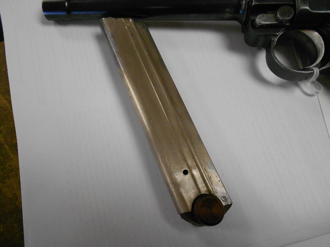

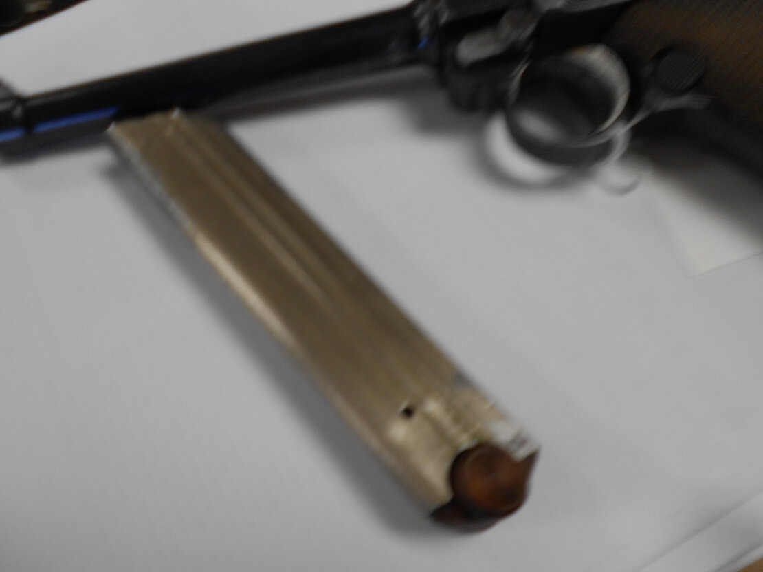

one magazine is numbered other one is not , not numbered to the pistol , but would be corrrect for the pistol i believe DSCN0017.jpg

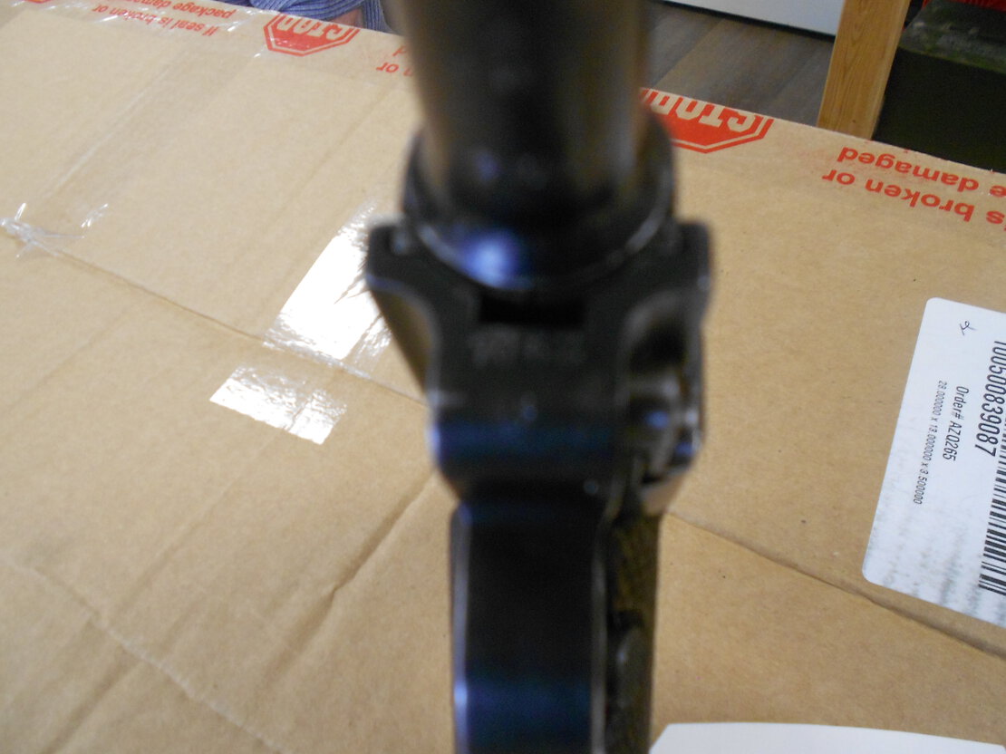

i find it odd that no where is there a import stamp of any kind or made in Germany , unless it was bought in Germany or was brought back , no way to know , what i am getting from those on here 1.200 is a fair price and i thank each of you for your help

I wish I had run across this post earlier. This pistol is a fake. You dodged a bullet by passing on it. There are no authentic American Eagle (only) Lugers in the Alphabet Commercial range.
The only exception to this are the Lugers imported by the A.F. Stoeger company in the '20s and early '30s. They include the AE and a distinctive right receiver retailer inscription. Caution, this inscription itself is commonly faked, and authentic examples go for more than three times the the price of this pistol.

I wish I had run across this post earlier. This pistol is a fake. You dodged a bullet by passing on it. There are no authentic American Eagle (only) Lugers in the Alphabet Commercial range. --Dwight
It is undoubtedly a fake AE pieced together from at least two different pistols and that's a valid point. But, if someone is looking for a reasonably priced 30 caliber shooter, that's not an unreasonable price for one in that condition... assuming that the bore is good.

What Dwight says is true; except for the exceptions he mentions there were no American Eagle Lugers in the alphabet commercial series. The alphabet commercial series began in 1921 with either 1 i or 2000 i depending upon who you believe. Five digit numbers for commercials had reached 92000 approximately and they didn't want to use six digits so 2000 i corresponds with 92000 if the first 10,000 did not have a suffix letter, the second 10,000 used suffix a, the next 10,000 b and so forth.
A close examination would have to be made to determine if the frame has had the original serial number scrubbed and then matched to the barrel and toggle train serial numbers or some other method was used to match the upper assembly - the receiver, barrel and toggle train - to the frame. Without a hands-on examination, how it was done is speculation. What is certain is that the upper and lower did not leave the factory that way.
