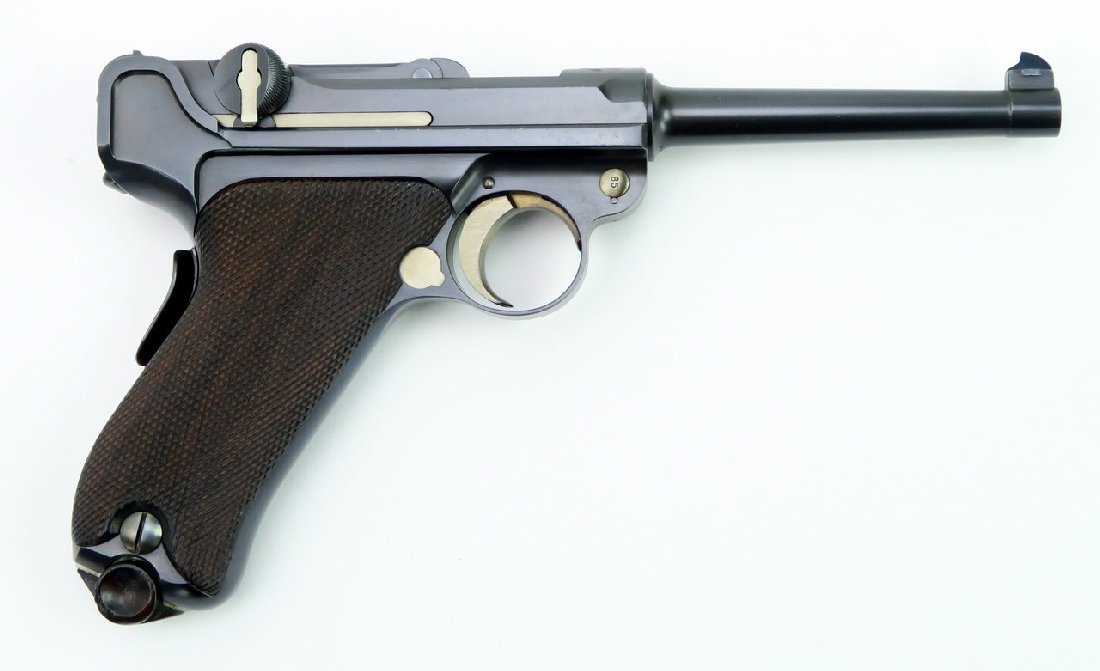

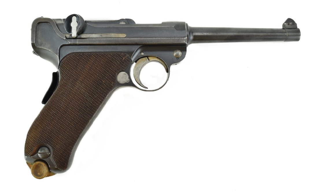

Was the toggle lock originally strawed, like on this 'restored' 1900??? My 1900AE is too patina-ed to tell...
It seems that the other 'unrestored' 1900 has a strawed toggle lock as well...At least, it hasn't 'patina-ed' like the other strawed parts...

The toggle lock on my original 1900 AE is strawed.
I was wondering about the safety block / indicator flag. (The tab that comes up out of the frame and blocks the sear bar from moving.)
On mine and all of the original examples I have seen this part is left in the white.
Both of these guns appear to be strawed in this area. That would make me guess the strawed parts on the pistol listed as "original" have been redone at some point.
Also, this "original" pistol appears to have an incorrect front sight.
Does anyone else have any thoughts on this?

The straw color is developed on the top molecules of the piece. Abrasion from handling and probably discoloration from skin oils or whatever wears away the color on the most exposed portions of the parts. Remember, they're still in the white because they don't have the "pre-rusted" protected qualities of the main finish. It makes perfect sense that the toggle lock retains the most straw color because it is submerged within the toggle knob.
The milled areas for indication of "safe" would certainly be susceptible to oxidation and all but the most carefully oiled and stored can't avoid taking on a touch of oxidation/color. It might be possible to detect in-hand a re-do by the difference between an area that has been polished to restore the raw surface there and one that has not (characteristic tool marks, etc.).

"I was wondering about the safety block / indicator flag."
I always thought the flag was left polished and not strawed, or so it appears.
Unread 04-04-2018, 11:46 AM   #11
Posts: 3,403
Thanks: 7,572
The rust blue in the area was skimmed off by milling with an end cutter just enough to remove the finish. The tiny concentric swirls of its progress are there. Whether it was actually polished afterward at the factory, I can't say, but it would seem unnecessary, and might diminish the sharpness of the borders remaining after the cut.

I seem to have caused some confusion. I was talking about the tab that comes up out of the frame and blocks the sear bar from moving.
I believe this tab should be in the white. It is strawed on both of these examples.
I was not referring to the milled out area under the safety lever that should also be in the white.
Unread 04-04-2018, 02:07 PM   #13
The part of the safety that blocks the sear is always( dangerous to use in regard to lugers) in the white when original, on any model.
I don't include Swiss and Mauser 1970's vintage in this sweeping statement!
Unread 04-04-2018, 10:48 PM   #14
Posts: 3,403
Thanks: 7,572
Originally Posted by milesc2 View Post
Ithacaartist,
OK, got it now. Sorry about what must have been my sloppy reading. Don has you covered, though!
I think mixing the word safety in messed me up. The sear bar block/safety bar would only indicate that the gun is fully on safe for '08 (non-grip safety) models on, right?
Unread 04-04-2018, 11:09 PM   #15
"The sear bar block/safety bar would only indicate that the gun is fully on safe for '08 (non-grip safety) models on, right?"
If I'm getting you right, correct. If the safety bar is down on a P-08, the safety is off and it is ready to fire. If it is down on an earlier gun the safety is off AND the grip safety is compressed, so it too is ready to fire.
