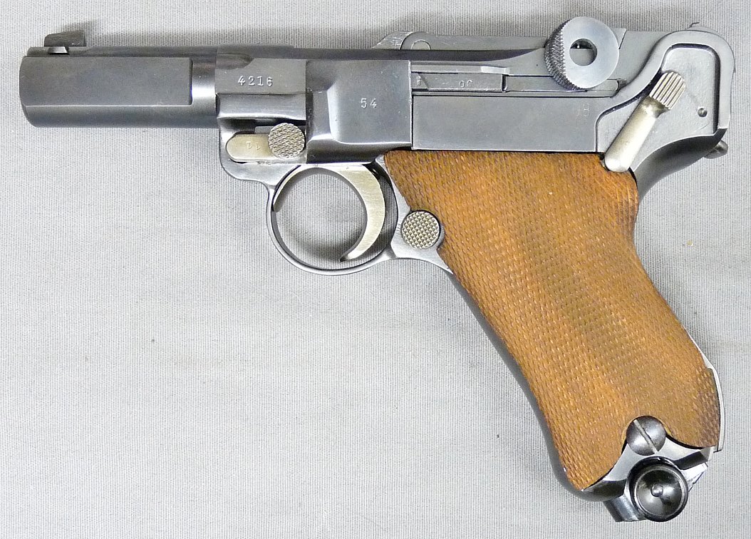

Aw, c'mon...you know what he means...a receiver with a 3" barrel and full toggle train. Something that he can just swap out with the shortened arty upper and put it on the baby frame. He is essentially building a multi-barrel baby Luger kit.

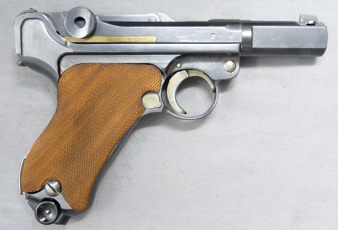

Another 3" barrel? Looks like one in the picture- 9MM or .30?
How about one like this?

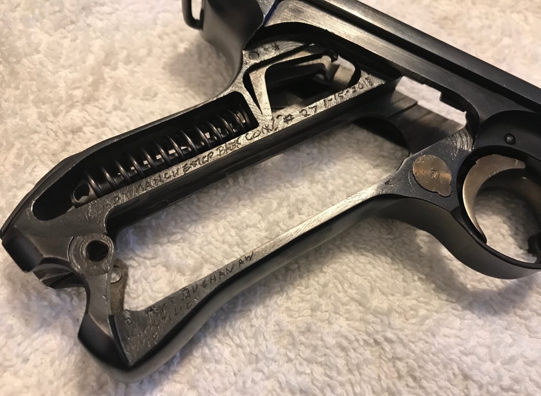

Art cutting a frame.

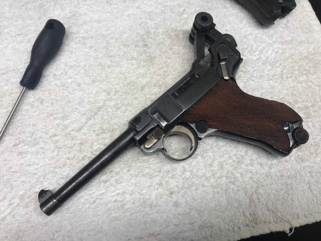

It took a little fitting but I was able to get the 1906 cannon mounted on the baby frame.
Got everything working perfect I think, but it looks like I will need to have two side plates.

Thanks for the pictures of Art making the frame mods! Your 1906 upper looks fine too.
Not unusual to need two side plates to make two different uppers function with the same lower; those pesky tolerances again.
I will be very curious to know if you can get all 3 uppers(the 3" when you make it included) to function with the same main spring.
The shortened frame makes for an exacting job to get the mainspring the correct length and strength. My 3" 7,65mm upper and the bull 9mm will function with the same mainspring; but it took a while and cutting several springs to get the "right" one. It also takes Privi or hand loaded 7,65mm to function- fiocchi just won't work.

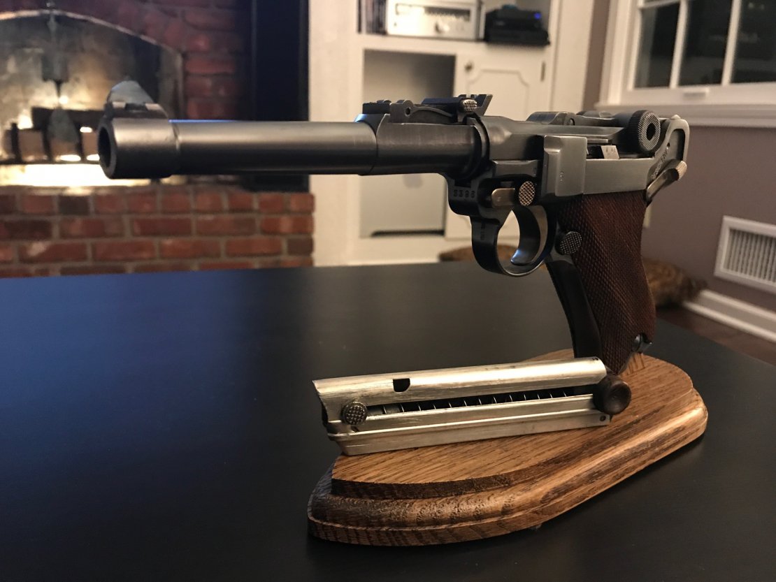

Went to the range today and fired 100 rounds of WWB through the baby.
50 with the artillery top end and 50 through a P08 4 inch cannon.
No issues whatsoever!
I don’t know if this means the 3 inch will work fine, but it’s a good sign I believe.

4 inch barrel mounted.
File Type: jpg CDFB5564-9444-4208-806B-5F2F333CD194.jpg (158.6 KB, 106 views)
