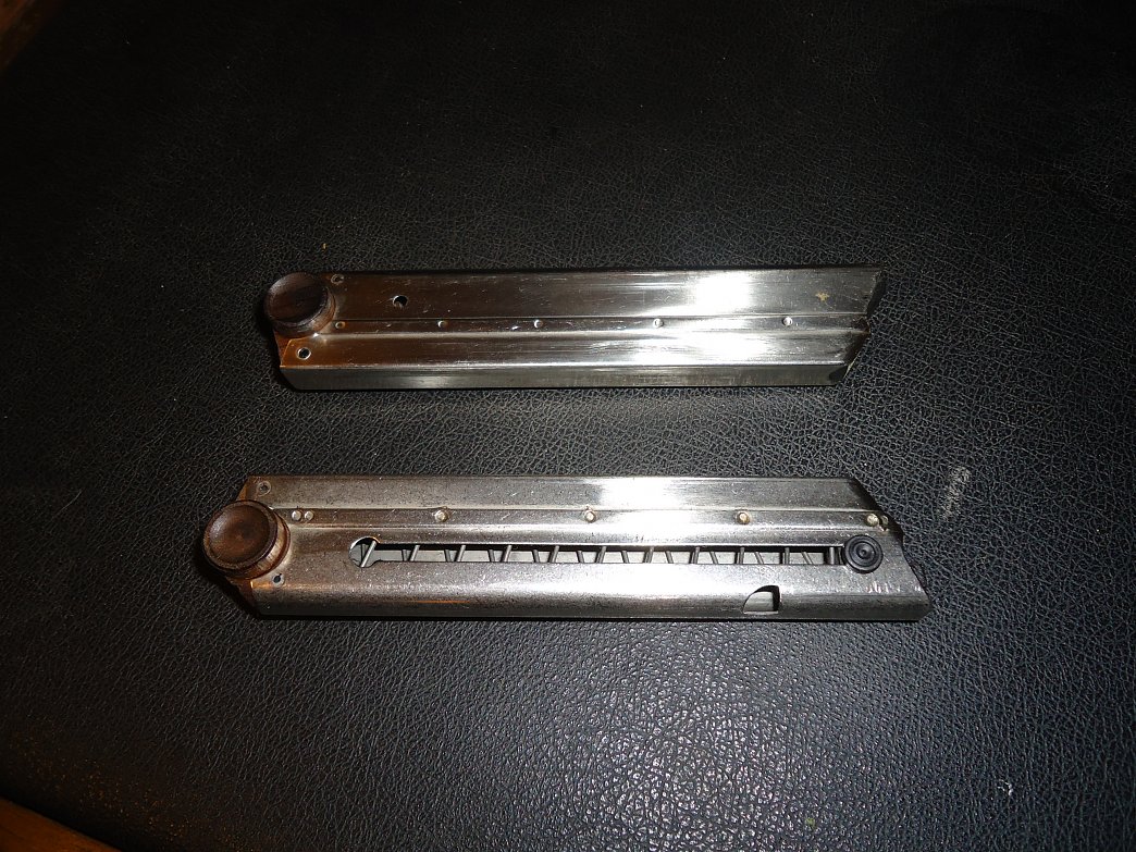

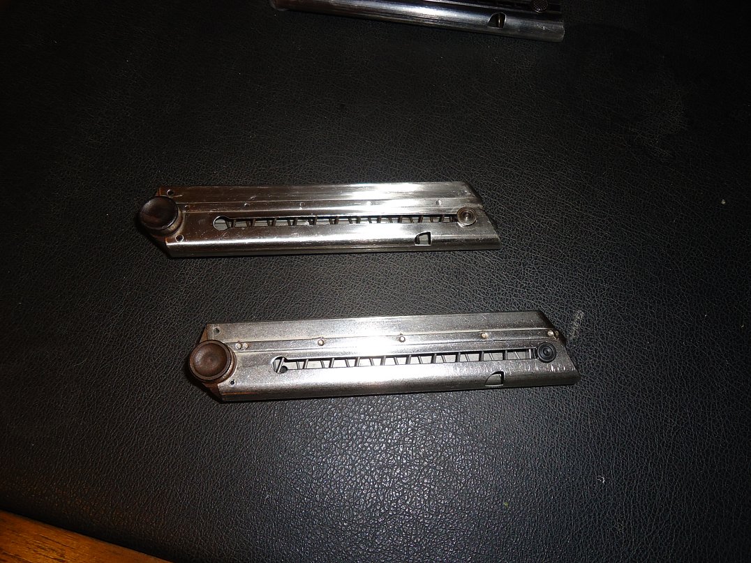

these two ss mags are triple k, they have wooden bottoms as you can see . i have used these in both my dwm;s and erfurt with no problems, if i do trade for the ss american eagle will see how they work in it.

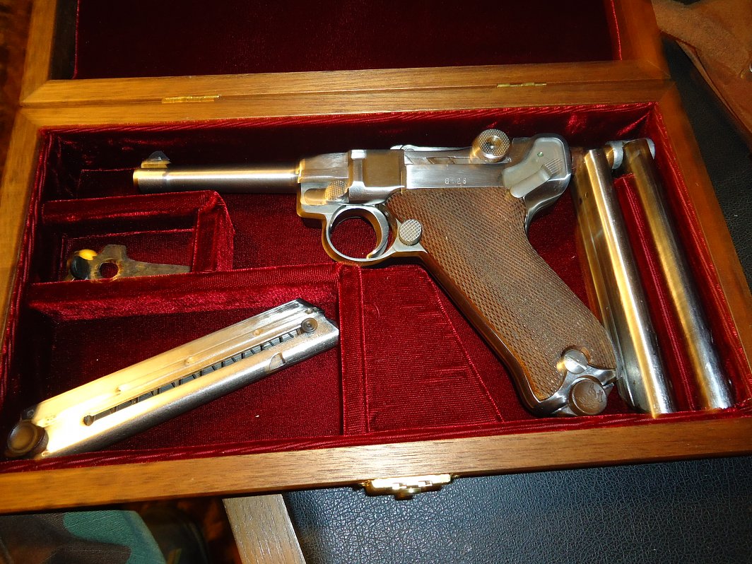

Well here it is . all cleaned up and in a display box, with extra mags . Surprised me how well it shot , but i will discuss that in another thread i will start dedicated to this pistol. what it cost me in trade was a custom ruger .45 lc round butt i built years ago , i never really shot it much but i doubt there was another one like it anywhere, oh well deal is done and both of us are happy, so .

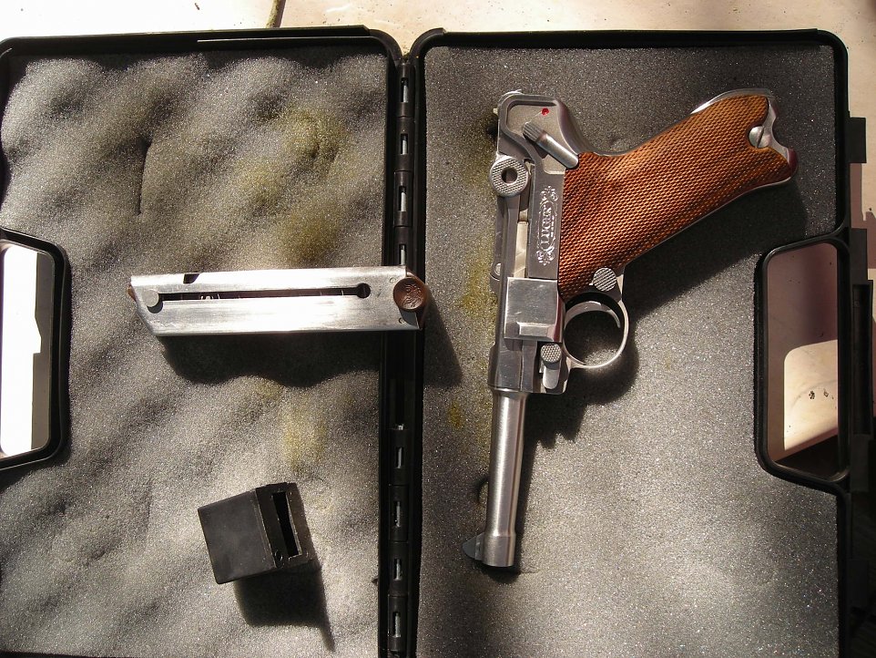

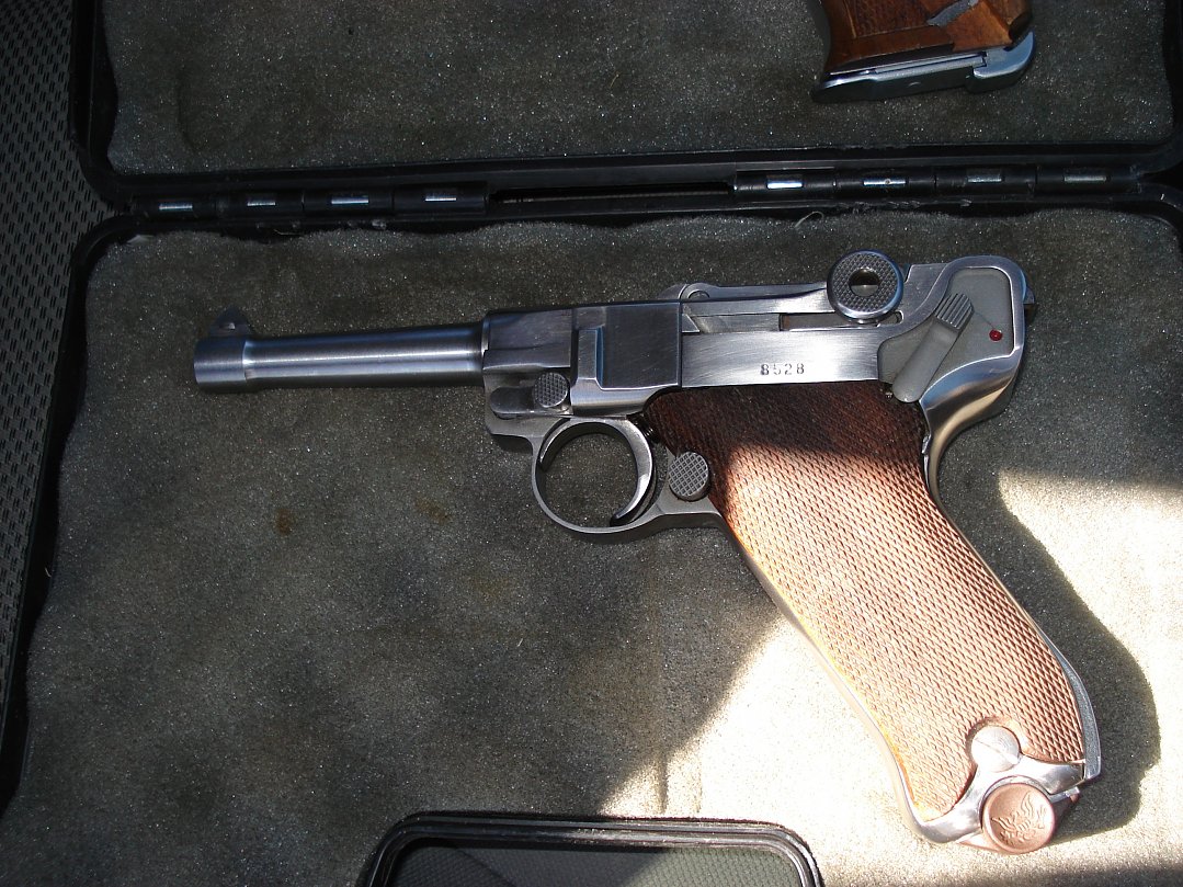

I know it's been a while but here's my Luger. Pics finally! I discovered the problem I was having with the trigger reset was while the pistol was firing the trigger may have been held down too long and not reset prior to the next cartridge loading and being ready to fire. I was able to reproduce the issue while manually cycling it. So, my question would now be if the trigger is held down while the pistol is cycling should that cause the trigger to not reset and fire the next round?
I still haven't purchased another mag yet. Just trying to get the pistol to function correctly in my eyes before putting much more into it.
I sent an email to a Luger repair serivce I found on the web asking if he worked on these and he told me to sell it and get a real Luger! ...hummmm....I'm going back to the range today to give it another try and see if I can replicate the issue when I live fire it.
