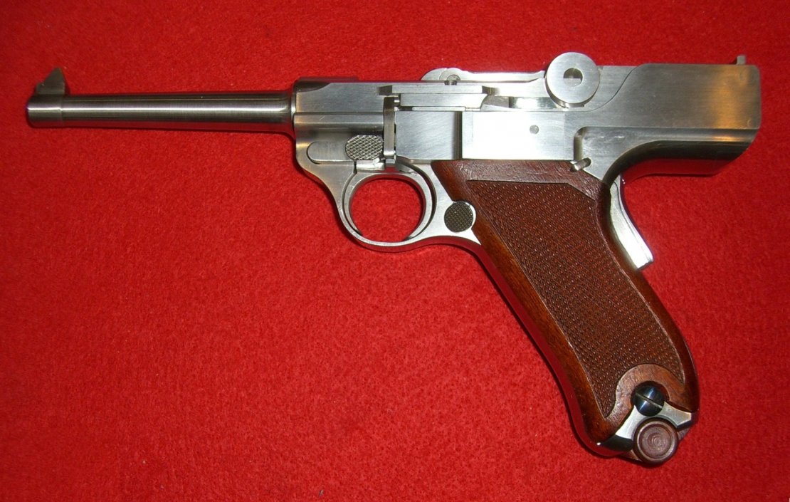

Dwight,
I think that perhaps the guns Greg (4 Scale) is referring to are the ones that Mike Krause has displayed at gun shows that never existed. He created them from scratch from the patent drawings. Here is one example that I photographed at the Las Vegas show.

Unread 01-29-2018, 09:56 PM   #19
Nomadr
Posts: 276
Thanks: 16
Thanked 28 Times in 22 Posts
One thing missing from that display box is the Vaseline bottle slot!
Bob
Unread 01-30-2018, 12:33 AM   #20
4 Scale
Join Date: Nov 2014
Posts: 544
Thanks: 194
Dwight,
I think that perhaps the guns Greg (4 Scale) is referring to are the ones that Mike Krause has displayed at gun shows that never existed...
Yes. Here's a photo of most of the exhibit.
