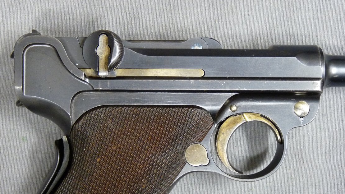

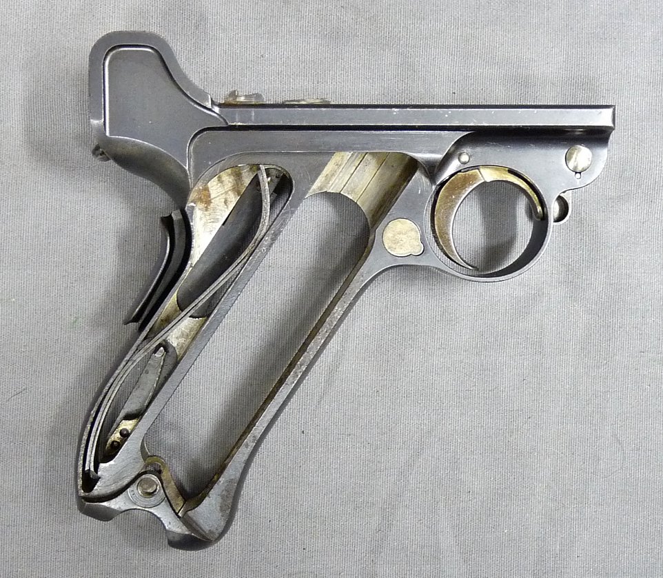

I have a very nice and scarce 1900 variant with a broken latch; I would never consider repairing it- as is often said: "it's part of the history".
