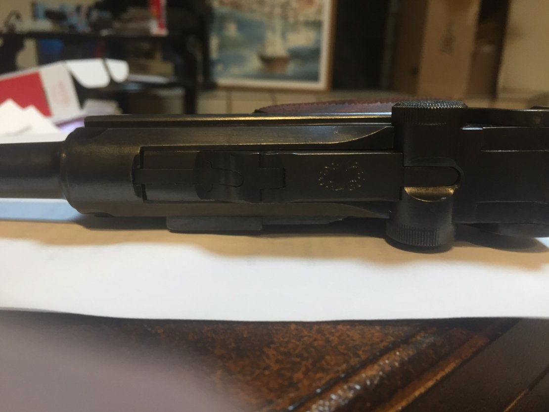

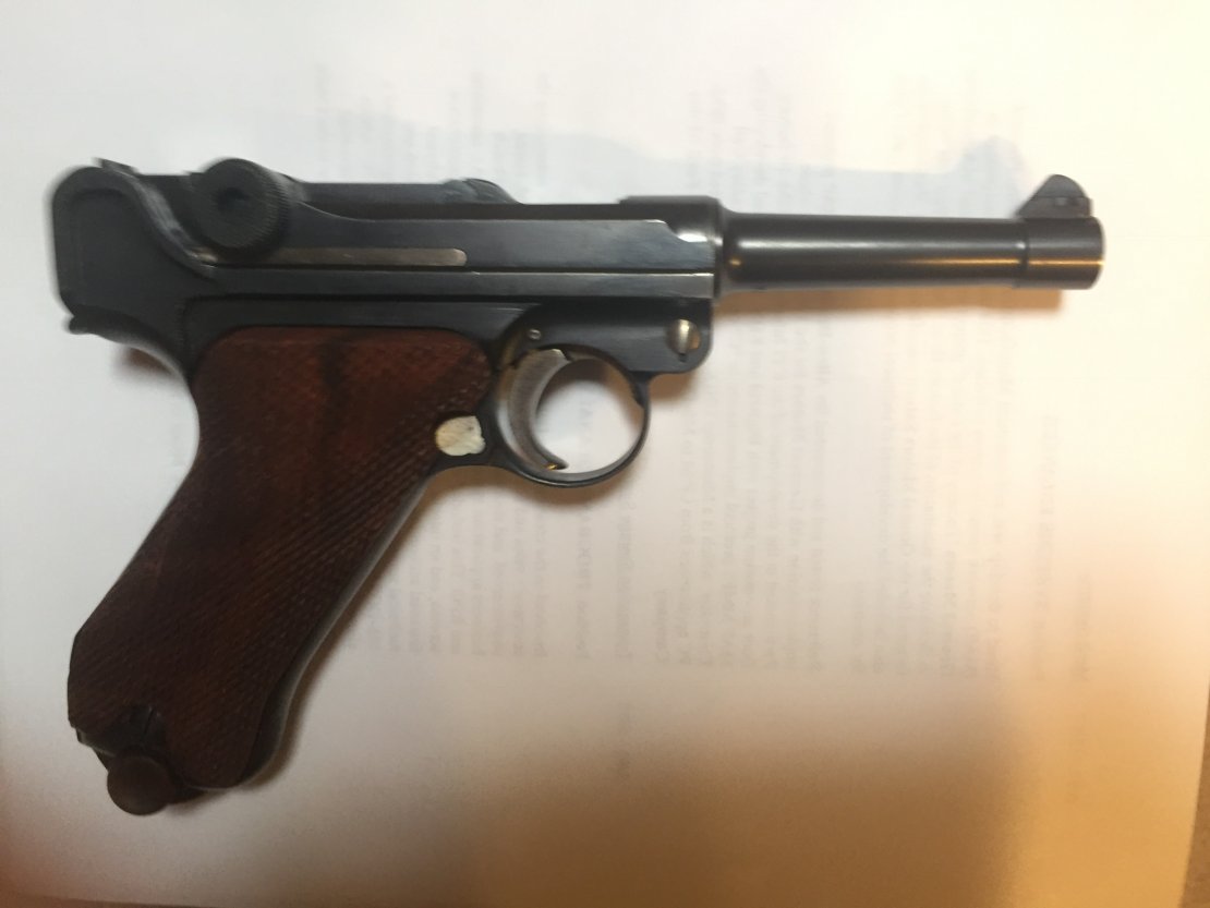

Hello all!
I found this Luger in my gun safe. The previous owner tolld me it is .30 caliber. It had no date stamp, SN 1368h, two c/N proof marks with one on the right side face plate and one beneath the barrel, no military acceptance or other proof marks, "GESCIHER" under the safety lever., all matching except magazine with no SN, and magazine with wooden bottom. I think it is a commercial 1920 model Luger.
The condition is excellent so this makes me think that it has been reblued. However, there are halos around the numbers of the serial number stamp and the "GESCIHER" stamp shows metal within the letters.
I have included some best effort photos. My hands shake too much and the lighting is poor in my living room. If these are not good enough, I will try again.
Thanks!
Bob

Looks like you have a nice 1920 "alphabet" commercial luger in .30 ; as you thought!
An un-numbered magazine is correct.

Yes (given that it's sometimes difficult to determine this in pictures), your Luger looks like it may be refinished to me. "k" block should be in 1922 or 1923.
Take pictures again without using flash, but instead using shaded natural sunlight. The finish appearance may change.
The edges do look sharp in most places, but appear rounded in others in the photos.
Genuine halos on the barrel serial number digits would indicate original finish in that area. Closeup properly exposed sharp pictures would help verify.
Areas like the frame rails should be in the white. Take a look inside. Also the recoil spring link and the lock pin on the toggle main axle.

"Yes (given that it's sometimes difficult to determine this in pictures), your Luger looks like it may be refinished to me. "k" block should be in 1922 or 1923.
What do you mean the "k" block? The SN ends in "h".
"The edges do look sharp in most places, but appear rounded in others in the photos. "
Yes I have noticed this. I paid allot of money from a reputable firearms dealer that I have known for years. He had personally owned this one. I think he may have made a mistake!
"Areas like the frame rails should be in the white. Take a look inside. Also the recoil spring link and the lock pin on the toggle main axle. "
What is the recoil spring link? The lock pin? I understand these questions are something I should understand. Sorry.
Here is what I found so far. The inside of the rails have been blued. Also there is a pin into the top of the pistol which the toggle rotates around. The side of this pin has been blued. The one in the back of the pistol which the toggle also pivots around is blued. This does not look goid at all.

Perhaps the most telling picture of those posted is that of the muzzle, it should be polished - in the white. Hard to say for sure without seeing it, but yes it may have been re-finished or partially refinished.
There is considerable wear to the blue on the side plate, but the grips straps look "new".
If you are not happy with it, I'd return it; especially if you paid more than $1000 or so.

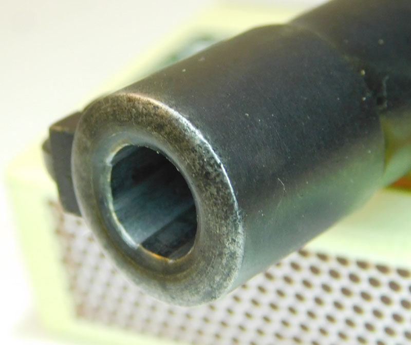

JMHO.
Huh?
I can asure you that my 1921 (i series) is in original state and it has a blued muzzle. Why would they blue the barrel and then polish the muzzle?

The commercials were sold out of Germany to generate desperately needed currency after WWI so i doubt that your gun was redone at Mauser during WWII where salt bluing took of.
Why,
because that is just what "they" did.
Perhaps the same reason that the inside of the frame was protected during the rust bluing process?
I don't take pictures of the muzzle of my lugers when documenting them, but a quick look in Still's Weimar Lugers shows several pictures with the muzzle clearly showing polished.
The ones that are not polished are "re-worked" and usually have the 1920 PS added.
Others can weigh in on their observations.
Feel free to post pictures of your 1921 or add a link so we can see it- better yet start a new thread about your question.

I've refinished a lot of guns and the OP's looks like original finish to me. Perhaps with the lighting the aged muzzle appears blued.
I have a five digit commercial that is in almost the same condition as the OP's.

Why,
Sorry mate!
You are right and i am wrong.
The aged appearence played a trick on my old eyes and polished looked like worn black.
But polished it is when i googled it under proper light.
Here are 2 pieces of humble pie:

Originally Posted by Chickenthief View Post
Sorry mate!
Thanks for checking; and the report.
Metal left in the white can and often does darken with age; sometimes to the point of looking black-but it is usually thin and mottled.
