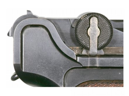

Here's how it works...That paddle-shaped piece in the middle of the toggle knob has a hook at the bottom. That square-looking part on the frame rail also has a hook. They engage each other, preventing the toggle from being lifted UNLESS you pull the toggle train straight back about 3/16" BEFORE lifting. If you try to yank it up like on a P08, it will break one or the other hooks.

Rich (or Ron!), what's up with the pic of a toggle lock on the New Model toggles that are checkered, not dished? If the flat mainspring's common failure to keep the toggle down is the reason for having a toggle lock, wouldn't the pistol in the pic have a coil spring, and consequently not need one?
I screen-grabbed the first pic I came to; it was labeled as a 'transition model'. I was just too lazy to get up off the couch and open the safe, put a battery in my camera, find a backdrop, take a pic, transfer it to my PC, crop the pic, resize it, upload it, and then add my comment...
In the time it took me to write that last paragraph, I had already posted it.
Just because it has checkered toggles doesn't necessarily mean it also has a coil spring. My 1904 Navy has a long frame, flat spring, toggle lock (see my avatar) as well as checkered toggles.
