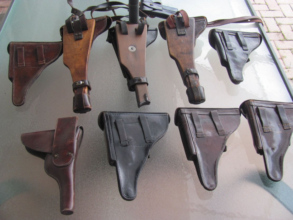

We have spent the last three days cleaning and oiling the Lugers, and are now faced with 2 or 3 large boxes of the holsters. What is the current recommendation on preservatives and maintenance, please? Back in 2009 or so, some good folks from this forum came out and appraised the leather for us. There's a scary amount of value sitting there when we totaled it all up. How can I keep them alive? East Texas climate, they're in AC, but it gets very humid here.

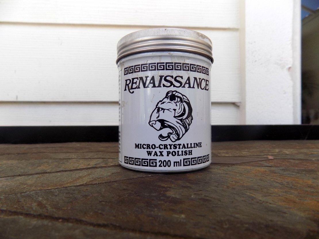

Simple, Renaissance micro-crystalline wax polish, Amazon has it https://www.amazon.com/s/ref=nb_sb_s...d=N57FEMVGUBKX

I use Connolys for my leather, if you want to clean them, use saddle soap, then connolys
don't use pecards, its too thick and greasy, don't use mink oil etc, it breaks down the leather

Anna, Well I thought you said you were from the deep South? What you call snarky I call humorous. It makes my point. Simple can be as wrong as right. I love Eric like a Brother but I don't think the simple answer to leather preservation in humid Texas is as simple as Renaissance Wax.
Don above has some good advice..Back in 2009 or so was the last time you closely inspected this leather and it has not changed in 8 years you are doing something right. Storage condition, moisture, light and temperature is always the first defense. If your leather has not molded in all this time then conditions are ideal. You might want to take a strong light and look inside each one for ANY signs of white spots or abnormal growth of fuzz.
If nothing like this exists..just keep doing what your doing.

Ed is correct..Almost every holster that comes and goes through the shop I treat the flexible parts with lanolin. Hinge, top of the belt loops, closure strap..things like that. Also any dry areas..but inspection often and storage are where you start.
Jerry likes lanolin, ergo "I" like it too.
Bought an 8oz tub on ebay, pure lanolin- lots of offers in various sizes. About as "natrual" as one can get!

Handsome collection of leather holsters !
