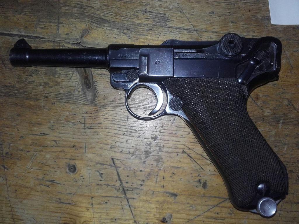

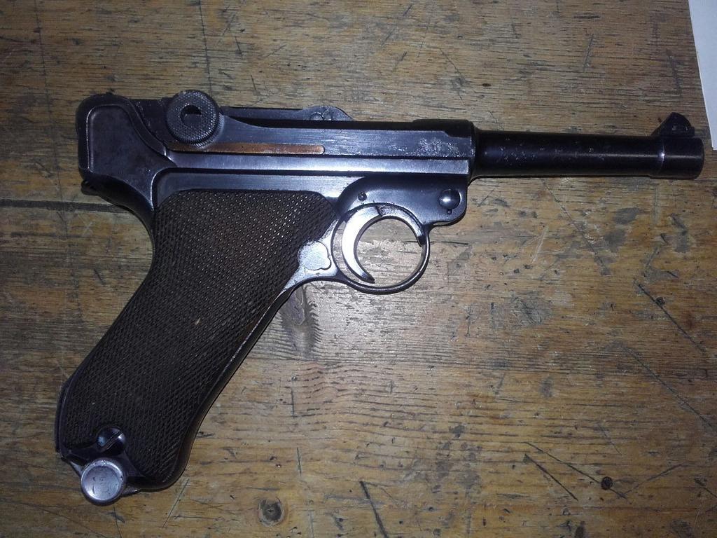

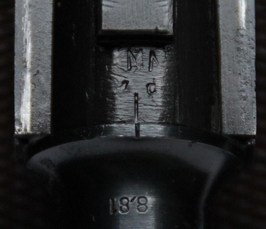

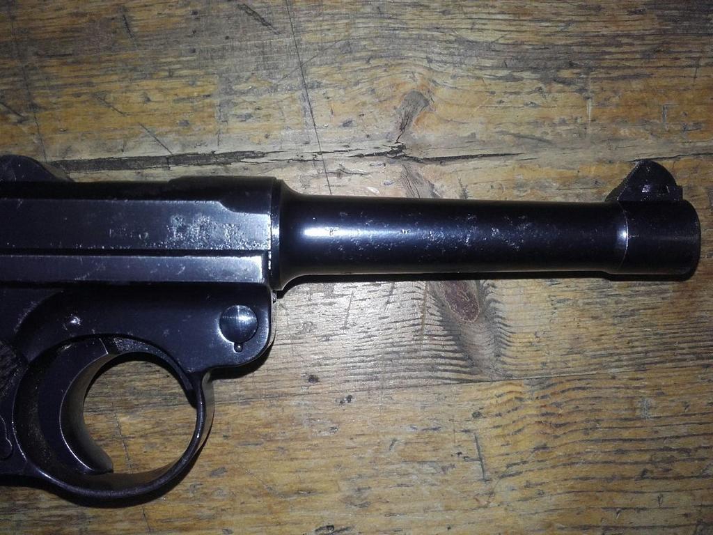

Hi fellow collectors,
I hope my english is not as bad as it sounds to me. I tried to read as many topics as possible to get things right, hopefully careful enough.
The Model I was presented to buy was offered by somebody who has literally no idea of what he has to sell, so all informations about it are rare at best...
I asked him for some pictures that match your requirements. Since the gun is not mine it is difficult to get the pictures made perfectly. Sorry for that.

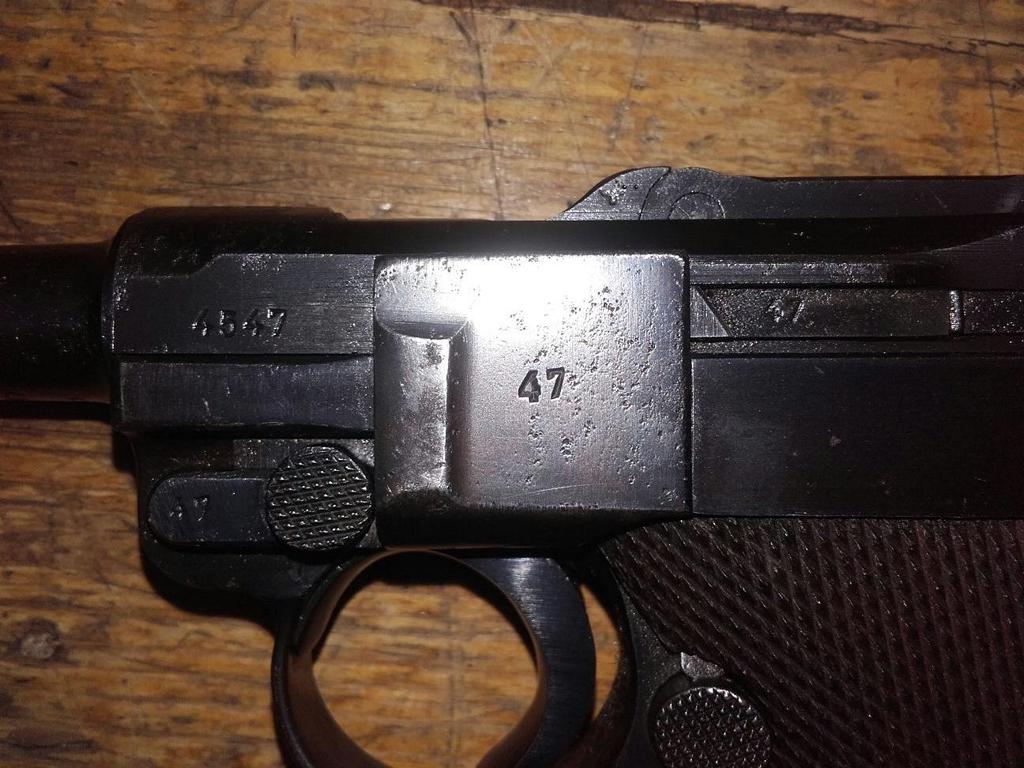

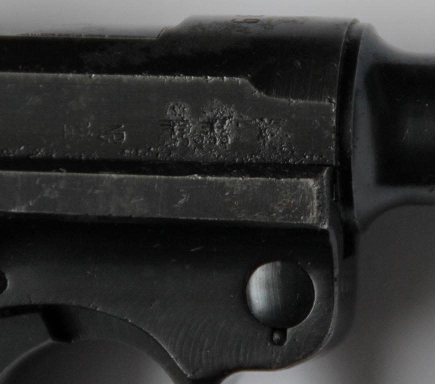

Serial Number 4547 on frame
"Eagle" and "NPv" Marking on frame (couldn´t find anythig about those Markings)
"42" on front toggle link (Luger Company Code?)

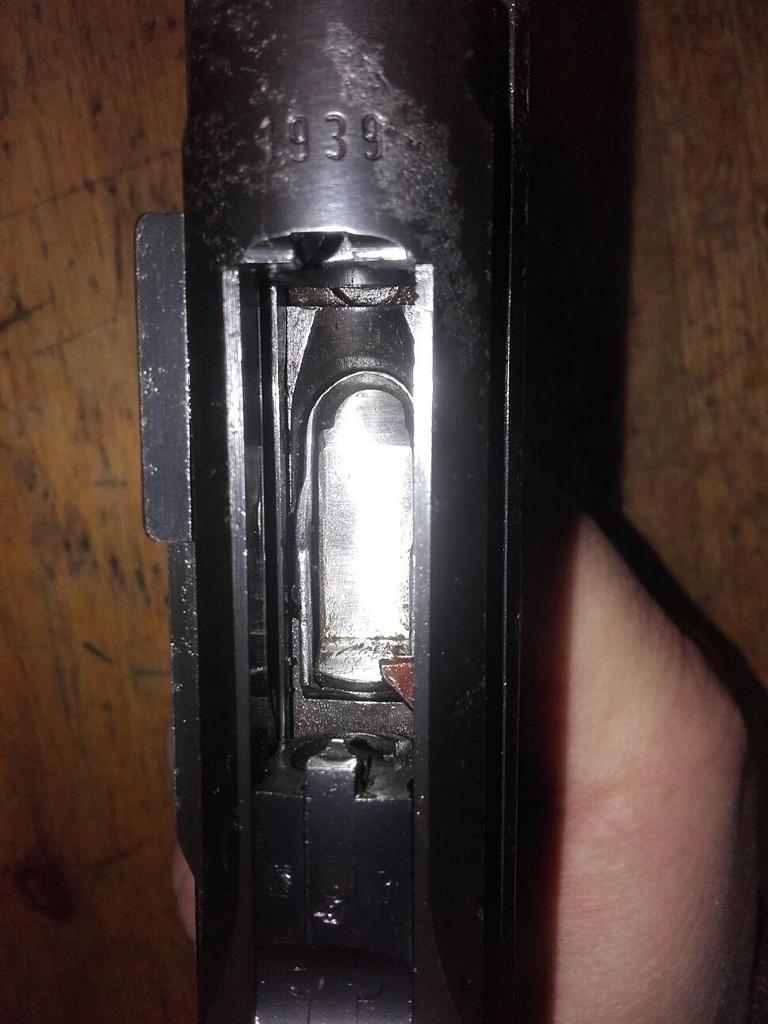

"1939" on frame (Year of Production?)
Markings seem to be there but hard to identify for me.
Numbers are mathing except Magazine.
I would appreciate if anyone can tell me something about this item and maybe knows what it may be worth.
Thanks a lot, I hope I did this posting right.

Welcome to the forum. Others are more knowledgeable about these WWII-era Lugers than I so I will not clutter the thread with possibly erroneous information. However, I do want to congratulate you on your excellent English. I wish my German was half as good.

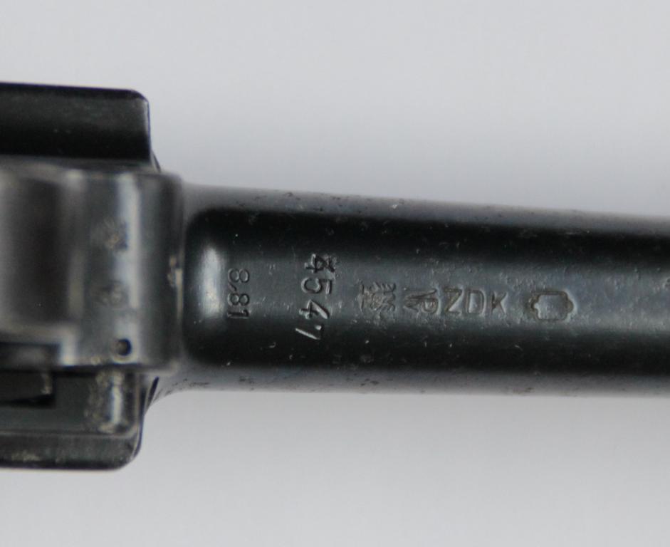

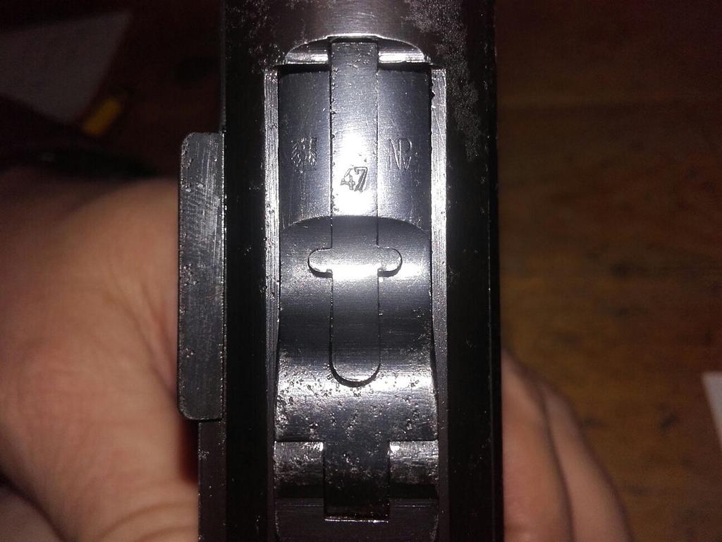

Michael, the Eagle and NPv markings on the breech block are Austrian proofs from the Vienna proof house.
Unread 02-11-2017, 03:51 PM   #4
And the pistol was made by Mauser.
Unread 02-11-2017, 06:04 PM   #5
Thanks: 2,750
It has been refinished, but I can't tell if it was dipped, or cold blue.....perhaps something else. Fair amount of corrosion and rust pitting on the outside.....hard to say what the insides look like. To me, it would definitely be a "shooter grade" Luger, and not a collector piece.

Thanks a lot for your replys, and for the hints as well! Yesterday I was searching again for the markings and found something on our govermental internet site. Maybe you know that actually but if not it may be interesting for you.
George is right about the proof sign (never doubted that!!) Does that mean it has been marked in Austria after 1945? If so, it is not 100% original and of decreased value...
So if its a shooter grade, how much should I pay? Ideas anyone?

Unread 02-12-2017, 07:35 AM   #7
The Austrian proofs are after 1945. It may have seen use by the Austrian police in the years following the war.

Your Luger was made in 1939 by Mauser in Oberndorf. The "42" is Mauser's concealment code during that early part of the war.
The serial number will also include a suffix letter which appears on the frame above the trigger guard in the front.
It's very hard to judge finish in flash photographs. It does give the impression of a poor pitted finish that may have been refinished. In the USA the value would be $800 or so if it is fully functional. Your prices may vary quite a bit. I think it's overpriced.

If I were looking at this gun, I would use it as a shooter and / or a parts gun. The photos show a lot of pitting, as others have mentioned. I myself would not pay more than EU500. This assumes that the gun is fully and safely functional without your having to put time, effort and more money into it.
You say the gun "was offered by somebody who has literally no idea of what he has to sell," Seems the seller has a pretty good idea, seeing that his price is a bit high, as you and others have concluded. If you're not sure, or if you have doubts, then WAIT.

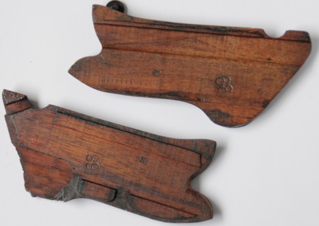

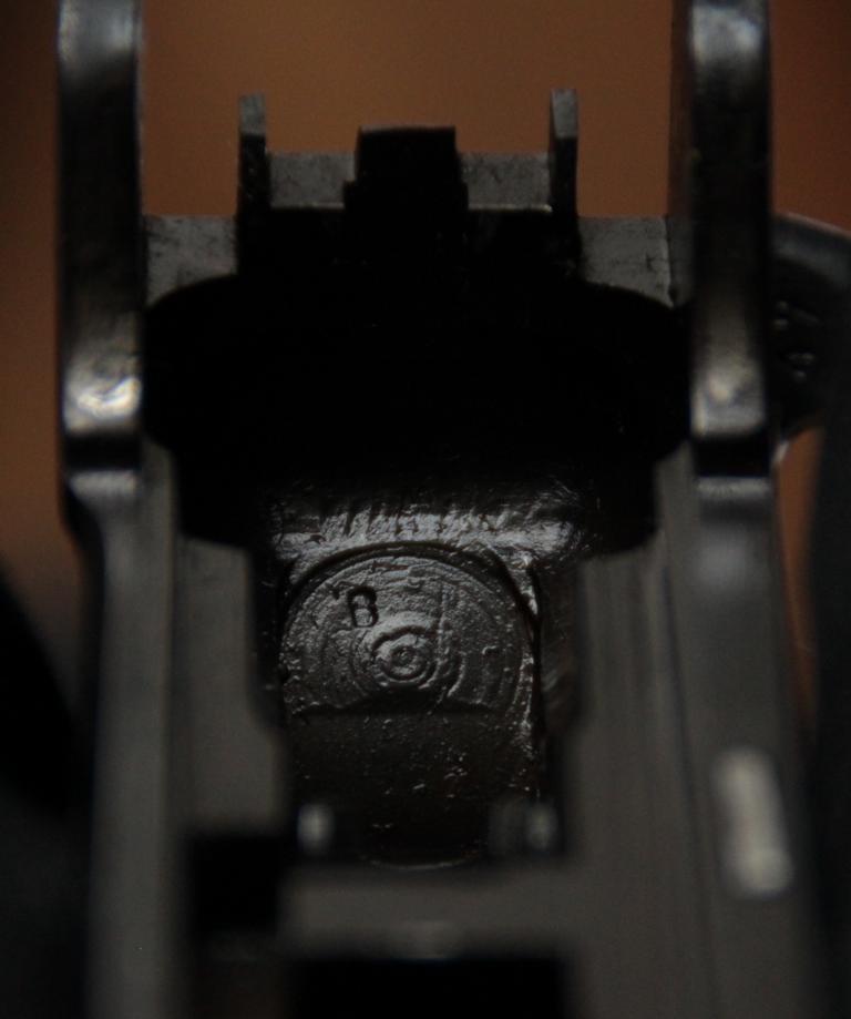

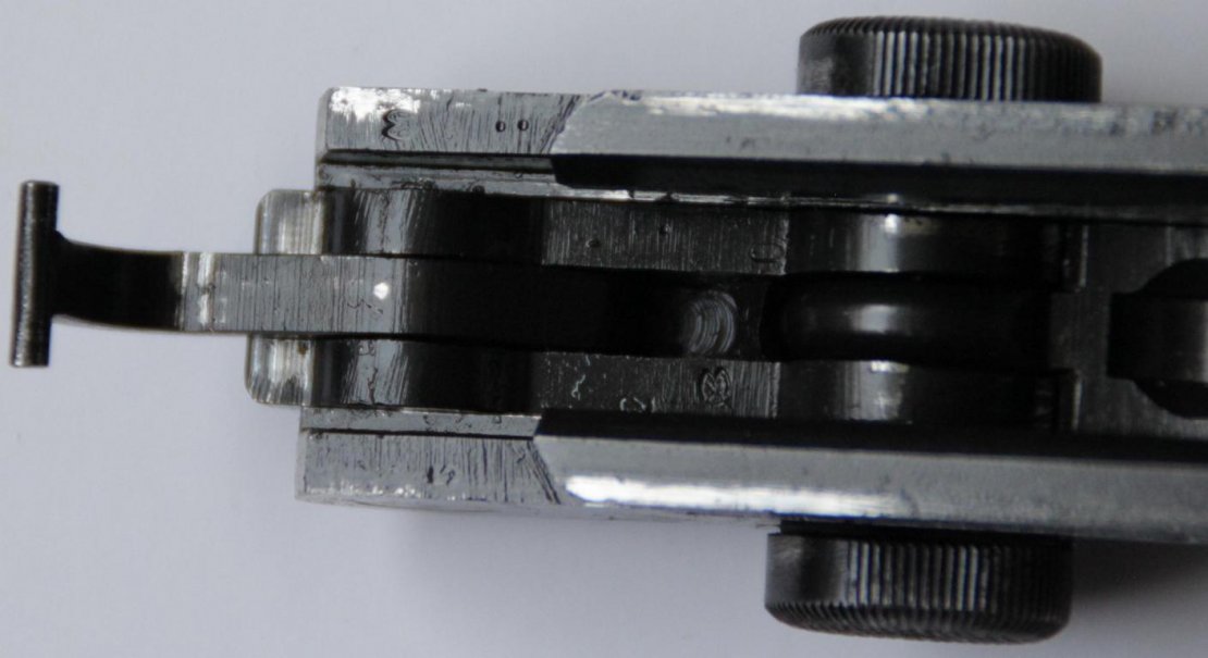

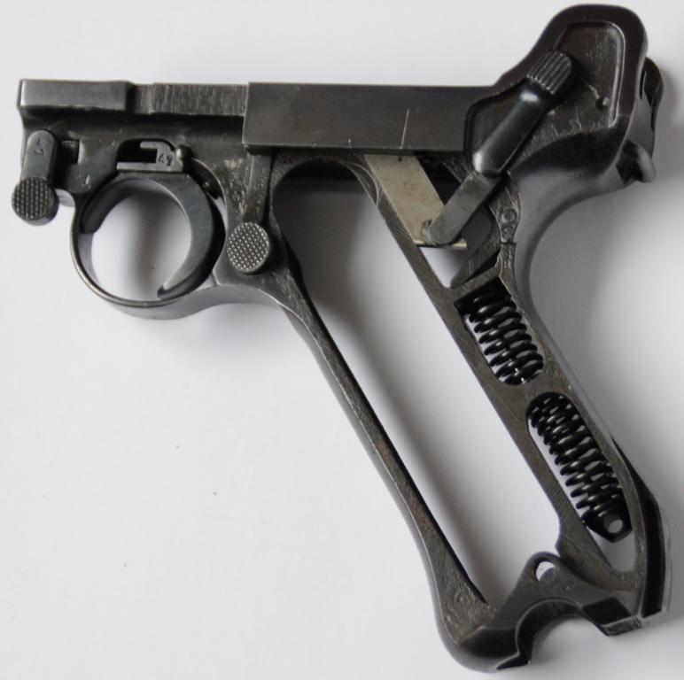

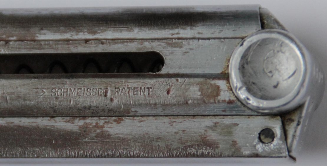

Mahlzeit, Guys!
As promised, I want to send you some more Pics. Some of the Markings are identified by now, like the Viennese NPv Markings. But I´d be glad if someone could tell me more about some of the other. Especially those on the inside. I read some Posts about the drilling marks and production marks, which I can see on this gun too (and it makes me feel like really getting into this ).
Hope the pics are good enough since I still have to buy good Optics for my Canon and build this Photobox These pics were made on a quite cloudy day ... you know ... diffusing the light...
Cheers Michi

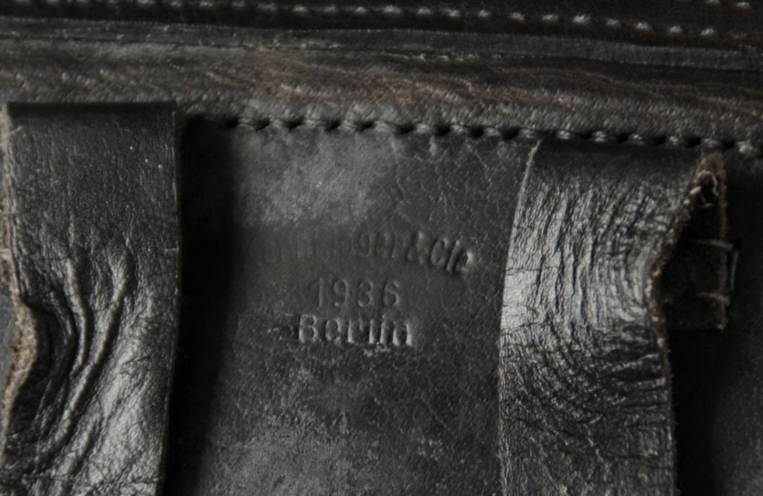

Ah, one oh the pics is the Holster that came with it, so... don´t know if its custom made or really old stuff. The pitting seems really bad compared with some of your collectors pieces, but I decided to go the "it´s all history, you know - 1939 and still working, even survived police service" way here.
