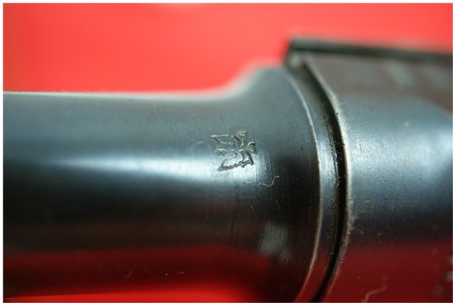

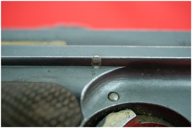

Wouldn't the numbers on the barrel have halos on this year also does the barrel witness mark look a little off

I believe that no halos on a 1912 Erfurt is correct, at least the ones I've examined haven't had them.
The exact purpose of the witness mark is somewhat controversial, my belief is that it indicates any clockwise rotation of the barrel caused by repeated firing, the small shift shown in the photo is pretty typical of a gun that has seen a lot of use.
As to the price, this Erfurt has an interesting and desirable unit mark and, in my opinion the price is not out of line so far.

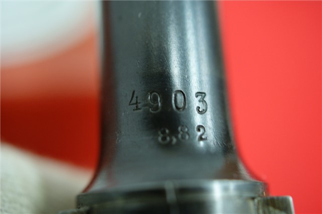

I know I am not a Luger expert, but wouldn't the absence of halo's indicate that the stamps in question were made after leaving the factory, or in any case, not using the original factory procedures? Presence of halo's would indicate compression of the metal at the edges of the stamp at the instant of high impact stamping? On the other hand, there seems to be no evidence of grinding down or refinishing from these photos posted. Looks like a nice gun!!

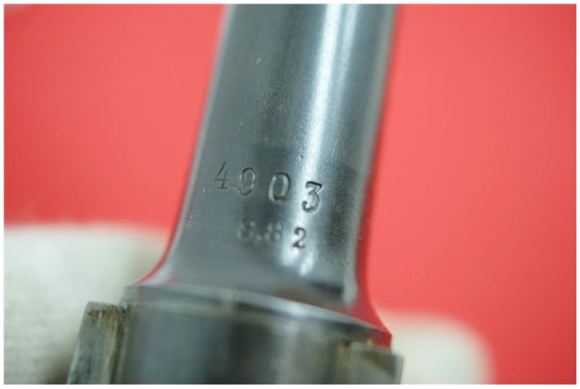

Would it matter? The unit marking shows that it visited an armory at least once; having the barrel replaced and with stamps consistent with such a visit would seem to be an indication of an 'official' upgrade...
The land diameter is rather rare too..."8,82"...If it was not 'real', it would likely have the more common '8,83' I would think...
It also has a nice screaming chicken on the barrel...That all makes this moron think it is genuine Erfurt, even if a replacement...

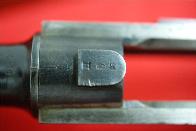

There is a visable pin installed on the right side with an Erfurt proof. This was retrofitted after the pistol was made.

The retaining pin shows from the outside...
...But if you delve deep enough into the 141 pics, there are several closeups of the hold-open...
