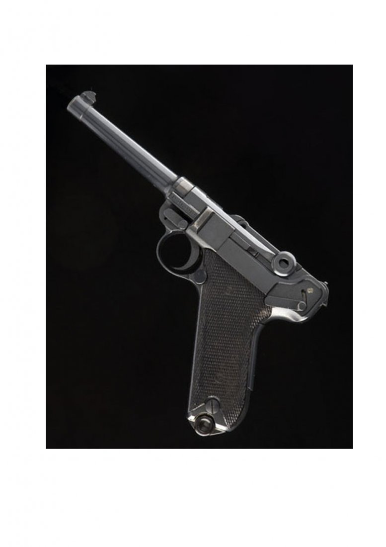

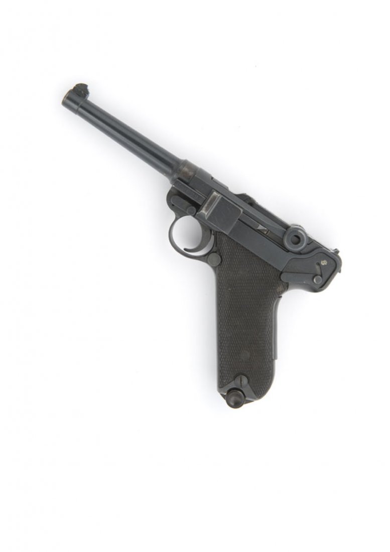

Hi,
Came across this Swiss Luger on a UK auction site.
There's only two pics in the auction catalogue and I've pasted the auction description verbatim below.
Hope its of interest.
Auction description:
A RARE 9mm (PARA) 'LUGER' SEMI-AUTOMATIC PISTOL, MODEL 'SWISS 06/29 COMMERCIAL', serial no. P26292,
circa 1943, with 4 3/4in. sighted barrel, toggle with Swiss cross mark, grip safety, chequered plastic grips with 'F & W' logo, no provision for shoulder stock, all matching numbers and original magazine with bakelite base, the whole retaining much original finish throughout
Provenance: Records state that only 100 Swiss 06/29 pistols (including one prototype) were produced in 1943 from commercial parts already on hand (denoted by the 'P' prefix to the serial number) and by converting existing military pistols. More recent studies have suggested that far less than 100 were actually manufactured, and that some were subsequently re-converted back to their original calibre of 7.65mm (Para). Furthermore, for a while only two official conversions were acknowledged to exist, serial numbers P26291 and P26300, subsequently however a small number have come to light including the example offered here.

Swiss 9mm lugers are an interesting, and difficult bunch. By the time that the Bern arsenal was done bumming around and finally got a working prototype that produced acceptable results accuracy wise, the army already had decided to go with the P210 design instead.
Tinkering with the opening curve, using wrong steel types and generally thinking they were smarter than the Germans meant that the Swiss 9mm was an utter failure.
Swiss gun engineering knowledge is often overrated, as are most of their products

If authentic, is is a relatively rare Luger. Unfortunately it is easily faked. I saw two of them on the same table at a Tulsa show one year. Chances of that being for real is probably astronomical.

I have never been a fan of the lug-less, non-grip-knob Lugers...but the grip safety here looks odd...The pistol seems to be on "Fire", but the grip safety is depressed...
Is the grip safety independent of the thumb safety (free to swing in or out), or is it pinned to the thumb safety mechanism (so that it would follow the thumb safety linkage)???
Probably an easily fixed broken safety lever spring. At £1,264.38, the gun is cheap enough even as a fantasy piece. I am skeptical about claims that Swiss Lugers cannot be made to work with 9mm barrels.
On W+F 1906/29 pistols, putting the safety lever on "S" merely prevents the grip safety from being depressed.
Usually the safety lever spring is not broken (but as Michael said, it is easily replaced if it is). About 90+% of the time, the grip safety is not properly assembled to engage the spring.
