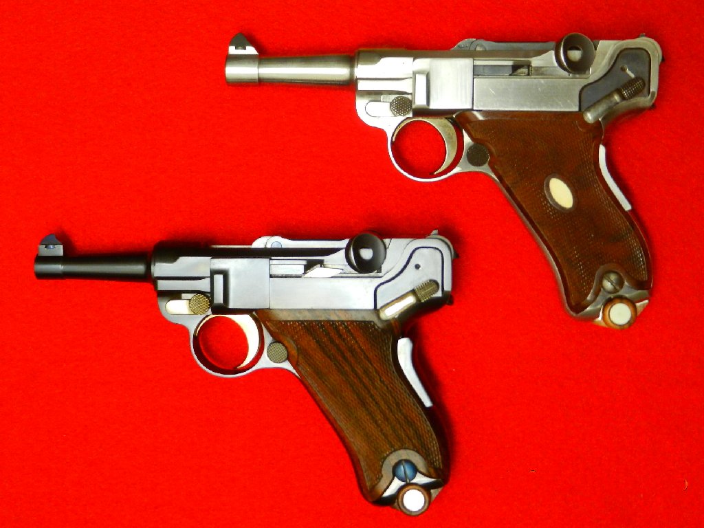

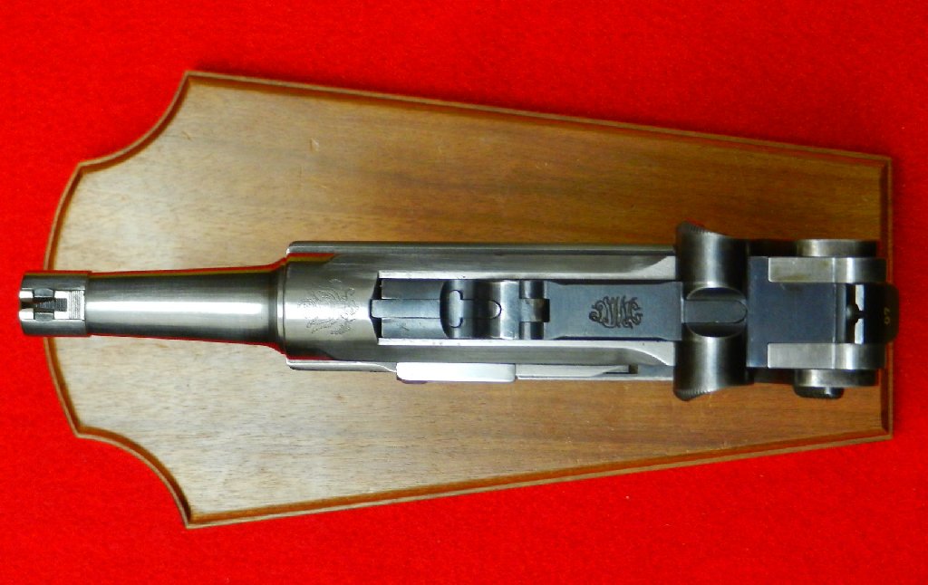

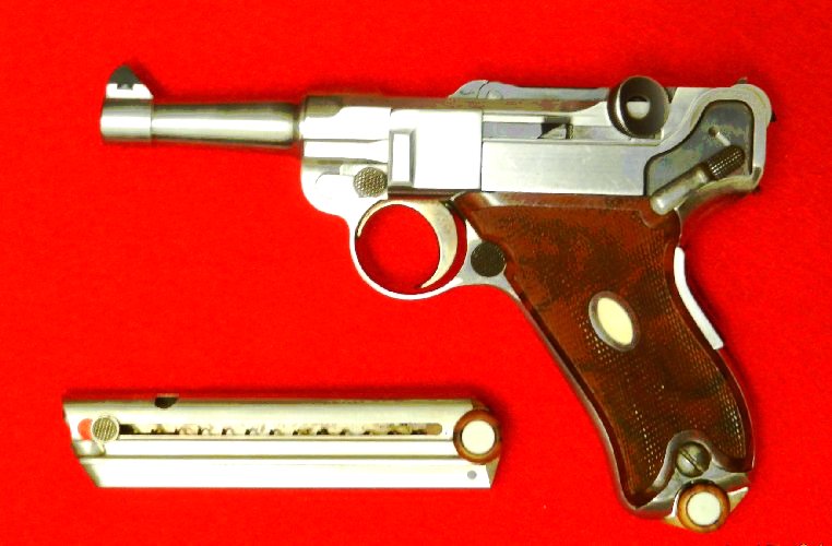

For this project, “progress” is kind of a relative term. Back in 1971 as I was passing though from one Army assignment to another, I bought a box of Luger parts from Ron Peterson in Albuquerque, NM. It contained a fairly complete 1900 American Eagle Luger that someone had screwed what was probably a Lahti barrel into the receiver, it pretty much messed up the receiver threads. There were some other miscellaneous small parts in the box, but it was the genesis of a project. As many of you know, I have been a Luger nut since the late 1950s. In the books by Datig, Jones and Kenyon I absorbed a lot about the history and multitude of variations of the Luger in the early years. I was particularly drawn to the few prototype 7-shot “baby” Lugers that were hand fabricated at the factory from production Luger parts, most of them under the direct supervision of Georg Luger. Since there was no way I would ever own an original, I decided that making my own would be a good use of that box of parts.
And so, it began. I performed the frame modifications myself, shortening up the grip frame and converting the mainspring setup from a leaf to a coil using the frame web and bell crank from a scrap new model Luger frame that was also in the box. I also used a new model breechblock, modifying the receiver to accept the improved extractor and reshaped the cocking lug on the 1900 forward toggle link to work with the new model firing pin configuration (more on that later). After I finished making the frame, a good friend and master stock maker Richard Counts fabricated a fantastic fine checkered and inlayed set of figured walnut grips to fit the shortened grip frame. A few years passed and while I was visiting Gerald Tomek (G.T.) I asked him if he would make a couple of figured walnut magazine bottoms with ivory inlays to go with the grips. He turned out a super pair. After another couple of years, I acquired a pair of mint Swiss magazines (made by Pfänninger with the script “P” on the spine). I asked G.T. to cut down the mags and fit the bases he had made earlier. As expected, he knocked out a pair of beauties. Now it was time to move the project along a little further. I was concerned about the durability of modification I had made to the forward toggle link, so I had G.T. swap it out for a mint new model link that Mike Morris had given to me at a Tulsa show some time in the dim past. Then came the big move…while he had the gun for the aforementioned work, I asked G.T. if he would fabricate a 3-inch 9mm barrel for the gun. Not one to shy away from a challenge, G.T. accepted the chore and after a lot of labor and fine tuning he got ‘er done. A thing of beauty and it performs wonderfully…G.T. launched 4 test rounds down range with the receiver/toggle train/barrel without a hitch.
On a side note, I always wanted a John Martz customized Luger, and 3 or 4years ago I won at auction one of his 7-shot Baby models modified exactly as my project gun, a 1900 cut down and converted from leaf to coil mainspring! His is 7.65mm vs. my 9mm, and I think mine looks better (naturally I would ).
So now I have to replace the missing frame latch for the toggle lock (I got a nifty replacement from Tom Heller) which involves fitting and silver soldering. The real bear will be tuning the coil mainspring to operate properly. Don’t have a firing range in my back yard, so that is going to be back and forth trips to the local range until I get it right (or close enough!). Then off to Ted Green (Thor) for his final rust blue finish if he will consider doing the job.
It has been a real saga and hopefully I will complete the remainder of the work in a fraction of the time already expended! It has been a gratifying labor of love, involving a lot of very good supportive friends in the process. I will be happy and hopefully it remains in the family to be passed down as something Grandad did.

Ron, what did you do about the "messed up" receiver threads? Are you getting an RW engraved on the back of that frame?
It is a beauty
The following 3 members says Thank You to Heinz for your post:
Unread 12-20-2020, 06:33 PM   #7
Heinz,
G.T. cleaned up the threads when he installed the new barrel. I haven't decided what, if anything, I am going to do about "personalizing" the gun.
Unread 12-20-2020, 07:57 PM   #8
Heinz,
