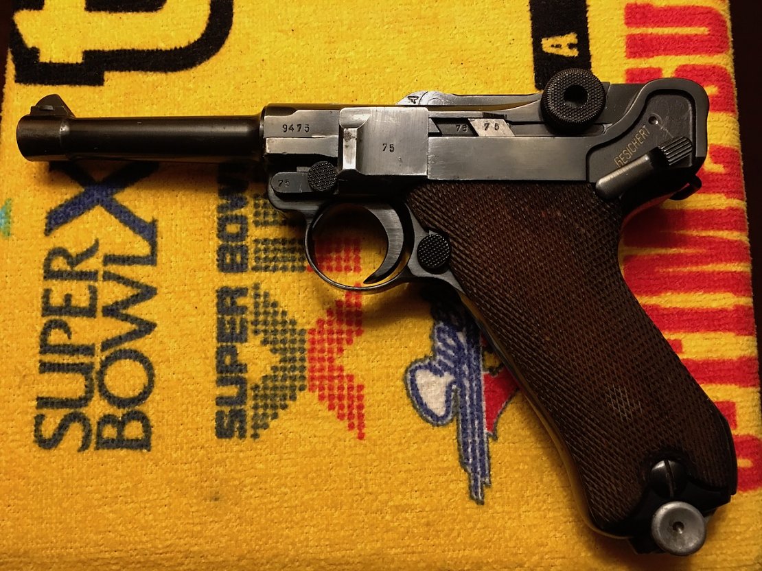

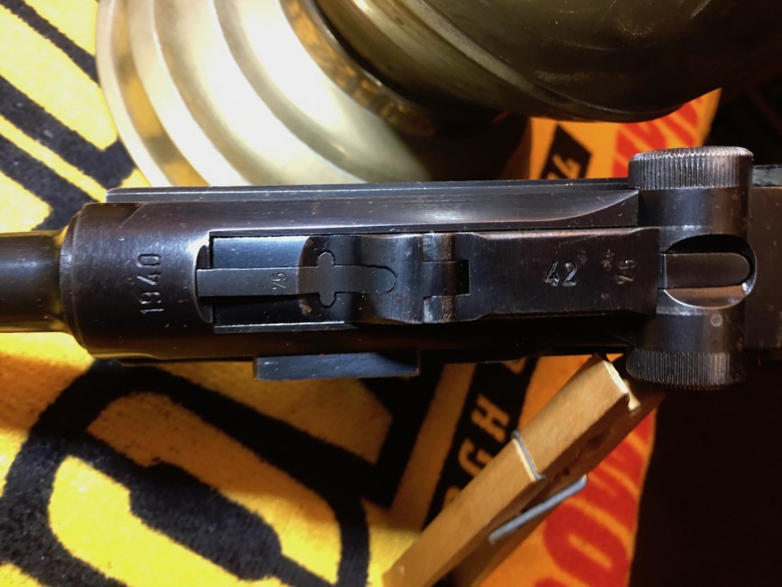

I just bought this Code 42 Mauser version. All serial numbers match including the 1 magazine that came with it. It had a holster from 1936 but the serial number does not match the Luger inside. I confirmed all the data on this Luger with the Standard Catalog of Luger but I came up with one issue. The book states that the 1940 Lugers were from serial number 7700z to 7000n. My luger is 9475l (lower case L). The closest match I found in the catalog was lookup index number 174.
This Luger is not perfect but it is the best I have personally seen. I traded the 1914 Military Model Luger I had for this one. Major upgrade for me.

I don't have any questions. I just wanted to confirm what I found and if anybody has more info that would be OK. I did find one mistake in the Luger Catalog, at the beginning of the lookup index number 174 it status that the toggle will show a number 42 that identifies that Mauser built this luger. At the end of the index it showed S/42 as the toggle mark.
This Luger will go well with the other WWII handguns I have. A P38, a model 640(b), and a Pistole 626(b).

Stephen,
A nice well used example of Mauser 1940 production.
During all of 1940, Mauser's production code was 42 and the toggle is properly marked.
While there are some examples in the y and z blocks, the first complete block of pistols, i.e. 10,000 guns is found in the NS, i.e. no suffix block. The last complete block was the m-block with a few pistols found in the n-block... Your l-block pistol was manufactured in the October time frame, maybe a tad later. About 137,000 P.08s were produced by Mauser in 1940.
The pistol probably left the factory with a Haenel manufactured type 3 extruded (machined) magazine with a zig zag spring and a code 122 stamped on the body.
On the right side of the receiver, you will see two Eagle655 inspection marks and a final acceptance proof. Eagle 655's name was Gerbig.
Enjoy your acquisition.
John

Thanx guns3545. The magazine and proof marks just like you described. The holster that came with the gun was from 1936. It has a WaffenAmp 234 stamp. The manufacture stamp says FR&K VOEGELS KOLN-DEUTZ 1936. I just purchased a reproduction Luger Tool to complete the set until I can get a more authentic one.
