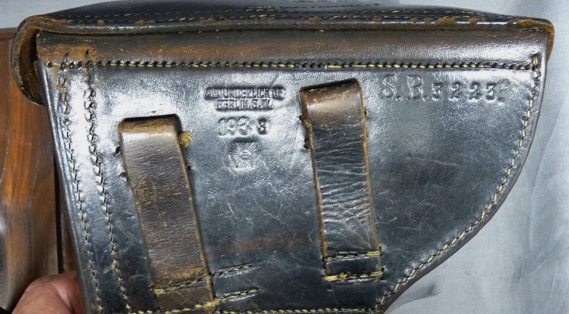

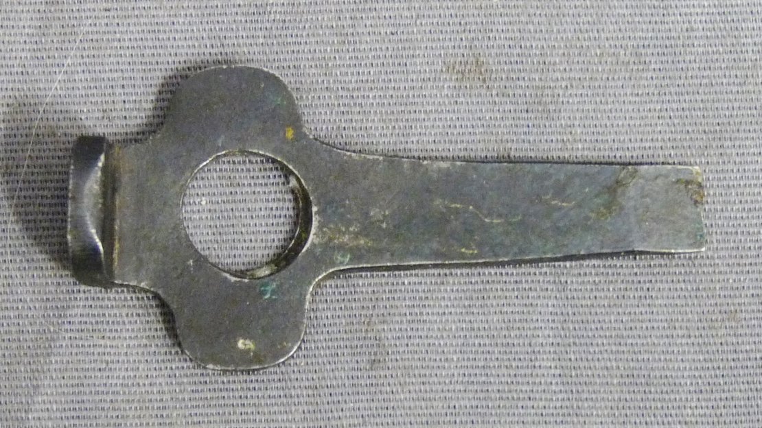

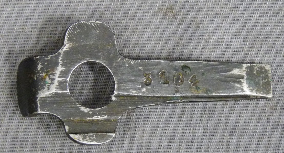

The holster, is very nice 1933 Wunderlich made Berlin police type; numbered to the pistol, 4286, on the front and with a Berlin Schupo marking on the back; and a numbered but mis-matched Weimar loading tool. Interesting to note that the "193" of the date was stamped first and with a 3 number die; then the last "3" was added in a different font.

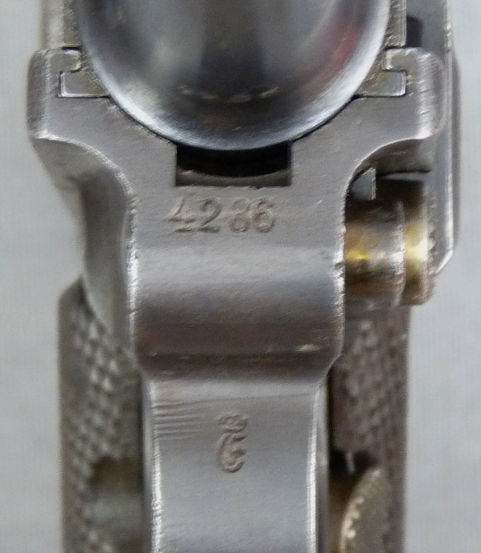

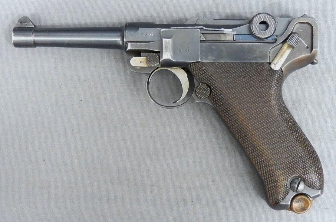

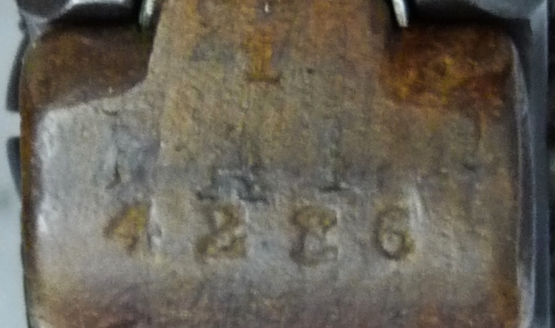

The pistol is an early Erfurt 1911-1913 frame no lug but with hold open added, number 4286; with matching number two police style numbered magazine, with an marking above the number which I can't quite make out.
The pistol has matching numbers except: the right grip, the trigger is over stamped 86, and the original striker is grooved. Barrel, receiver and sear bar are matching to 6235; the toggle is the original 86 numbered Erfurt part, as is the side plate. The toggle axle has been numbered 86. The police "mods" done according to 1932 orders, but no sign of a magazine safety or unit markings on the grip frame.

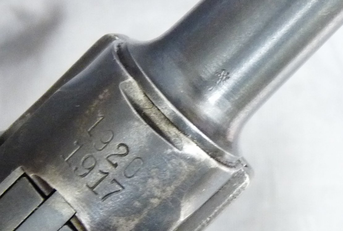

The 1917/1920 PS DWM artillery upper # 6235 has been re-barreled with a new bbl with a Weimar eagle visible on the top rear and numbered 6235 to match the receiver; the sear bar is cut and numbered "35."
I find this combination of parts "odd", especially with the holster and magazine still numbered to the pistol.
I can imagine a couple scenarios to account for this- from a field repair to bubba!

Looking at the magazine base, I've about decided the letters above the 4286 are "P.A.L.".
P.A.L. would be PolizeiAmt Leipzig; so even the magazine is "re-cycled"!
Anyone else want to take a stab at those letters?

I see a "PA" above the first digits "42" on the base of the mag if I don't expand that photo too much. An "L" I can't make out myself. Are there any other possibilities?

If not P.A.L., another P.A. choice would be P.A.Ch. - for Chemnitz- both cities are in Saxony.

I'm virtually certain it is P.A.L. You can see the vertical serif at the toe of the L.
