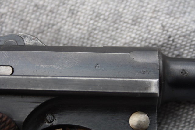

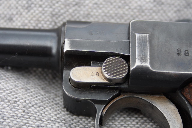

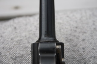

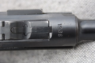

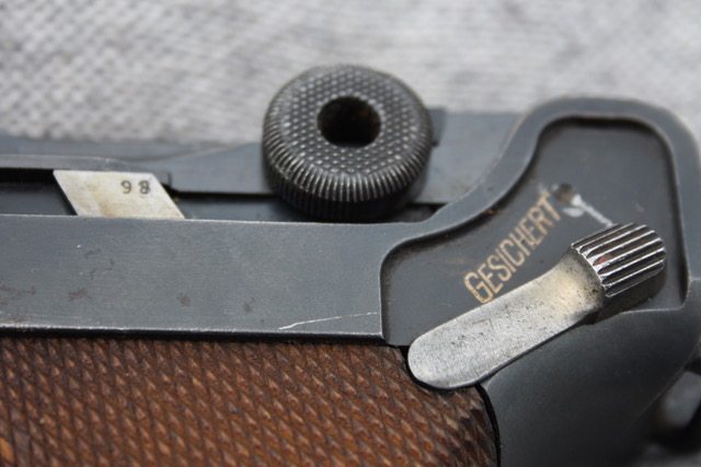

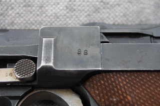

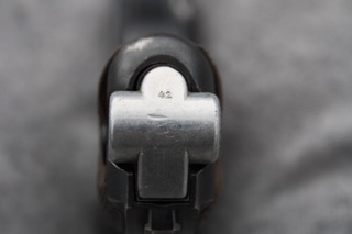

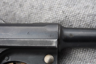

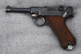

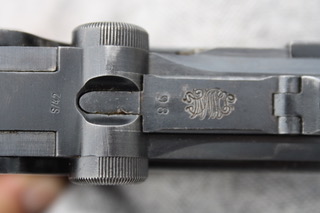

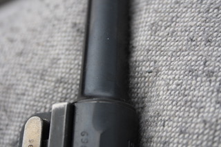

Hello
This one came with the postman today.;-)
Can you help me?
Looks most like the later KU marked??
Regards
Kai

Pictures won't enlarge for me, tough to see much detail.
Unread 10-17-2016, 11:30 AM   #4
Try posting your photos individually sized to about 1024 pixels on the longest axis.
Not sure what you have, other than a mixed parts Luger. I can't seen enough detail to tell if the receiver is Ku marked. Is it?
You do have an armorer's replacement magazine. Ku guns did have these earlier receivers, but I don't recall one getting a DWM marked toggle train.

Default Try these.
Better?
No KU marking.
Regards
Kai

Unread 10-17-2016, 01:07 PM   #7
Looks like DWM with some replacement parts fitted. Rear toggle and 1936 dated receiver seem to be Mauser made spares. LZa marking shows some Luftwaffe involvement in the repair process.

Thanks Vlim
Sound good too me! Maybe assembled at A Luftwaffe plant as the ku Lugers?
Regards
