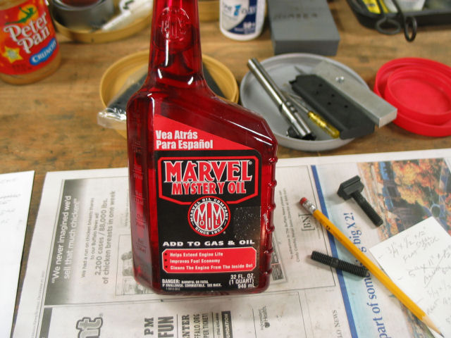

I've noticed many threads/posts asking what is best to clean/store Lugers. This is what the Marine Corps used back in 1969-70.
Boot Camp, Perris Island. Graduation, after 10-12 weeks of basic training. The day before Final Inspection, we spent the morning detail cleaning our M-14's. In the afternoon, the DI's had a 55 gal drum (cut in half lengthwise and mounted on steel legs) half filled with a 50/50 mix of Marvel Mystery Oil and gasoline. We dipped our rifles (minus stock) in the mix and swirled it around and then hung it up to drip-dry. The gasoline would evaporate leaving a thin layer of the Marvel Oil behind. The next day we would dress up for Final Inspection with our rifles. The inspecting officers would ask questions about what we had learned.

The Marvel Mystery Oil was great. The inspecting officers wore white cotton gloves, and my memory is that none were stained during our inspection.
I was in my local hardware store (a real one) and noticed that it is still made. I got a bottle, as I have been using 3in1 Oil for my firearms. 3in1 works great too, but is heavier than Marvel, so I picked up a bottle. A lot of my handguns are stored for years without being shot, and only cleaned occasionally. I'll be cleaning and dipping my handguns in the 50/50 Marvel mix and then placing them back in my safe.
Just thought I'd post this for general information. Everyone has their own favorite preservatives for their Lugers. Marvel will be mine.
