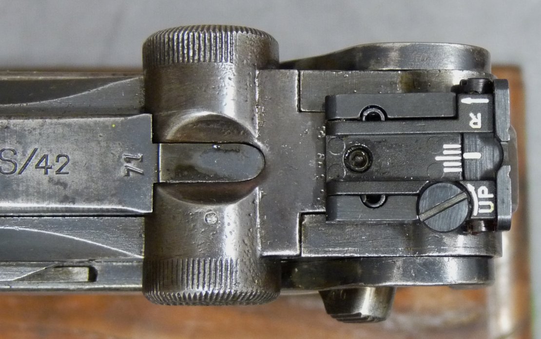

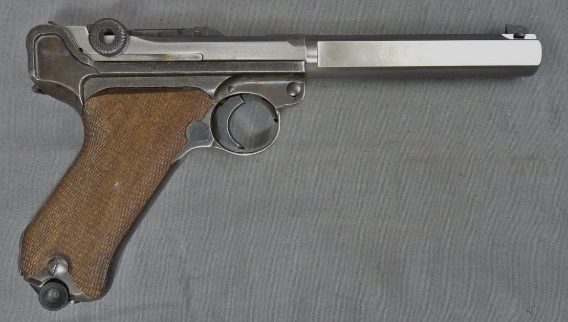

I've wanted to add an adjustable, target type rear sight and better visibility front sight to my GT 5" bull barrel special P 08.
After a lot of thinking and figuring, I decided to modify a Mecgar rear sight for the 1911 Colt type that I had on hand. It is a close knock off of the old MMC rear sight.
Except I think it is cast or sintered rather than milled from bar stock like the MMC was.
The first two pictures show the original rear sight and short front, this worked ok, but not a great sight picture-as usual.

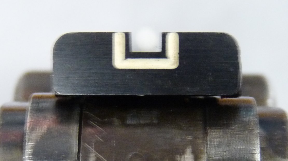

The third and fourth pictures show the adj. sight and tall front sight- when intact.
Fifth shows the decent sight picture.
Next is the broken right side from two different angle.

After some 30-40 rounds I determined the height of sight needed for the front, as seen it is quite tall- in spite of mounting the adj. rear as low as possible. Position is limited due to clearance around the rear rails as the sight rotates with the rear toggle.
I installed the tall rear sight and back to the range- unfortunately the right side of the rear sight broke off, never to be seen- so there ended that shooting session. But it did hold together for 40-50 rounds.

So I added a screw through the hole in the adj. part of the sight through the dove tail; this holds it but negates the vertical adjustment. But the windage still works ok.
6, 7, and 8 show the repaired rear sight. The top view shows how thin the web is that broke. The left view shows the mods to the dovetail and clearance to the receiver ears.
