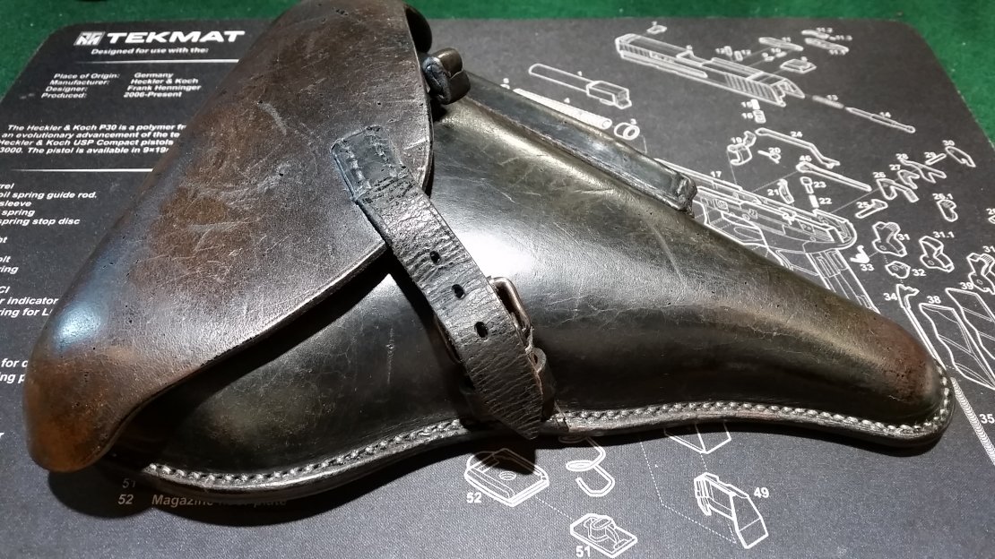

The newbie is back with a few questions regarding my holster. I obtained this holster with a 1939 military stamped Luger recently. As you can see in the photos the holster is spray painted with black paint?! Yikes! Was this the work of an errant prior owner or was it done early in its life for a purpose, such as for a color guard, sentry duty of a publically visible location, or other ceremonial purpose? When I was in the military many years ago, the pressure to achieve a high gloss shine on leather shoes and such would lead to some guy’s coming up with many schemes to out shine the others. Did someone get the rattle can out in the 60’s or is this a period correct German military procedure?
That being said I am inclined to believe it was some misguided attempt much later to make an old holster look good. I have made an online purchase of a book on Luger holsters that I have yet to receive. Hoping that be helpful. Additionally, I was hoping to tap the collective knowledge of folks on this forum for any insight on my quest for understanding. If you cannot tell from the photos, on the back of the holster are the following stampings: “eue/40”, eagle over swastika above “WaA300” and then “P.08”
If I am advised it definitely does not belong on the holster, then I guess I should remove it. Do you have any suggestions as to how to do this without damaging the leather or the patina? In many places it is easily flaked off with the gentle persuasion of my thumb nail. On other areas the paint may be more tenacious.
As to the holsters background, it came with the 1939 luger and was a GI bring back (as I have detailed in another post). After the local GI died in 2004 and the spouse died last year, the family sold it to a guy that only owned it for a few months. So the Luger and the holster were not in too many hands.
Thank you for your thoughts and comments.

I have seen some holsters like that, and I was told that they were fixed up after the war, possibly by Russian arsenals.

It's a little shiny but doesn't look spray painted to me. Wouldn't the roller buckle be painted too?
Is there any overspray under the top? I didn't see any. Could be just a wax.

This looks like roll-on shoe polish to me. I cannot recommend anything to remove it without endangering the holster itself, but much of it may wear off in time.

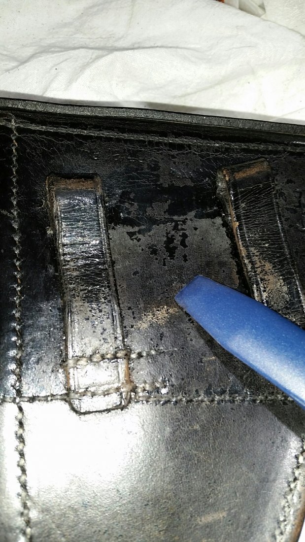

I would try careful scrubbing with 0000 steel wool. Do not apply much pressure. Try it on a belt loop first. I have removed paint and wax this way. Just ,go slow and easy. Bill

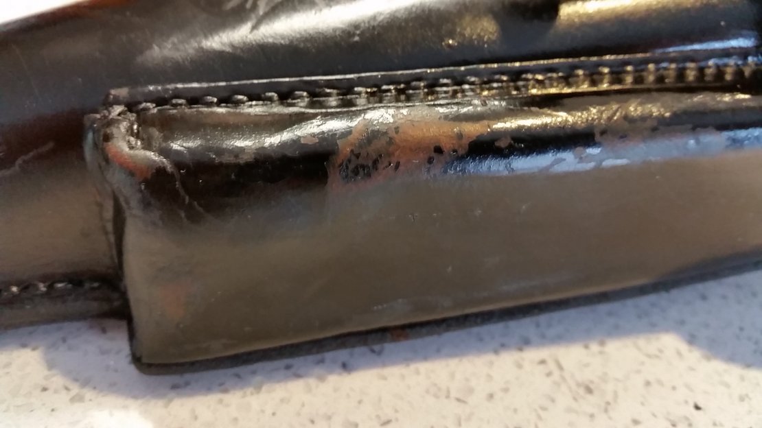

LHR, perhaps if my photography skills and equipment were better, you would be able to see the paint like product that was applied much more clearly. I am able to use my finger nails to flake off some of the hard black 'paint' or whatever it is. The paint does not adhere to the finished leather very well in some of the spots I chose to experiment with scraping a little of it off.
Yes, the buckle was painted. I did begin to meticulously thumb nail off some of the crusty, flaky paint from the buckle, when I decided to smarten up and seek some advice from the forum before I damaged the possible historic value of the painted holster.
I do believe that the product was sprayed on because there is a run in the 'paint' between the belt straps from over application. Regretfully, the run or drip of the paint is not very clearly shown in the photo I provided. But, it is noticeable with the naked eyeball examination when holding the holster. LOL

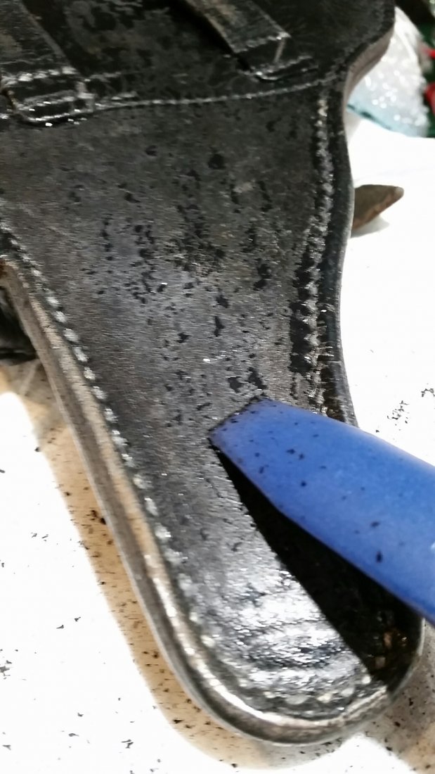

Sergio, I might not even need to consider the 0000 as Bill suggests as this product (in the very limited areas I sampled) can be removed, well, like fingernail polish comes off of ones finger nails by simply chipping it off with a thumb nail. I was married enough years (God rest her soul) to have witnessed finger nail polish chipping. LOL
If this is shoe polish then I have never seen any polish like this sold by Kiwi. LOL In other words this is definitely not a conventional type of shoe polish that smears on and stays relatively soft and does not harden or chip.

I would try cleaning it with acetone first to see if that takes it off. Acetone won't hurt the leather. I use a fingernail polish remover with 75% or more acetone content.

Tandy leather Corp. bottles up acetone, calls it leather cleaner and sells it as just that. Fingernail polish can be had in many % variations and some with a pleasant scent. Plus the bottles are better for storage. Let us know how it works! I use it all the time.
I would try careful scrubbing with 0000 steel wool. Do not apply much pressure. Try it on a belt loop first. I have removed paint and wax this way. Just ,go slow and easy. Bill is correct. Used lightly, 0000 steel wool can be effective. I have even used 2000 grit sandpaper on occasion.

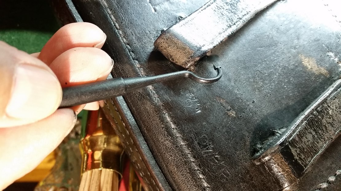

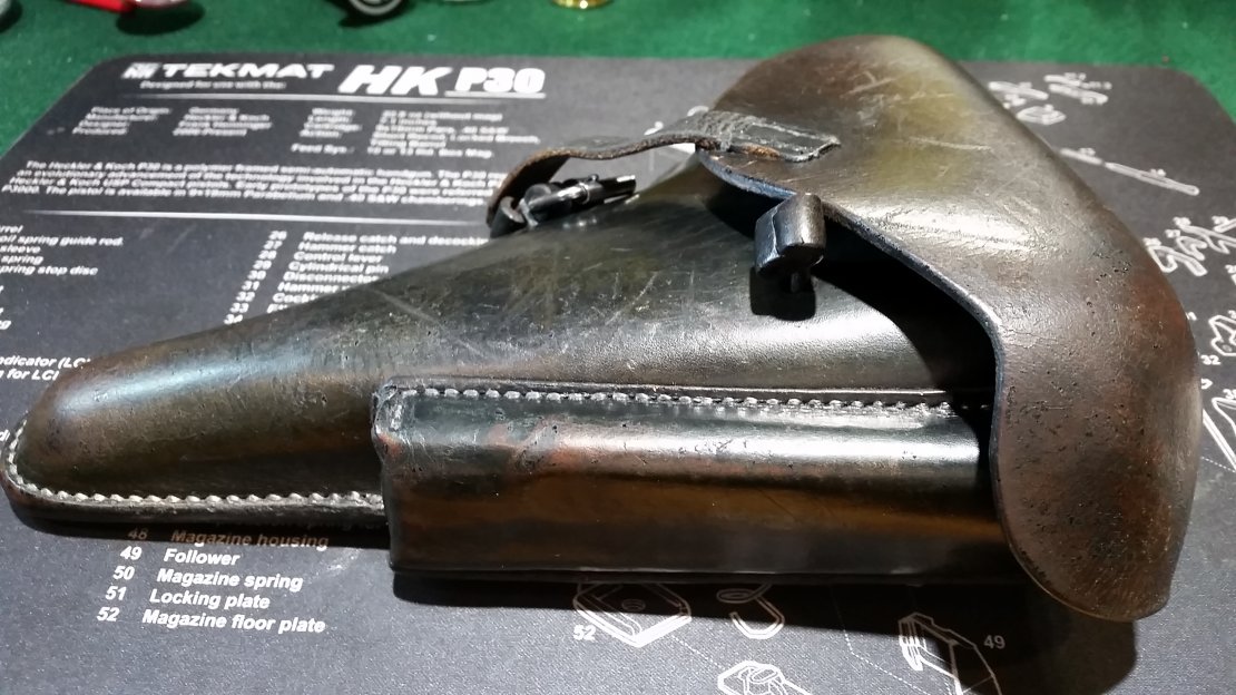

A few months have passed since I posted my concern over this black spray “paint” applied to my holster. After several of you assured me that this paint job was not 'correct', I decide to try to, oh so gently, scrap it off with a polymer chisel tool (used for automotive interior work). This seems to have worked well based on the outcome and I wanted to share my work with my friends on the forum. (Note photos taken at the beginning of this thread that show the shinny black paint.)
It took me about 6 hours over several days of tediously scraping the leather to scrape and chip away this darn paint. In some areas like the front of the holster the paint came off more easily. Then in others, like the belt straps and holster strap, the paint clung so tightly to the leather that I feared damaging the leather if I attempted to apply more pressure to remove the paint; so some paint remains. My photo taking ability does not show the dramatically improved appearance of removing the paint as it does it when holding the holster. You can see the small paint flakes comin off. I might try the use of acetone, as several have suggested, to remove the remaining small flecks of paint. The last two photos show the nearly completely finished restored work. I did apply some Connelly leather product after the work to nurture the leather. (Thanks for the tip, Jerry.)
I am so much happier as it stands and even my fiancé noticed the significant improvement.

hey, looks great!
Unread 07-05-2016, 09:22 PM   #18
hey, looks great!
It does indeed!
How did you 'whiten' the stitching???
And what is that little hooked tool???
Unread 07-05-2016, 09:26 PM   #19
Donald, Very nicely done!
