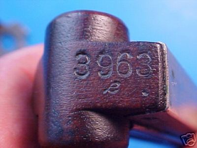

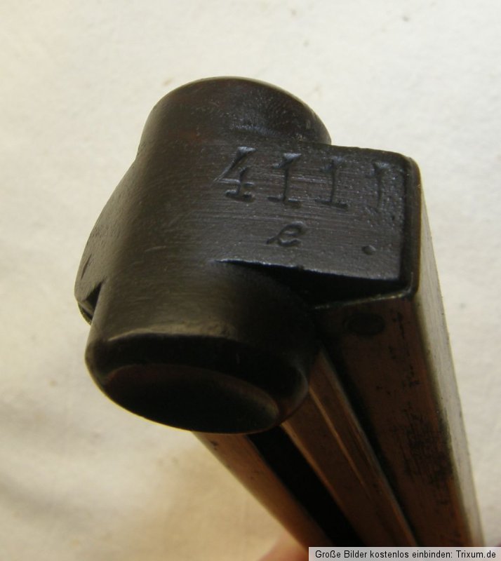

Do all all of the 1st issue P08s (1908-1913)
Use the magazine with the Large numbers running along the spine of the wood bottom?
If not what year did the change take place?

Wayne,
This was only on DWM mags, (not Erfurt), and that style ended in 1911, not 1913. To the best of my knowledge and research, all 1908 through 1911 ‘e’ block DWM mags have the SN stamped from front to back with large numbers, no suffix.

Here some

Only DWM1911 "e" suffix are stamped with the "e" runing along the spine

Seems the point is for the + extra magazine
