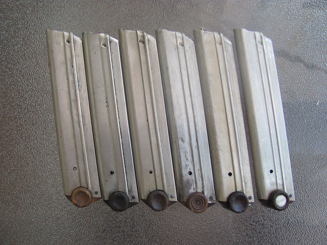

Is there a difference?

Thanked 2 Times in 2 Posts
The first two appear to be numbered factory replacements and the others are also Erfurt but in the standard numbering pattern.

Unread 05-22-2016, 11:55 AM   #4
Yes,
there are different "Erfurts", early ones- before 1916 approx.- had two crown/letter inspection marks, as do the two on the left. Later one crown/letter sufficed.
I seriously doubt the two on the left are "replacements".
DWM commercial mags were not numbered.
DWM military mags were numbered, including, suffix, with a "+" on the spare mag.
There are exceptions of course.
Replacement mags get really complicated really quickly, they can have all sorts of combinations.

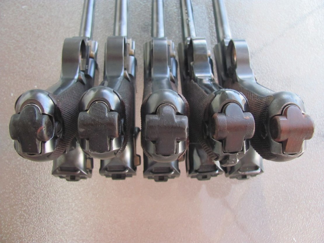

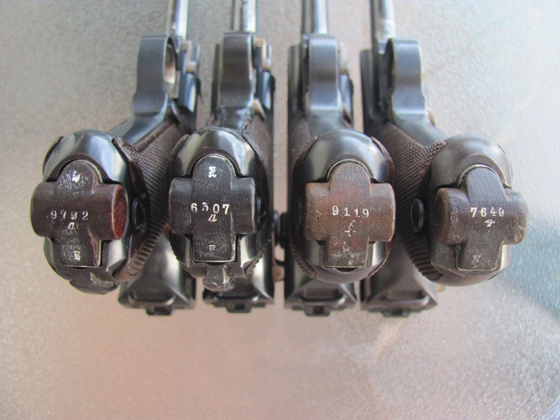

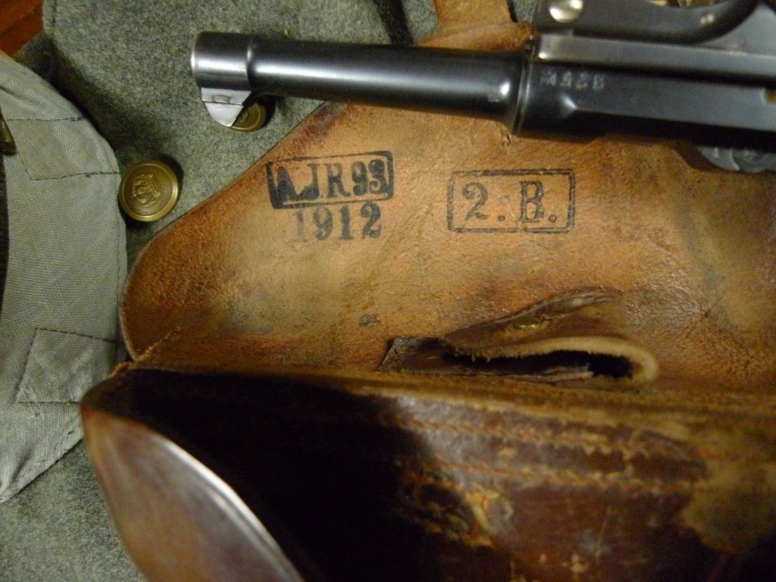

True early Erfurt mags were unnumbered with two acceptance stamps but all pre 1916 issue mags were numbered with two acceptance stamps. See the photos below. The spare with this rig was an unnumbered stamped mag.

Photos

All military contract Lugers came with two serial numbered mags with the exception of Navise and artilleries. The Navies with three mags and the artilleries with perhaps as many as seven serial numbered mags.
