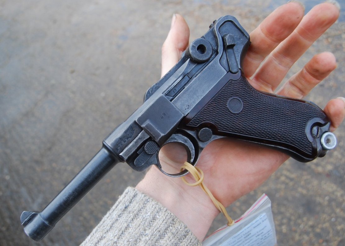

I've been sent some photos of another luger which I may buy if it's ok. As I said in my other post I'm new to lugers and know very little if nothing about them so I'm hoping that once again you wonderful guys out there will help.
I've not seen the pistol myself but I've uploaded some photos I've been sent and would love to have your comments.

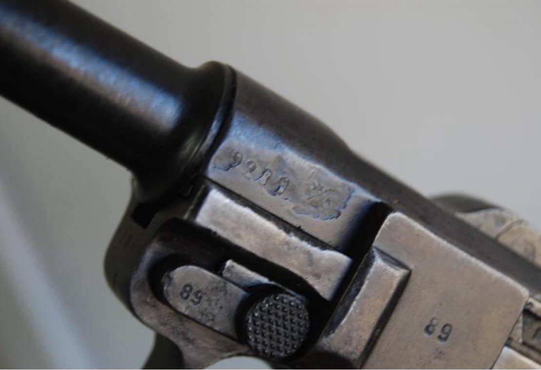

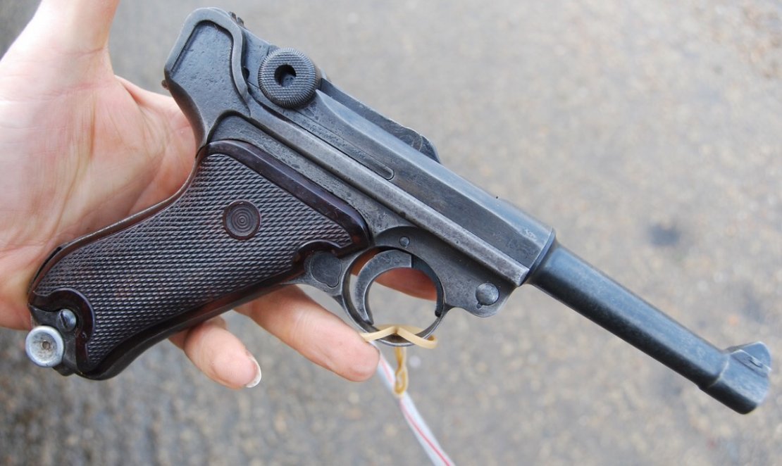

The fifth photo shows some damage or blemish around the serial number and Birmingham Proof mark on the side of the gun. Any ideas what that may be?
I live in the UK, and the price of the gun is about equivalent to your 1370 dollars.
many thanks
John

Prices in the US of A and in the UK are not really comparable l'm afraid. Anyways, that pistol as all the looks of post war Deutsch Volkspolizei (vopo for short) use.

The finish appears to have received moderate to heavy buffing and has been re-blued as evidenced by bluing over pitting. The grips are not original and appear to be Vopo (East German).
The other key questions I'd have in trying to evaluate the pistol would be markings/condition of the magazine, bore condition, and which parts do/do not match.
The re-blue, buffing and damage around the receiver serial number relegate it to "shooter" status. Here in the USA its value would be not more than $900 USD and very possibly less depending on the answers to the questions mentioned.

That ain't blueing over pitting. That's blueing over the heat damage done to the gun when the chamber was carelessly welded shut under the UKs brutal "Deactivation" program. In this case, with no regard to the pistols outer looks.
Within the confines of the UK laws, at least find an example that was treated with respect upon deactivation.

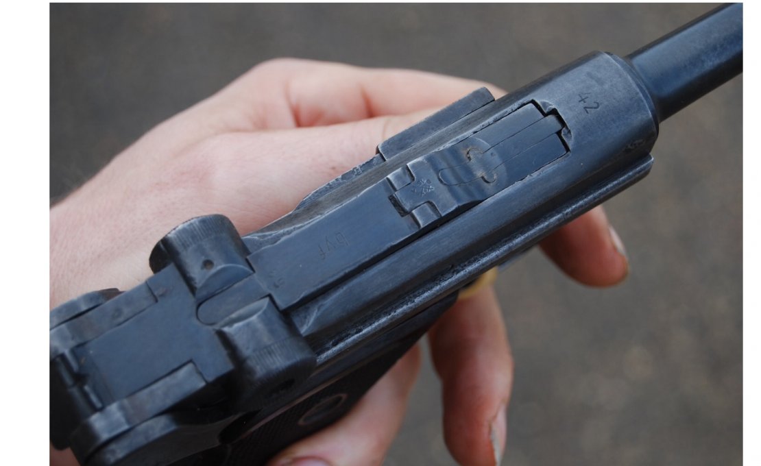

I think a misunderstanding is afoot, John. It is a byf--code for Mauser--made in 1942, and certainly qualifies as a WWII weapon. Its post-war life happened East of the iron curtain, with the folks' police. There were plenty of pre-WWI Lugers that survived not only the Great War, but the Wiemar period, and WWII, and are now called VoPo as well. Not a reference to era of manufacture, rather, to a particular fate. The VoPo pistols were liquidated by their former Soviet allies, and many wound up in the U.S. Their resume' affords them their own niche in the realm of collecting, albeit limited due to the sometimes harsh treatment when re-worked post-war.
Bill is just saying it is too expensive for one in this condition, in this category. Greg points out buffing and re-bluing, which unless expertly and carefully done, punches holes in what might have been its value!

A small misunderstanding, I think. I based my "re-blue over pitting" comment on the views of the right side of the gun; forward of the toggle knob and scattered over the frame there seems to be re-blue over light pitting. I don't doubt you are correct as to the heat damage. And I appreciate the learning offered by your comment; I was puzzled by and did not comment on what caused the damage around the serial # (I assume that is what you were referring to). I share the disgust at a lovely and historic pistol being crudely defaced.
I have an example that is re-blued over light pitting and this gun is very similar in appearance.
