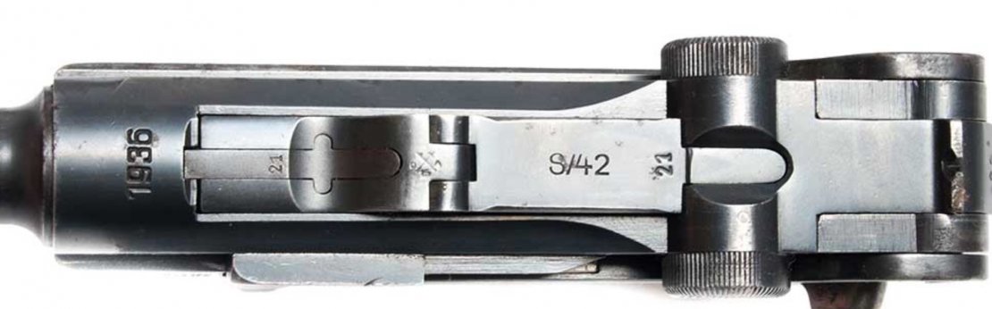

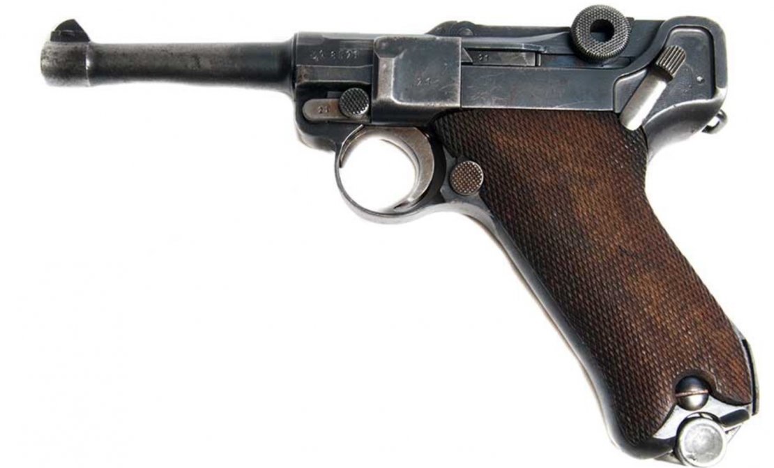

hello Everyone
I'm new to the forum and know nothing about lugers, just that I like the look of them.
I intend to buy one and wondered if you knowledgeable guys could cast an eye over my pictures and let me know what you think?
Is the serial number correct for the model or should it have a letter suffix?
Any comments would be gratefully received.
thanks
John

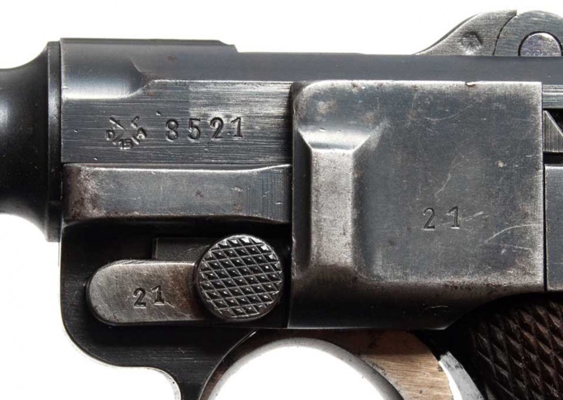

The letter suffix is under the numbers on the front of the frame. "A"?
I can't comment on whether the numbers are correct for the date, but nothing scares me on the gun, if priced accordingly for its condition. I'm curious what the others say the stamping is on the left side ahead of the number.
What is the asking price?

That's Pounds Sterling??? Is it deactivated???
Looks to be a 1936 Mauser made S/42. Just before Mauser reinstated the hump.

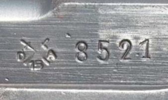

Me, too. Looks like something for the FAQ.
Crossed swords, w/D & A over 15???

guns3545
Join Date: Aug 2006
Location: Florida
Posts: 438
Thanks: 661
John,
Welcome to the Forum.
This appears to be a well worn, but overtly honest 1936 Model P.08, the standard issue of the day to the German Armed Forces.
The letter suffix is a "k' indicating it was made in Spring 1936 at the Mauser Factory in Oberndorf am Neckar.
Somewhere along the way, it was proofed in the UK. The crossed swords and letters and initials indicate the Birmingham Proof House.
More, I cannot say.
Hope this helps,
John
I'll venture Birmingham, D(e)A(ctivated) in 2015.

Thanks: 2,079
I am glad there are others on the forum; I was thinking, that marking on the left side looks familiar, but I was going down the wrong path!
Unread 03-27-2016, 07:03 PM   #11
I wonder if that stamping isn't a specific deactivation mark? If it were from a British proof house surely there would be a lot more stuff stamped here, there, and everywhere.
Flintlock, we heard talk recently that the EU was cracking down on deactivated guns too. Anything to that?

From what I know when a weapon is deactivated in uk it only has the one stamp of the proof house that actually did the job. If a gun is proofed in the uk there are a lot more marks.

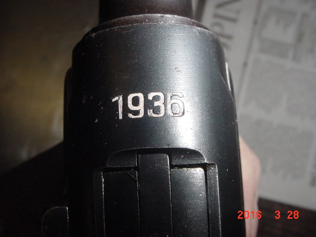

Apart all that has been said, I'd like to hear other people's opinions on the date 1936 on the chamber...
Sergio,
Good catch!! Never paid attention to it. Certainly did not leave the factory that way.
Mea Culpa!!
John

hi Sergio and John
Thanks for your comments about the date. As I said earlierI know nothing about Lugers so would you be able to explain your doubts so that I might learn.
Thanks again
John
Flintlock2016 is offline   Reply With Quote
Unread 03-28-2016, 10:41 AM   #17
guns3545
Join Date: Aug 2006
Location: Florida
Posts: 438
Thanks: 661
John,
This is one of those difficult situations where there is no substitute for having the gun in hand.
First, a word about markings.
Dates were rollmarked onto the chamber of the receiver. This process involved holding the piece firmly in a jig, and heavily rolling a die, shaped like a wheel across the surface thus impressing what was on the die into the metal. Hence rollmarking. This technique is used when the same mark must be impressed on many, many pieces; like the 100,000 or so Model P.08s Mauser would make in a year. Or the 10,000 suffixes in a block
This contrasts with proof marks and serial numbers which were stamped with a die and a hammer. Hence each piece is individually stamped.
Both hand stamping and rollmarking leave ridged edges and squarish corners. Neither removes metal; it displaces it.
Alternatively you can use a rotary cutter and a pantograph to cut metal letters and numbers into the metal. And..since the tool is a rotary tool, it leaves curved corners. And metal is actually removed, not just displaced.
Now, first the good news. The location and style of numbers on your pistol look correct. The chamber date in 1936 used slightly different fonts than 1937 and subsequent years. Later years were less squarish. This is why no red flags showed up for me the first time around.
But, and this is a big but; the numbers look deep, and with magnification of your photo, the edges look a little off. Now.. it could just be the photo. But, you should take a good look at the chamber date especially taking note, seeking rounded corners. And, a square bottom, as the rotary tool had a square bottom whereas dies are slightly tapered and the depth of the number is slightly wedged shaped.
This might indicate that the date was freshened up.
That's about it. You may wish to browse the site searching for "1936 chamber marks". Or simply 1936. There should be chamber photos on the site.
Or, alternatively, go to this site and you will see numerous examples of Lugers and their markings. Search the section entitled Mauser.
http://www.simpsonltd.com/index.php?cPath=179
Hope it helps.
John

Many many thanks John. I would guess that would devalue the gun quite a lot?
Glad I haven't bought it.
John

Here are a couple of photos of my 1936 shooter, both the same gun:
Unread 03-28-2016, 12:17 PM   #20
Flintlock2016
Join Date: Mar 2016
Posts: 35
Thanks: 35
Thanked 4 Times in 4 Posts
Thanks again, dju. The gun I was considering looks nothing like that!
