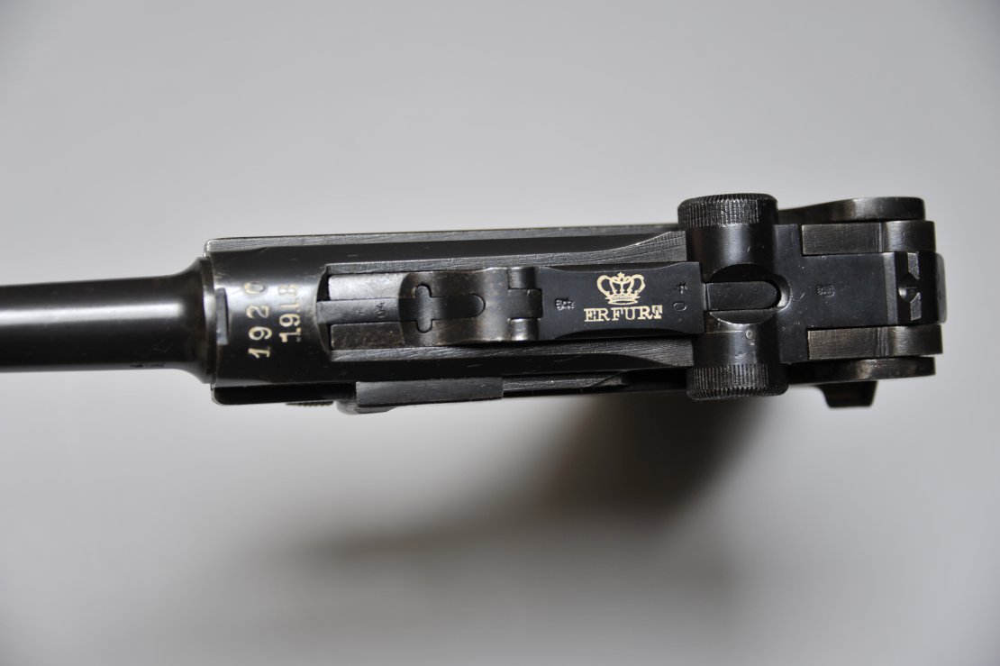

I think you must be right, in fact I enclose a picture of my Erfurt.

Unread 11-07-2015, 09:48 AM   #11
Sergio, I can't make out your chamber date - Is it 1918???
So it's the extreme right side of the crown that has the chipped/broken die imprint???
Is there any evidence of what year this occurred???
Sergio, your toggle looks orders of magnitude better than the one on GA. Doug's comment on the stamp impinging on the radius is well taken. I think someone has a nice new Erfurt stamp. But they need a finer tooth file.
Edit: The GA Erfurt stamp is not centered lengthwise either.

Unread 11-07-2015, 09:53 AM   #12
Richard
Yes it is, 1918 doubledate.
I've got no evidence of when that exactly happened mine is # 2904

Posts: 2,675
Thanks: 3,247
I have an all matching 1916 Erfurt with the right side broken mark. I had a 1917 Erfurt and it was even more pronounced. . Bill

Richard: In Jan's Central book he shows: 1914 with a broken die., A 1916 without a broken die, a 1917 and 1918 with the break. So ????? Bill
And the "1914" Jones Erfurt LP-08 referenced by the seller shows an unbroken crown...But it is centered both ways...
And the chamber date on the Jones "1914" LP-08 is 1917...
