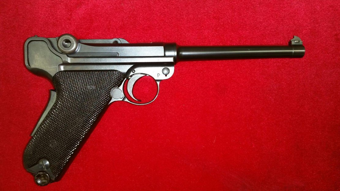

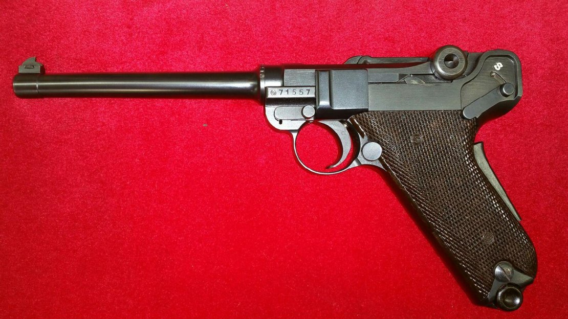

Hello all, been a while since I have posted...I came across an interesting luger and wanted to see if anyone has some more info..I will not ask for an estimated value , but if you want to offer, it would be appreciated...of course, value depends on condition and these pics will not show that too well..
Anyway, this is an 06/29 Swiss Luger with a P stamp, 'privat' I suppose??

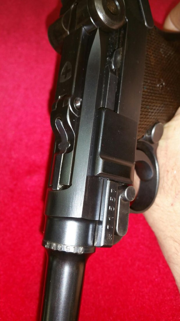

This luger is chambered 9mm with as 6" barrel...one would assume this was re-barreled in 9mm and a 6" barrel...but, what strikes me is that the barrel has the serial number and the BP symbol stamped in the collar of the barrel (collar is probably not the right term, but the narrow area just before the barrel meets the receiver) I believe it is a BP symbol, I could have this wrong...
My question: Was there ever a 9mm Swiss Luger manufactured with a 6" barrel?
If the barrel was unmarked, I would not be as curious, but, since the barrel has the serial number and BP symbol, similar to many 30 cal 4.5" Lugers I have seen, I thought perhaps this was a factory optioned Luger...
The serial number is 715XX
I did read that some high profile shooting competition was won (Olympics????) with a long barreled Swiss 9mm...given the success of the longer barrel 9mm in the competition, perhaps this was a popular modification to a standard 30 cal, 4'5" luger back in the day...
Any ideas would be appreciated...!!!

FWIK your pistol must have been produced in 1944
I've never seen any records confirming that a certain number of 1906/29 had a 6" barell.
I assume, but I could be wrong, that it either belonged to one of the "experimental" guns made in those late years for the Swiss Army, or perhaps more likely adapted by an armourer to satisfy a specific request by a private customer.
Nice gun anyway.

Many thanks for the insight....yes, you are correct, the year stamp confirms your hunch, it is 1944...
Any further thoughts on the following: If the second scenario is correct, 'adapted by an armorer', would said armorer likely add the serial number and BP stamp? Or, would they simply fit an unmarked barrel picked from a parts bin?
It is the presence of the serial number and BP stamp that has me so curious as these stampings match those found on standard barrel configurations...
Again, thank you for your thoughts...

The way I understood the experimental swiss Lugers was that they had a "P" prefix before the serial number which yours does not. I can only think this happened during refurbishing by the Swiss military postwar.

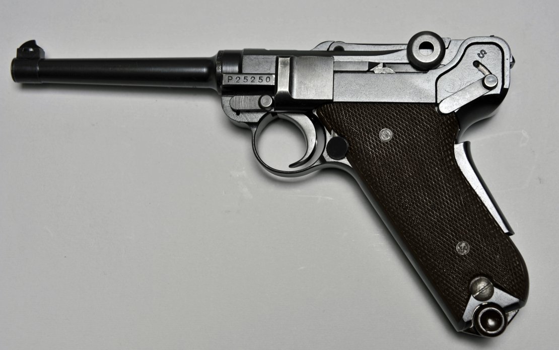

The prefix "P" before the s/n only ment "PRIVATE" gun, like mine pictured below.

The "BP" stamp on the barrel is more like a reverse B and P brand. I think that makes it a Swiss barrel. If the Germans had made this gun or a gunsmith for Olympic class shooting, they would have included an adjustable rear sight. I think it's interesting and valuable as a Swiss 9mm long barrel. Nice finish, too!
I have never noticed a grip safety like that one or smooth toggle grips, either.

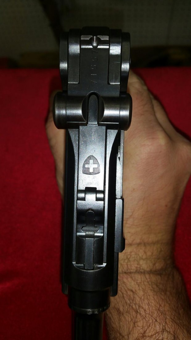

Excellent! Here is what attracted me to this Luger, as compared to my 1937 'S/42' Mauser Luger, my 1900AE Luger, and my alphabet commercial (plus two 'mutt' P08 Lugers) -
- Smooth toggle knobs
- Smooth magazine button
- Smooth/round button safety lever
- Smooth takedown lever
- 3/4 Trigger
- Long grip safety
- Long sideplate hump
- Turned barrel extension [it's rounded!]
- Long barrel w/"1900" style sight blade
- Unrelieved sear bar
- "S" stamp on frame for safety ("F" as well?)
- Swiss cross on toggle
That is just the physical differences I can see; it would be interesting to see if it has the wide chamber mouth, what kind of magazine it has, if it is original finish or a hot dip (doesn't look like any buffing).
These may all be typical for a Swiss Luger, but I have never seen one in person, so to me they are 'differences'.
Ir would also be a guide to us who are envious of it to know how much you paid for it, and if from a dealer, individual, auction site/house, or whatever...

Excuse me what do you mean with "the P before the serial number serves the same purpose at an isolated 'P' stamp, show the soldier privatized the firearm..." Swiss soldiers never privatized any firearm, when the soldier left the Army, his gun was stamped with an isolated "P" or a P followed by the date it was privatized, in any case never in front of the s/n, then the gun given to him.
The letter "P" in front of the serial number only represented that the gun had never been issued to the Army but to the commercial market.
