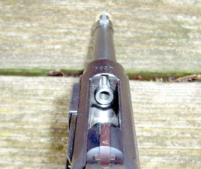

- I decided to make my own .22LR Luger barrel insert and see if a center-fire pistol will fire .22LR cartridges.
I've seen two .22LR Luger barreled extensions [receivers] in the last month, both [apparently] intended to be used with Luger components, not Erma SE08/2 'kit' components.

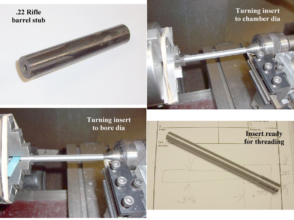

So I dug out an old .22 barrel stub left over from some long-forgotten short-barrel conversion and turned it down to fit the Luger 9mm chamber and 4" barrel.
Pics below show progress today.
I'll thread the insert muzzle and chamber it this weekend or early next week.
It will be single-shot, no magazine feed, no extractor, no ejector. Wooden dowel for poking fired [hopefully!] cases out.

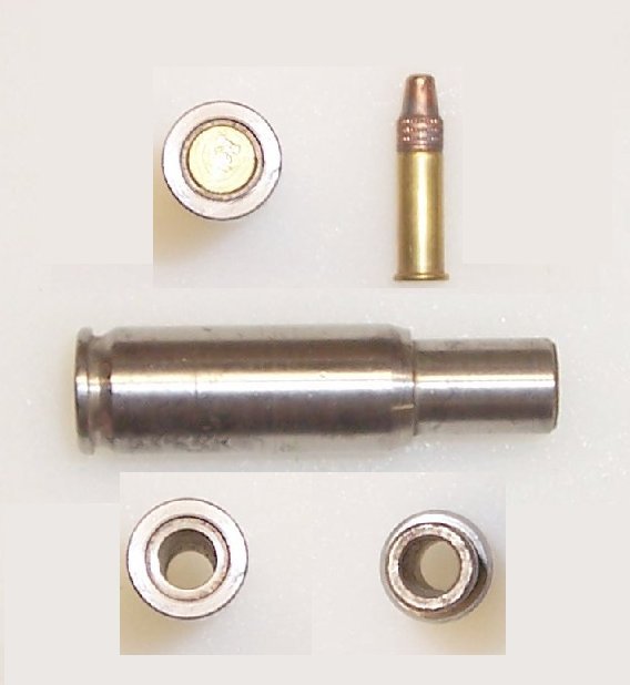

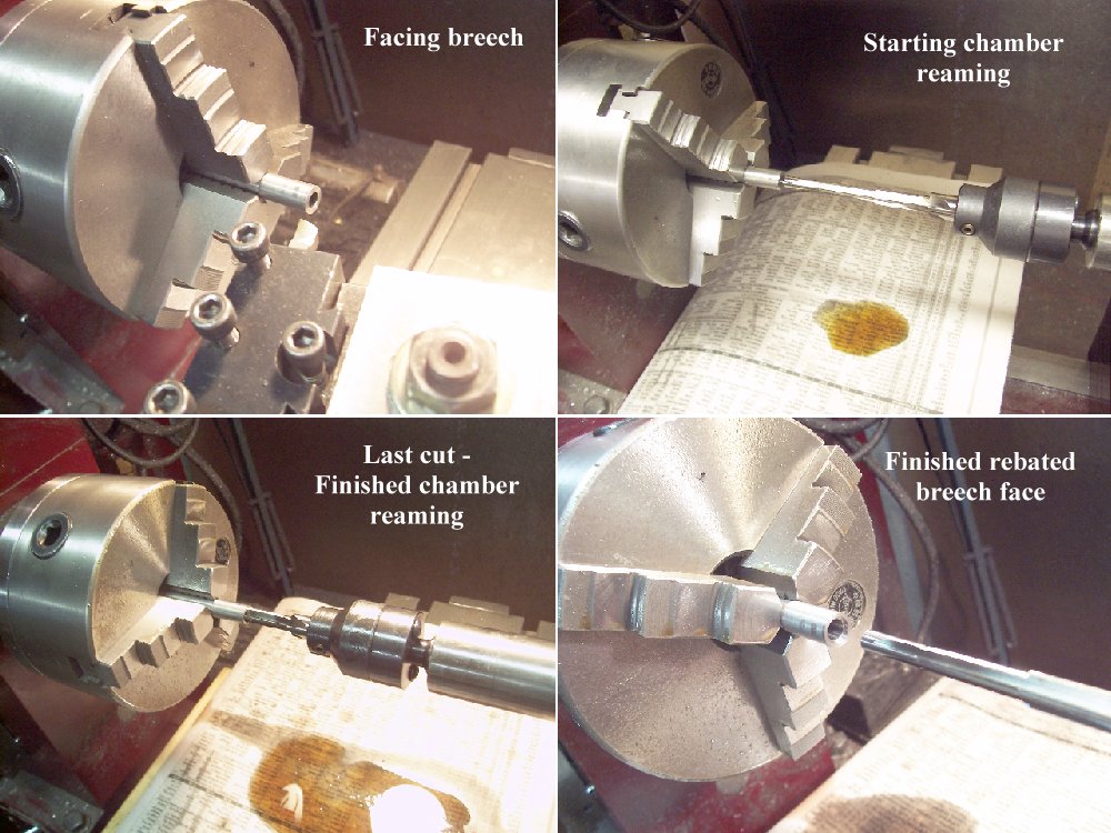

In the meantime, I've faced the breech end of the insert to 9mm case length and reamed the chamber to .22RF.
Just for S&G, I loaded a fired case into my barrel insert and 'fired' it with all-Luger components in place. Just to make a firing pin impression.
Whoa!!! That is one big firing pin strike!!!
I don't have a needle-point verniers, but my 1/16" square-end verniers shows a .024"+ deep dent!!! That's more than my 9mm Parabellum firing pin strikes!!!
I don't want to do any 'real' test-firing until it's threaded and a nut secures it in the barrel...Just in case...

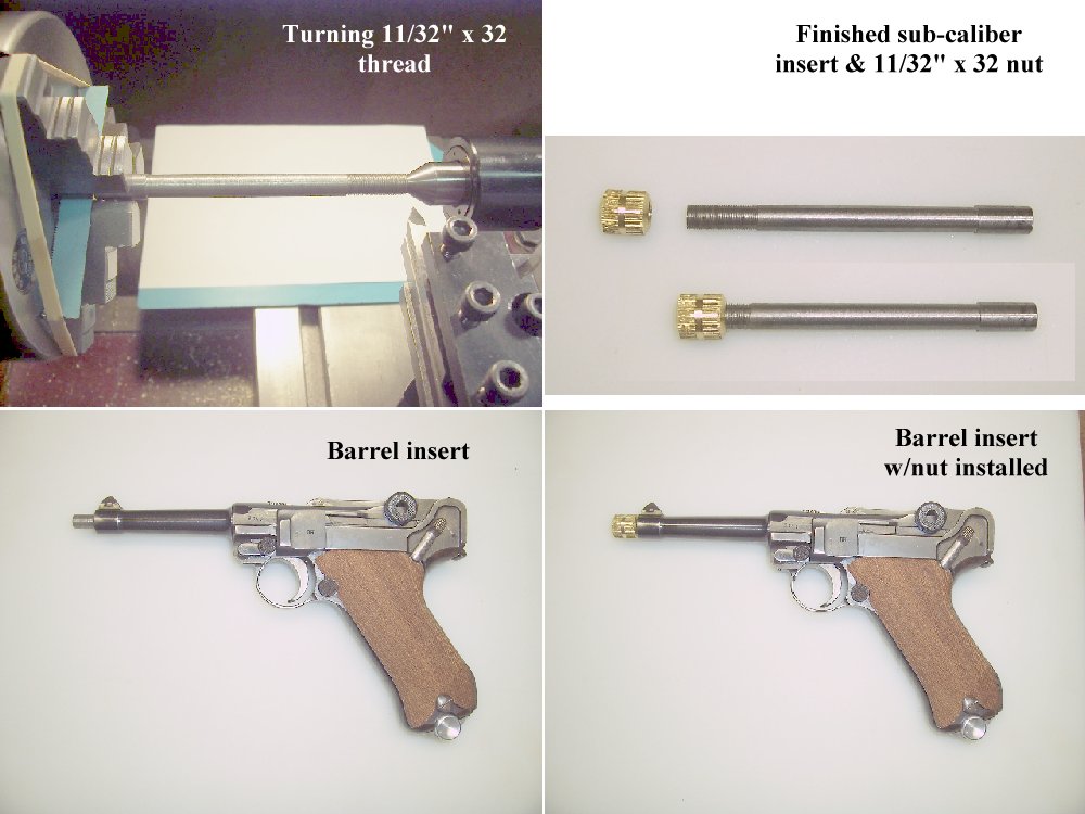

In any event, my sub-caliber insert is finished. Pics below. I had to wait for the 11/32" x 32tpi NEF tap for the insert nut. I made the nut out of brass just for S&G, and *tried* to knurl it at 14lpi but it didn't turn out too good...
I'll try it out ASAP but as usual I've finished something on a weekend and the club is jumping with shooters. Fall small-bore leagues starting up, center-fire league still going strong, and the occasional cowboy all lining up to shoot.
I'll try next week during the day.

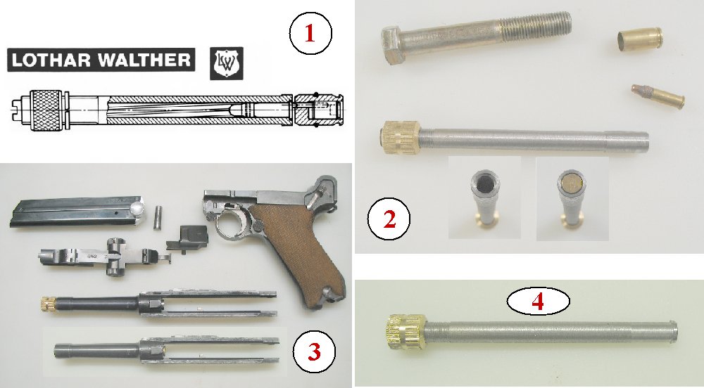

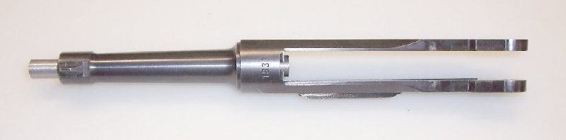

- There are several Lothar Walther sub-caliber insert kits for sale on eBay. I've looked at pics of them and a cross section and I think I can salvage my home-made insert assembly.
Here's what I'm going to be working with -
- My chambered barrel insert, for 9mm cal 100mm barrel, w/nut
- Grade 8, 7/16" bolt [4140 steel]
- Pic of Lothar Walther model 1-70 .22LR adapter

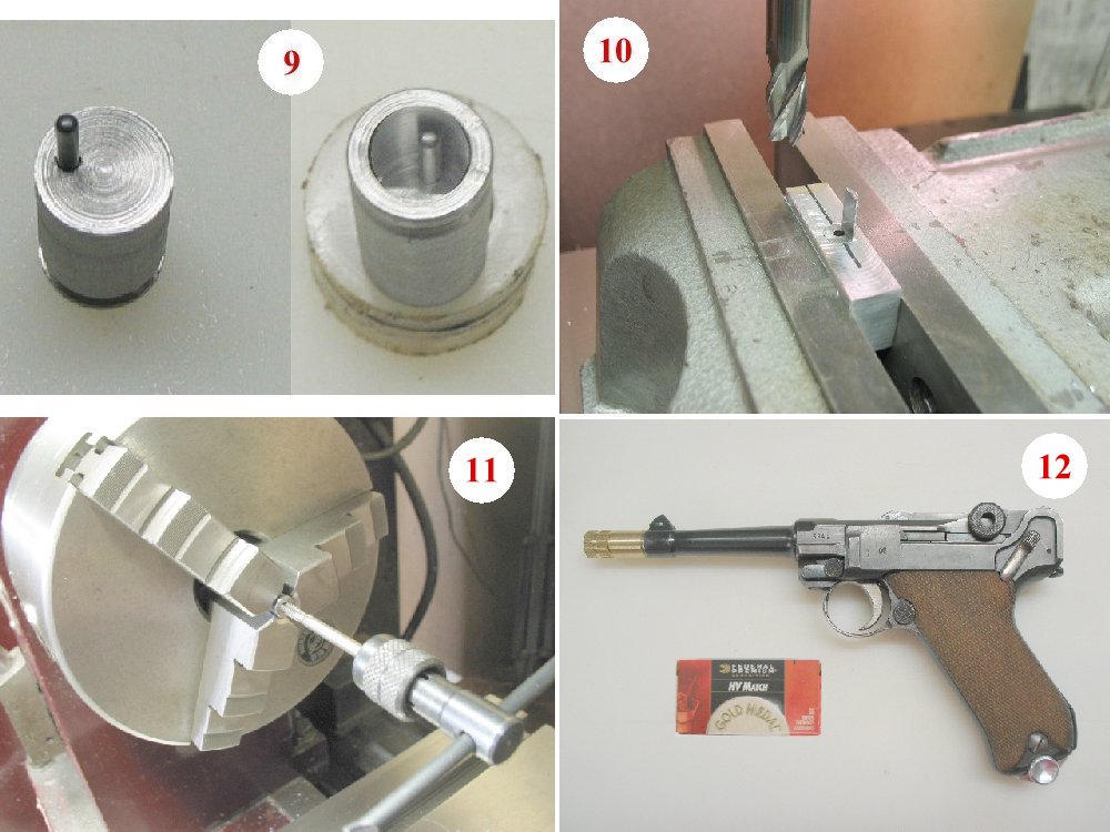

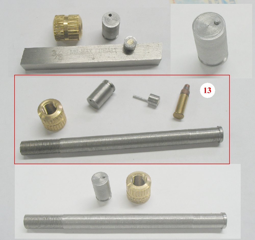

I'll start by turning down the chamber area of the insert to just a short flange.
1 - Cross section of Lothar Walther sub caliber adapter
2 - My barrel insert before modification, with Grade 8 bolt for firing pin adapter
3 - byf pistol used for testing, showing barrel insert in place and just 9mm cartridge in chamber
4 - Modified barrel insert now has .070" flange rather than full chamber step
I decided to use an integral one-piece firing pin, in a 1/16" hole.
5 - Picture of Lothar Walther .22LR adapter cartridge
6 - Turning firing pin holder out of the Grade 8 bolt, extractor groove cut
7 - Drilling & milling the cavity for the center section
8 - Drilling the hole for the .22 firing pin
9 - Pics showing a RCBS small primer decapping pin in .22 firing pin hole[.062" dia]
10 - Milling the .22 firing pin integral with adapter center section
11 - Drilling & tapping the center for a brass insert
12 - Finished unit installed and ready for use

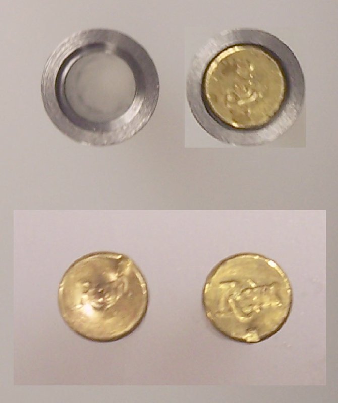

I took it to the range today...It didn't work.
13 - All the parts, different views

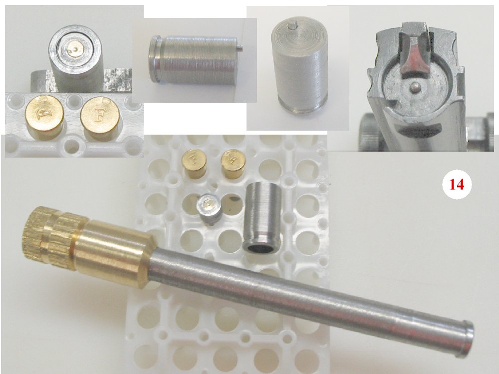

14 - From upper left - strike in adapter center section & rim strikes on two cartridges; adapter showing pin protrusion; breechblock showing Luger firing pin protrusion; parts of unit.
The Luger firing pin made a light strike on the adapter center section and the adapter center section/firing pin made light strikes on the .22 rim. Not enough to fire the cartridge.
Next, I will try rounding the adapter firing pin tip and see if I have a stronger Luger firing pin spring. I have a Wolff Spring Pak but I forget if it came with a stronger firing pin spring.
Everything seems to be working correctly, it just doesn't fire.
You can clearly see the pin depressions on the .22 rims in pic 14.
(The unit itself was originally made for the Tikkakoski 120mm 9mm barrel; a short spacer had to be made for the P08 100mm 9mm barrel.)

The strike looks light and short???
Unread 11-20-2015, 07:58 PM   #18
Hi Bill! How ya doin'???
Yep, that's what it is. I turned the cartridges so the strikes would be at ~12:00 o'clock...
