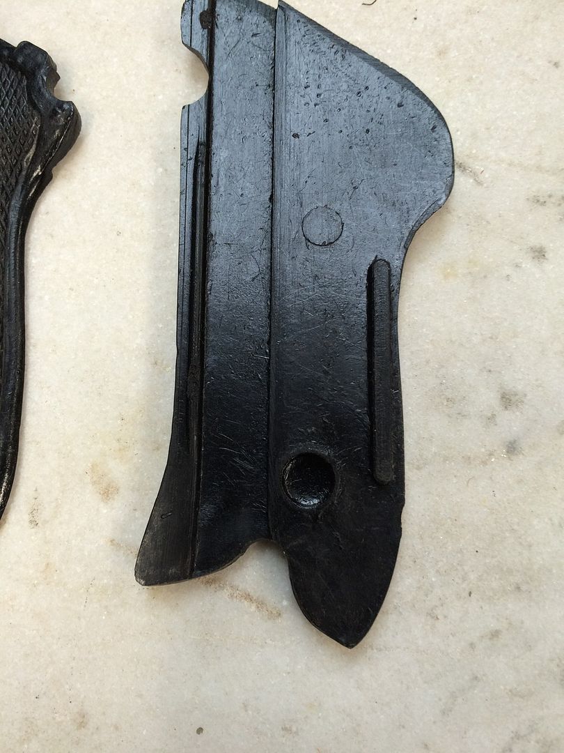

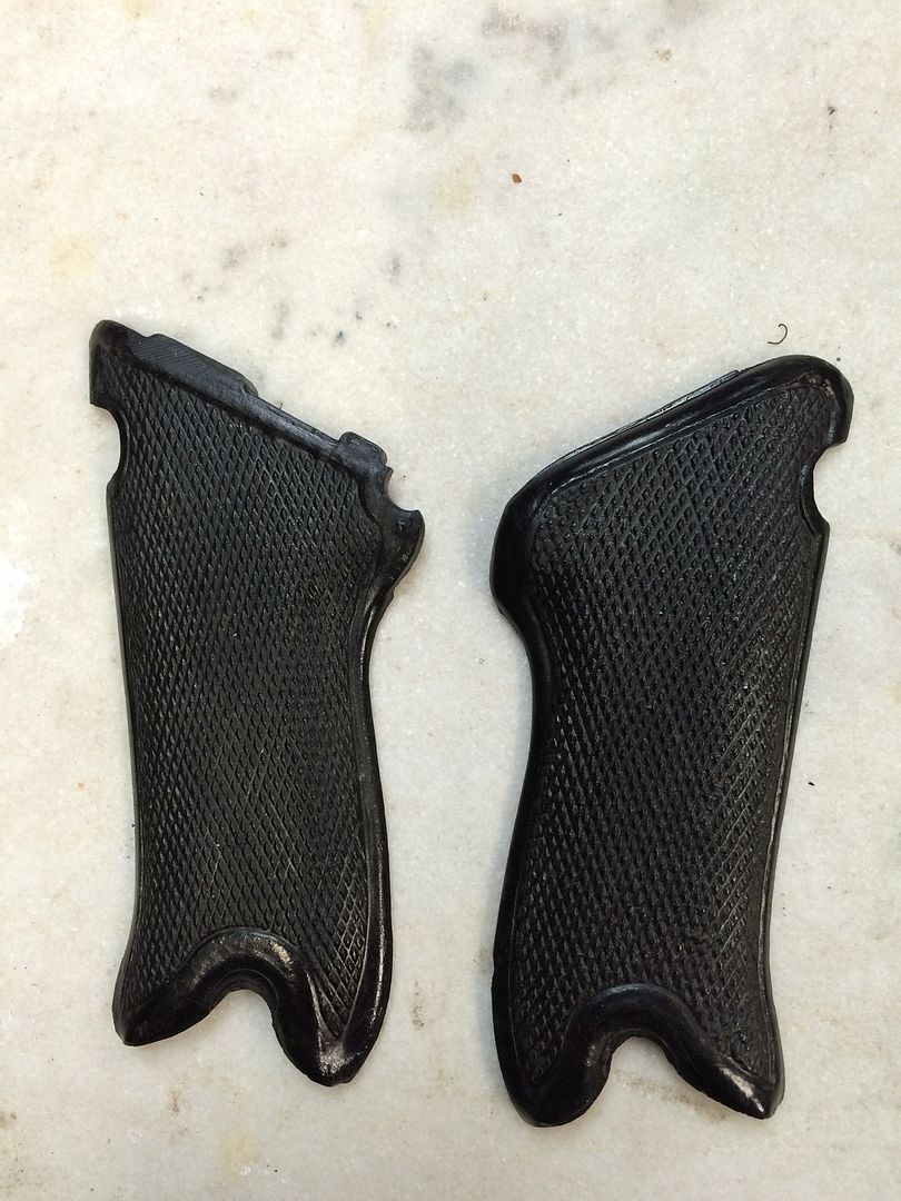

The story is I got these with a reblued/import 1916 DWM luger. If these are legit, and the original magazine it came with it looks like I nearly got the pistol for free.
I paid $475, and I was an ignorant buyer. I just saw a shooter quality Luger under the glass and new what ever it was, if it shot then I can't lose.
I bought it from a gun shop as a consignment sale, so I don't know who the seller was. In no way was I taking advantage of anyone, and the shop employees must have been oblivious themselves as well.

Looks like reproduction grips.
Unread 11-05-2015, 01:19 PM   #4
These are reproduction grips, not worth more than $20, or so.

I think the pics are uploaded now, thanks Rick, and welcome. Originals would have two holes on the back of each scale. These holes should be tapped with the same thread as the grip screws. Also, copies are usually made by casting molds from an existing pair of originals. This process, unless a pristine pair is copied, takes along all of the wear and tear and/or distortions of the example used. Your grips have one large hole each, and although I can't tell from the pic for sure, the fronts are also suspect.
Not to mention the "voids" clearly visible on the back of each grip,
originals are smooth, no bubbles in the plastic.
