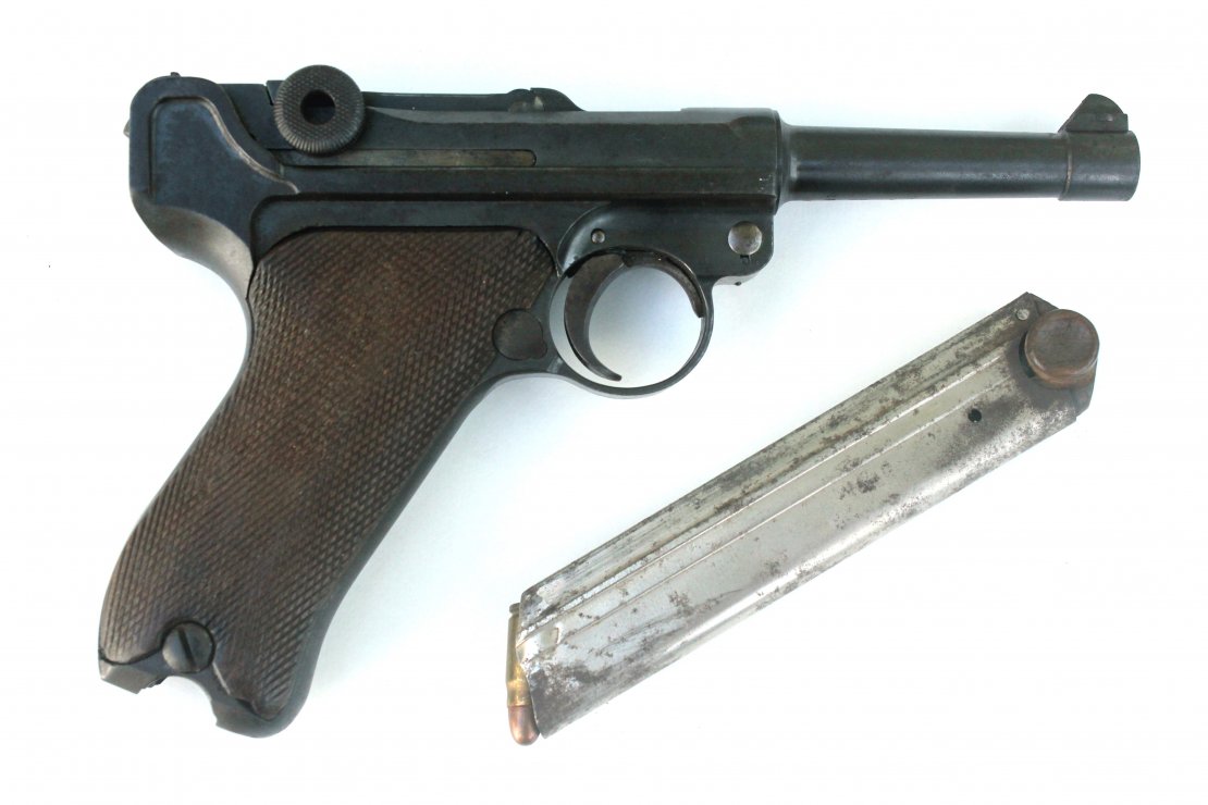

I recently inherited this Luger when my dad passed away. The family history is that my Italian father was a 16-7-year old partisan fighting in NE Italy. He "liberated" this pistol and hid it in a barn. In 1947, he immigrated to the US to make a new life. In the early 1960's, on one of his returns to Italy he brought it back in his luggage. It has been in a sock drawer since.
I am interested in finding out more about it, validate what I have discovered, it's market value and if the family history is plausible.
Here is what I know so far from on-line research and e-mail correspondence with some military collectors I know:
1920-22 Commercial P-08 Luger (possible)
Specifications:
• Manufacturer: DWM
• Vintage: 1920-1922 with early SN #2858
• Type: Autoloading service pistol
• Operation: Recoil operated (toggle action), striker fired
• Action: Single action
• Caliber: 7.65mm
• Magazine capacity: 7
• Barrel length: 4"
• Trigger pull: 2-1/4 lbs.
• Sights: Fixed; V-notch rear, dovetail mounted bead front
• Sight radius: 8-11/16" (22.2cm)
• Finish: blued steel
• Grips: 2-piece, Walnut, Checkered, Without a Border or Insignia
• Overall length: 8 1/4" (21cm)
• Height: 5-1/2" (13cm)
• Width: 1-1/2" (3.7cm)
• Weight: approx. 2 lbs. with empty magazine
• Country of origin: Germany
Additional Details and Markings:

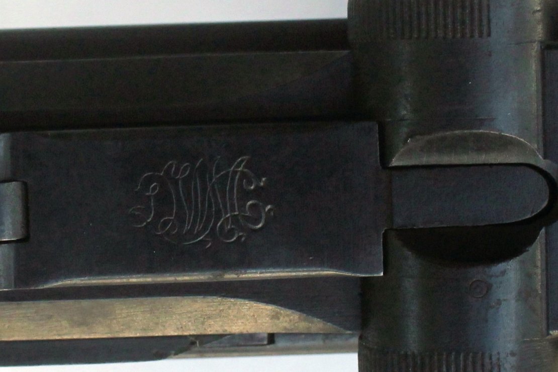

• Toggle Inscription: DWM (Manufacturer prior 1933)
• Chamber Inscription: Crown N
• Toggle Knob Type: Round and checkered
• Grip Safety: Not present
• Stock Lug: Not Present
• Thumb Safety: "Gesichert" in forward position.
• "Geladen" on chamber indicator exposed when round chambered.
• Magazine Bottom Plug: dark brown walnut. no markings.
• No manufacture year stamp (Commercial)

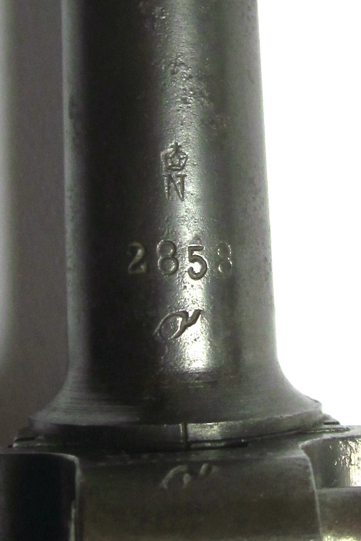

• Barrel proof: crown N, #2858, cursive letter either s, r or v.

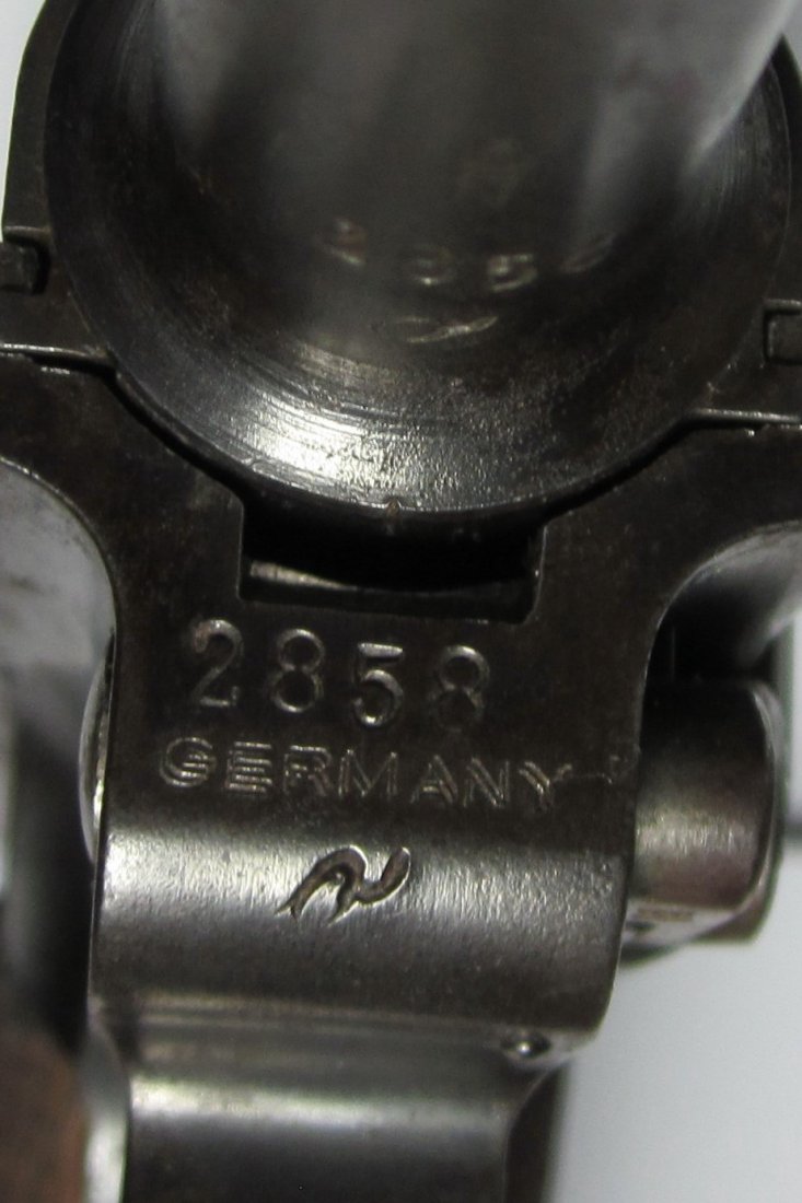

• Front piece: #2858, GERMANY, cursive letter possibly "o".
• Crown "N" located on receiver, barrel, chamber,
• # 58 located on all major parts
Condition: Good, but used condition. minor pitting and some surface rust. majority (60-75%) of bluing intact. Some barrel wear. Functional.
Contact Rich Filippi 850.832.7863. ramsgate01@gmail.com

Welcome to the forum, this is what I see.
You have a commercial model made in the late 1920's for the US market (German stamped was an exporter marking for the USA market), the letter on the front of the frame is part of the serial number.
In our book, we have 2858 but the suffix is 'u' (totally diff gun I know), but just funny to see)
The suffix looks like a 'O' to me - so it would be made around 1926-1927 in my opinion.

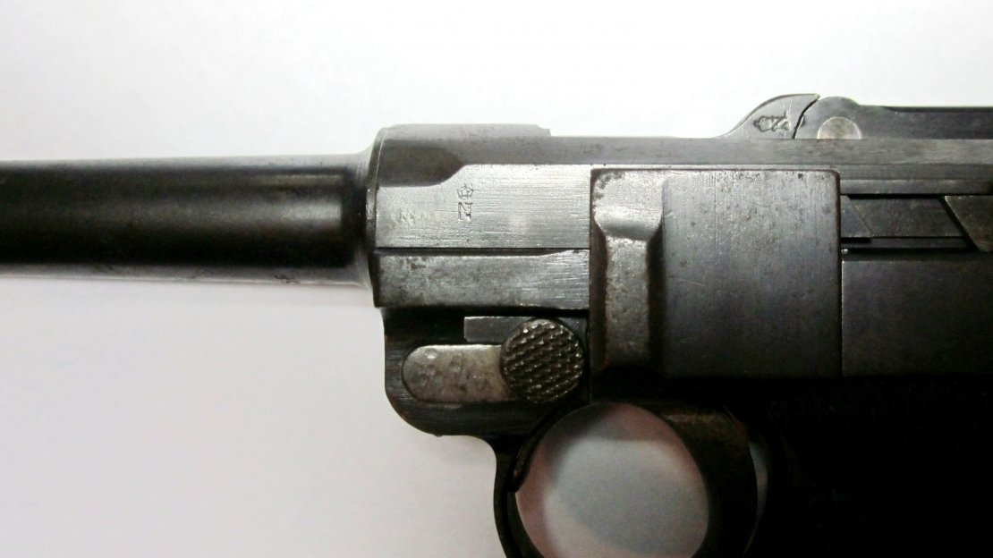

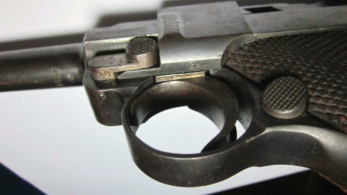

All the 'hidden' numbers should match the last two of the serial number, sideplate, takedown, several other parts...

With the GERMANY Marking it indicates this pistol was imported into an English speaking country..the USA in the mid 20's. Anything can and does happen but it could cast some doubt on Pop's story. A pistol such as this would be an unlikely pistol to be "liberated" in Italy.

It's difficult to be sure, but from the pictures it looks like this Luger may have been refinished. This is indicated by the lack of "halos" around the barrel stamped serial number, the dark blued pin that holds the toggle axle in and the general surface appearance. It's hard to judge finish, especially in flash photographs.
Your gun's full serial number is "2858o" including the suffix letter.
This variation is called a "DWM Alphabet Commercial" and was not used in military service. It was an export gun made in the mid 1920's (as indicated above) and was helping earn the Lowe group conglomerate some much needed foreign funds during a very difficult period of post WW-I inflation.
Today, these are not valued as highly as military Lugers. If in very high % original finish, they are worth about $900-$1,000. If refinished, perhaps $600.

I personally wouldn't be quite so hard on it regarding a possible refinish. IF it was, it was done a LONG time ago, and done right, not all buffed up and salt blued.
To me it looks like a nice old gun with a great story to tell. But then I'm a sucker for a touch of patina.
I'd say $800-$1000 range. But priceless to your family, regardless.

Germany marked guns were FOR the USA market, does not mean they didn't get sold to Mexico or Canada, but it was a USA requirement (1883? Dwight knows)

An overlooked item in the owner's detailed description is of importance:
NO stock lug.
If this was ground off, it lends credence to the pistol being refinished and would materially affect the value.
