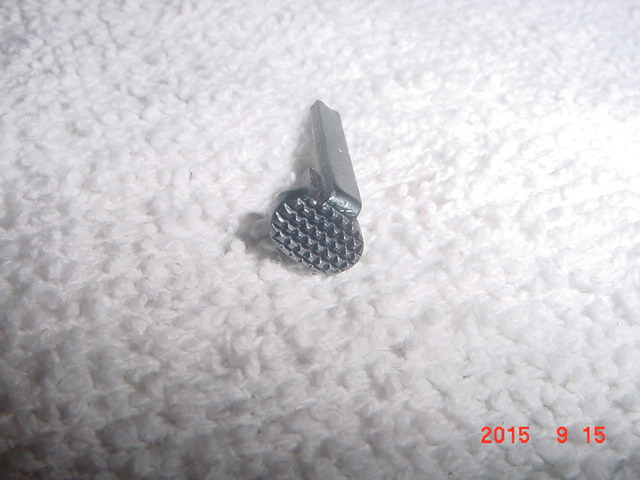

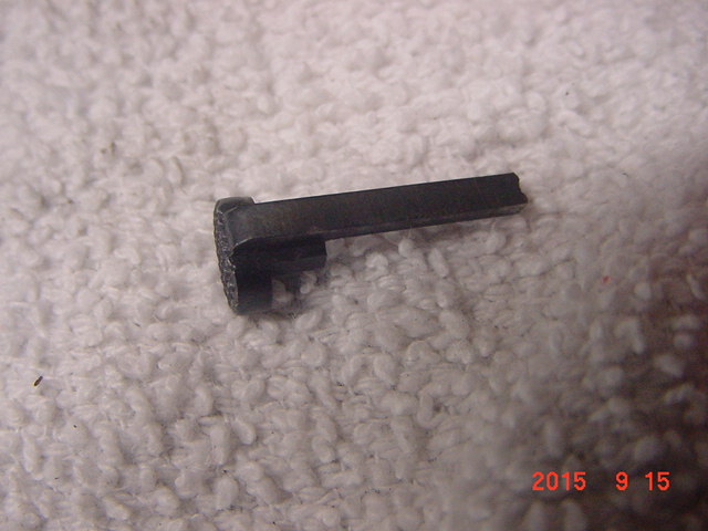

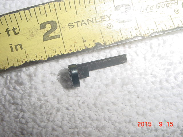

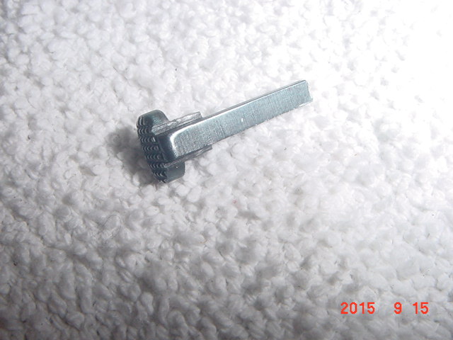

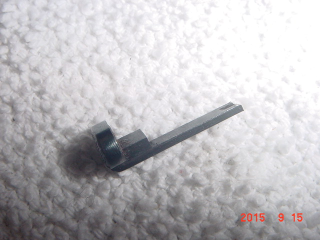

Shooting the C96 red 9 broom (mismatched, reblued, etc.) a bit yesterday and noticed a part on the bench that hadn't been there before. Turns out to be the release button that frees the rear sight adjuster block so that it can slide fore and aft, raising and lowering the rear sight. I have no idea the correct term, so I'll call it the rear sight release button.
Anyway, I need a new one and also a quick tutorial on installation.
Thanks for you advise, support, leads, etc.

You have to take the sight off the gun to replace that button. It comes off like many other sights of this type: You press it down and slide it backwards. With the sight off, you can take the slider off and replace the button. I would think that you'll find the rear half of the button and the spring captured inside the slider, still engaging the slots in the sight. You will probably have to pry on them a bit to make it possible to take the slider off.
EDIT: I take that back. The spring will not be there, it's located right behind the button so it must have fallen out together with this.
Unread 09-15-2015, 09:24 PM   #5
Olle answered the question. Take the sight leaf off the gun, remove the sight slide, install a new button and a new button spring, put the slide back on leaf, put the leaf back on the gun.

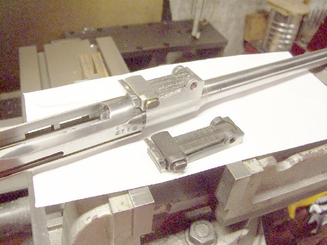

Occasionally you'll see an original C96 sight for sale on eBay...This one came all the way from Argentina...
What is it attached to...one of your own mounts? Looks like the block is something that would be bolted or soldered to the gun.
Confusing pictures deleted!
There's enough confusion on this forum!
Hey, this ain't Area 51, so what was that thing in the picture? A block for an Artillery Luger?
Unread 09-18-2015, 07:25 PM   #12
Well, it could be, if you made your own 'artillery' (or carbine) barrel...Like I did...
It's an actual C96 rear sight assembly with a milled-flat receiver mount. I cut it off a surplus receiver, thinking I would keep it for a spare in case either of my two Mausers broke a sight. But I doubt if I will ever shoot either of them again, and I'm going with the Mauser carbine sight on my long-barrel [top of pic] so this will just collect dust in a drawer until my niece throws it away...
