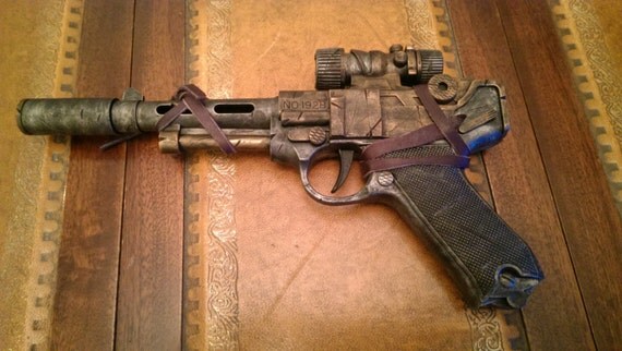

Reanimated - bring back from the death
https://img1.etsystatic.com/052/0/70...27679_2rkh.jpg

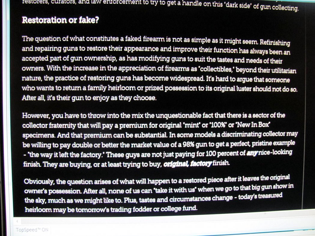

I found a great article on the subject~~ Here is just a part of their article~http://www.nramuseum.org/gun-info-research/fake!.aspx
