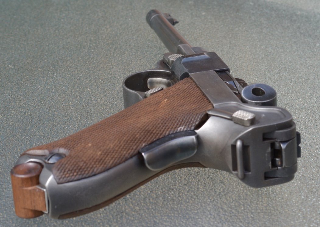

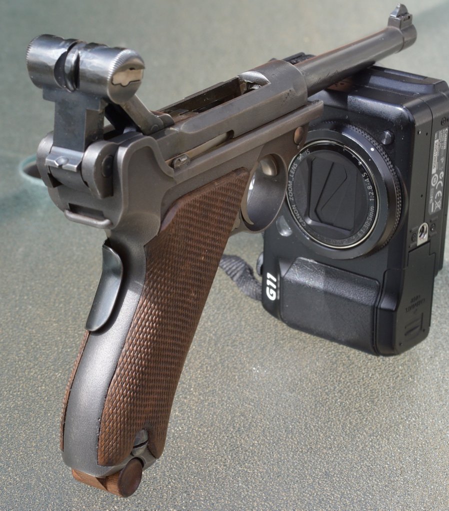

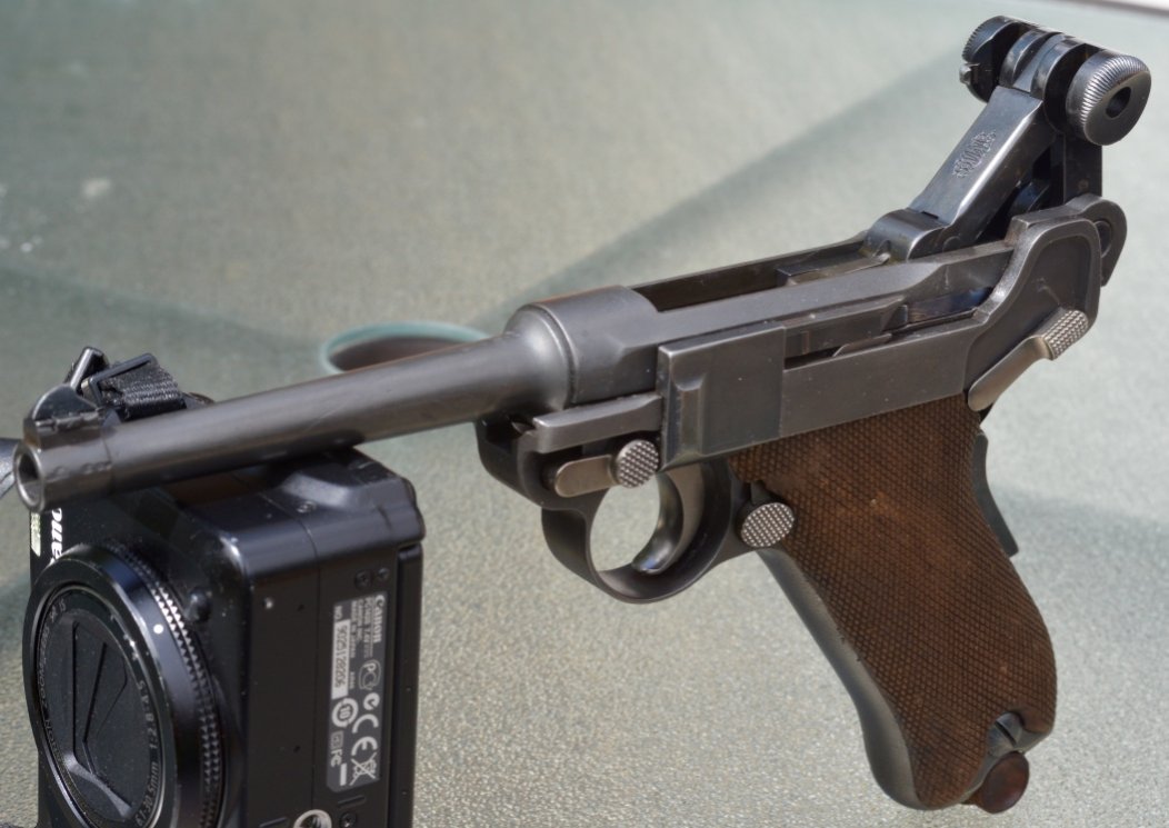

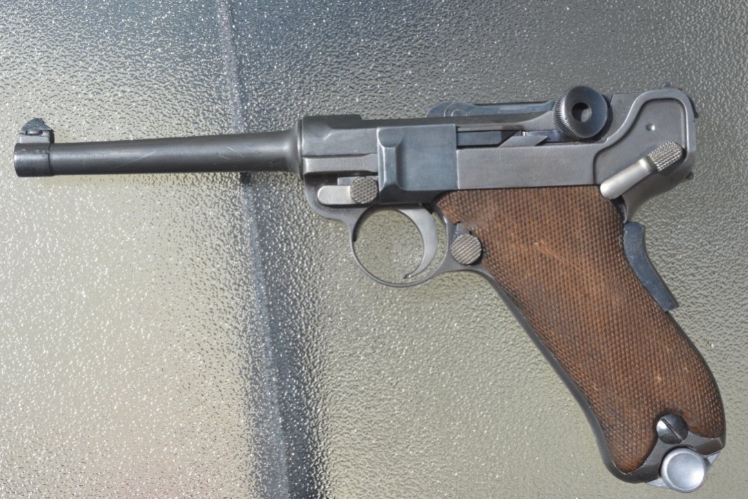

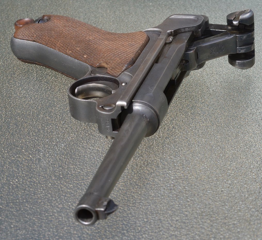

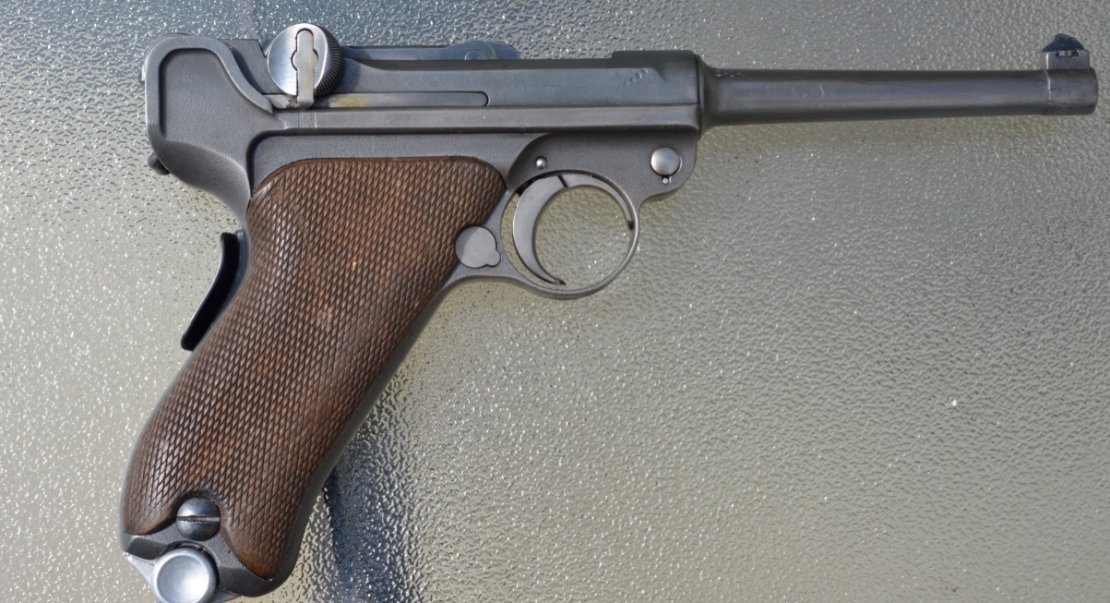

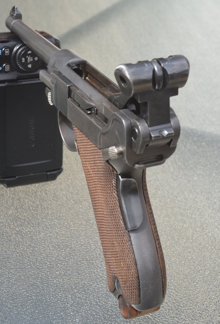

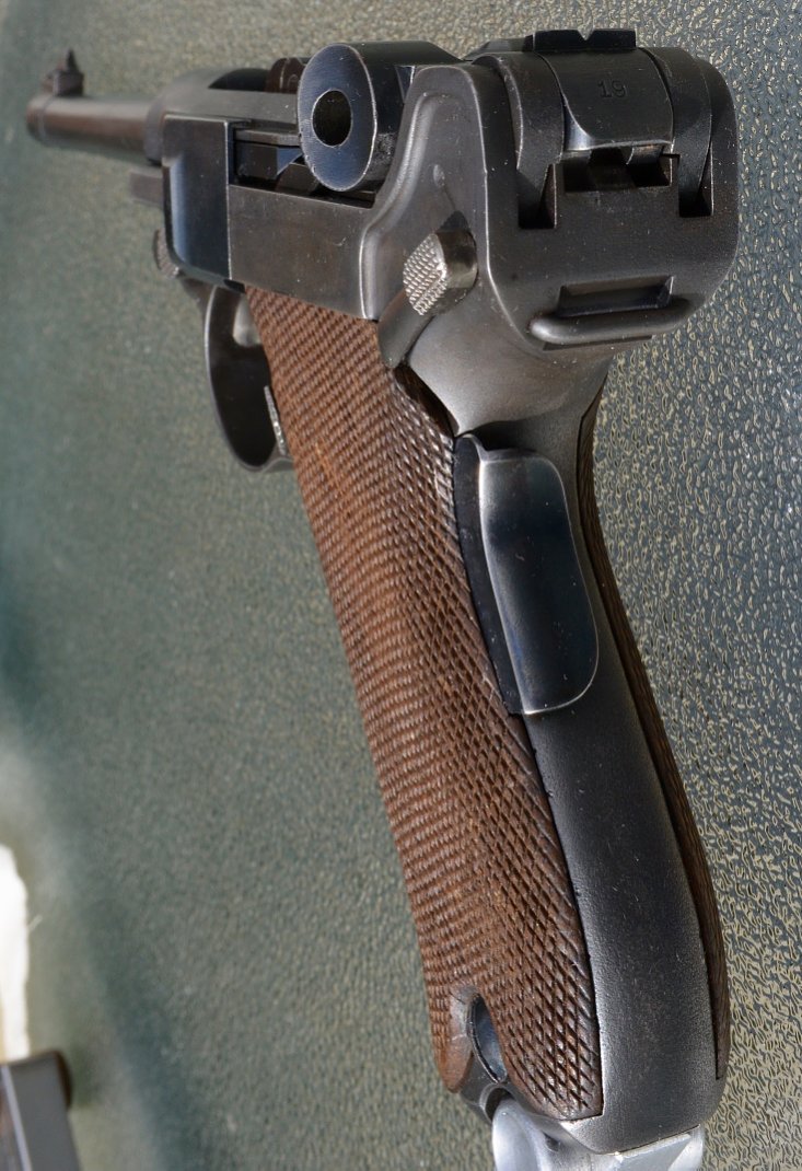

I just received this 1900 model and thought I would post some pictures, and I had a few questions I'm hoping someone can help with.
First the pistol - I purchased this from forum member Markbritt (Mark). It's a 1900 AE, all matching but refinished by Mark (not restored). By "all matching" I mean barrel (very faint but the serial #9419 is there), frame, trigger, grips, take-down, receiver, all three toggle pieces, and grip safety. The pistol has made the rounds, as it is in Dwight's database with a note that the pistol is in "extremely poor condition - offered as a parts gun". It is a very worn, refinished surface, and can't imagine how it must have looked before Mark refinished it.
My guess is the pistol went through several refinishes over its life; the metal has been taken down to where the American Eagle stamping is as faint as it can be yet you can still detect it. I cleaned it up, fired about 25 rounds, cleaned it some more and gave it a coat of Renaissance Wax. Cleaning included brushing the grips with Acetone using a fine but stiff artist's paintbrush purchased for the purpose.
The only function issue was a sticky hold-open. The hold-open is not original to the pistol, but is a numbered replacement. I reduced and polished the side of the hold-open where there appeared to be friction, which fixed it.

1. The front sight is loose as it sits atop its ramp. It is so loose, it can be pushed off the ramp with a finger. Is there a best way to fix this? I was thinking LockTite?
2. The pistol shoots high at ten yards, about 15" high which amazed me because the group was reasonable - about 5" diameter (about what I get with my '38 Mauser 'shooter'). I would rate the bore as fair to good, good rifling with no pitting although there is some darkness and roughness in the grooves in some places. I don't see anything about the bore that could be throwing the rounds high. By that I mean, it doesn't seem bent or to have anything odd going on near the muzzle.
The only thing I can imagine to fix this is a custom taller front sight, but would appreciate any comments or ideas.

I suspect that you have a standard P08 front sight insert, whereas the 1900's used a taller sight blade, thus yours shoots high. Let's let others weigh in on that, but yours just looks low to me.

David thanks, after ready your post I inspected/measured. It seems to be the same height as a Mauser P. 08 front sight but the shape appears correct for a 1900 model, based on a check of Dave's 1900 Commercial and looking at the Simpson site.

OK, you 1900 guys: Is the front sight on the orig. 1900's taller than the standard P08 sight blades?

On the front sight, believe it or not Sarco claims to have three different 1900 model sights in stock, at 6.1mm, 6.77mm and 7.0mm height. I'm inclined to get the 7.0mm unless someone advises differently. They also have a surprisingly large inventory of other 1900 parts on hand.

If your Luger is sitting on your Canon G11, what are you taking pics with???

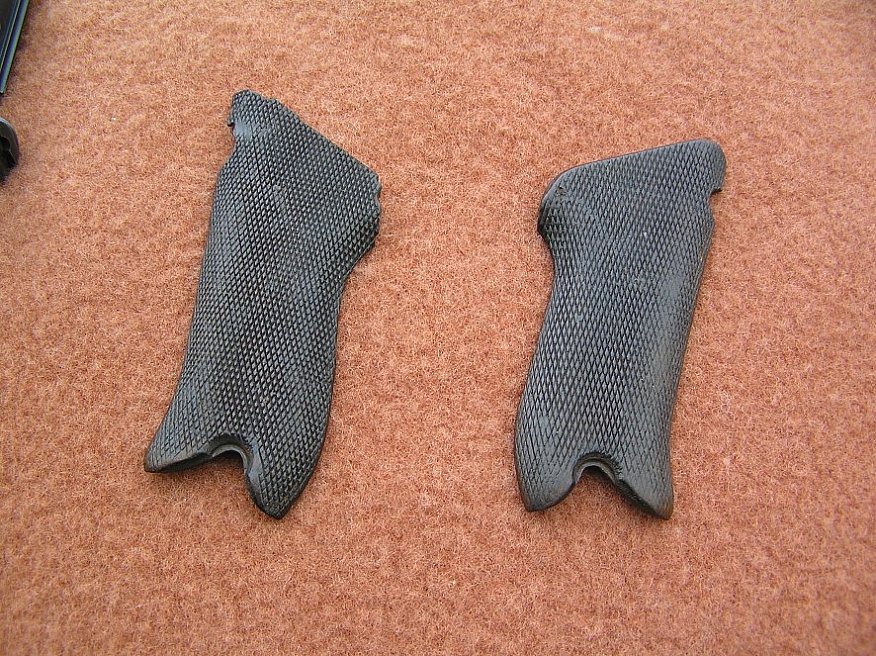

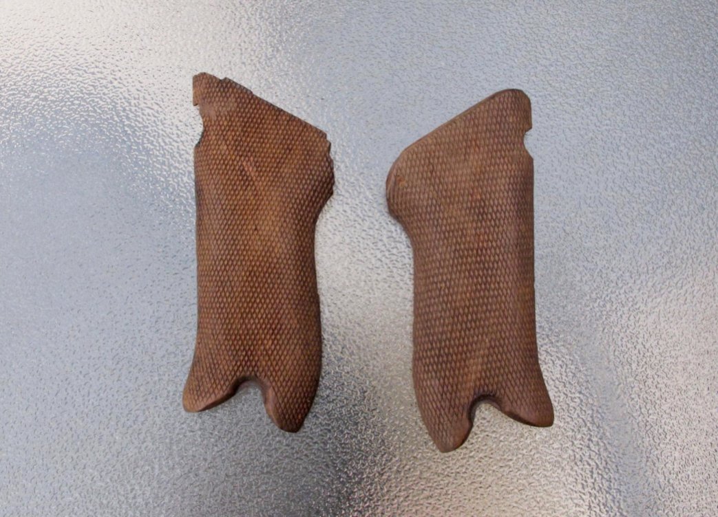

I have done a fair amount of research on grip restoration and have some woodworking background. In my opinion, acetone is the best solution to remove accumulated material on grips. It does not harm the wood it only removes non-wood material.
I do not recommend a toothbrush, those are too stiff and corse. Rather a fine-bristled, medium-stiff artist brush about 1/2" wide, available in any better art store. Per the microscope, most of the dark foreign material is in the grooves, and toothbrush bristles are simply too thick reach the base of checkering grooves. And they are a little too stiff in my opinion, with a toothbrush there is a slightly increased chance of damaging the checkering.
I pour acetone into a glass baking pan, about 1/4", and gently brush along the two checkering directions. Typically I change the bath several times, as it gets discolored. I am 100% sure (via microscope) that I remove grime without harming wood. I work fast - a minute or two per grip. You know you are done when brushing/rinsing stops darkening the acetone. Be sure to do it outdoor or with a respirator.
I know some collectors like to treat cleaned grips with boiled linseed oil and similar. With respect, I completely disagree. The oldest wood in the world (over 7,000 years old) got that way by being kept dry, cool and out of the sun. Oil and other foreign emulsions accelerate wood deterioration, based on my research which includes looking at some Smithsonian wood preservation papers.
I did some additional cleaning today, removing some stubborn junk using a #11 Xacto knife and the 'scope. I then used a very small amount of walnut penetrating resin stain to re-darken the tiny light areas caused by scraping off junk. I applied the stain with the point of a pin, again using the microscope. Here's a before and after.
Nikon D800. I was experimenting to try and obtain high depth of field and the Nikon was producing better results.

FYI, My 1900 shooter required a taller front sight that I made from a '96 Swedish Mauser sight. It measures about .025 from the sight base or about 6.5 mm. I suggest getting the tallest sight from Sarco and filing it down as needed.
