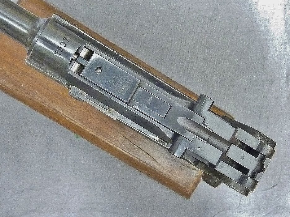

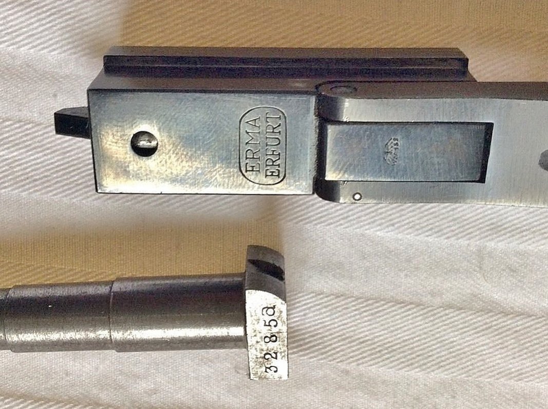

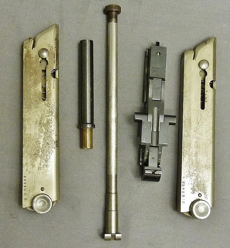

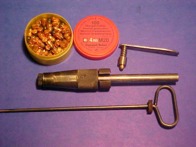

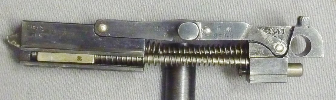

Here is my new "toy", just got it this week and have not had a chance to try it out yet.
Best I can tell from reading it dates to about 1934.
No box, but two 5rnd. magazines!
One magazine is numbered to the toggle assembly; the other to the barrel number- so I have part of two original kits.
Anyone have an empty box? Or a spare barrel nut, as it should have two?
Also shown installed in my shooter 1937 upper on my basket case
1906 lower, which is functional using "borrowed' parts from another of my Lugers.
Still need an upper for it, but did buy a 6' Navy barrel today!

You may find it necessary to remove the ejector on the receiver that you are using.
Unread 07-12-2015, 10:23 AM   #3
You are correct, the barrel is impossible to insert without removal
of the original ejector.
Unread 07-12-2015, 12:36 PM   #4

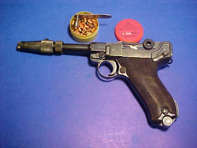

Do you have all the parts??? I seem to recall a 'centering cone' going between the nut and the muzzle...Your pic looks like it is missing (lots of thread showing)...
This is a pic of the commercial kit...I don't recall if the 'centering cone' was threaded as well as the retaining nut...
There is a parts breakdown of the wartime kit posted here somewhere too, but this was the one I knew I could find...
Yes, I have all the parts, well except one muzzle nut,
that is why more thread is showing, supposed to have two as shown in your post.
The centering busing is part of the barrel extension that goes between the barrel and the nuts. You can see it as the brass bushing on the extension in my picture.
The length of my barrel is longer than the commercial one, hence a longer extension.
The original kit is in Vol. III of Sturgess.

Part # 8903 is the part that centers part #8901 into part #8902 then the lock washer and part #8901 holds it all together.
If you look at my post and the picture of my pieces,
you will see that they are of the earlier type and not made this way!
The brass taper bushing at the end of the barrel extension in my kit is what centers the barrel in the extension.
Thanks for the help, but the designs of these two are different.
Unread 07-12-2015, 02:48 PM   #8

Thanks guys for all the help, info and ideas.
But the old model works just fine as is, being substantially different from the "Modified and Improved Erma "SE 08/2" model of 1990.
While I have yet to fire it, dry cycling loads and ejects just fine.
Why-
The early sub cal adaptors eject on the "horns" of the magazine, at least that is what they are called in Sturgess' book. If you have access, it is on page-1612, where differences in the old and improved SE 08/02 are detailed. The magazine was substantially changed, and a separate ejector added.
The old kit does not use the conical nut nor the washer either, but rather a brass bushing on one end of the extension- see the picture I posted. But it does use two nuts which serve to "jam" so as to prevent unscrewing. The "end" nut is flat on one side and rounded on the other, and a little oval shaped when viewed from the side, and a little longer than the one I have in my photo, to protect the end of the insert barrel.
I will find or make another nut, best I can measure it is 8mm x 0.5 pitch, or maybe 0.75 pitch.
Will try it out Tuesday, and know for sure.

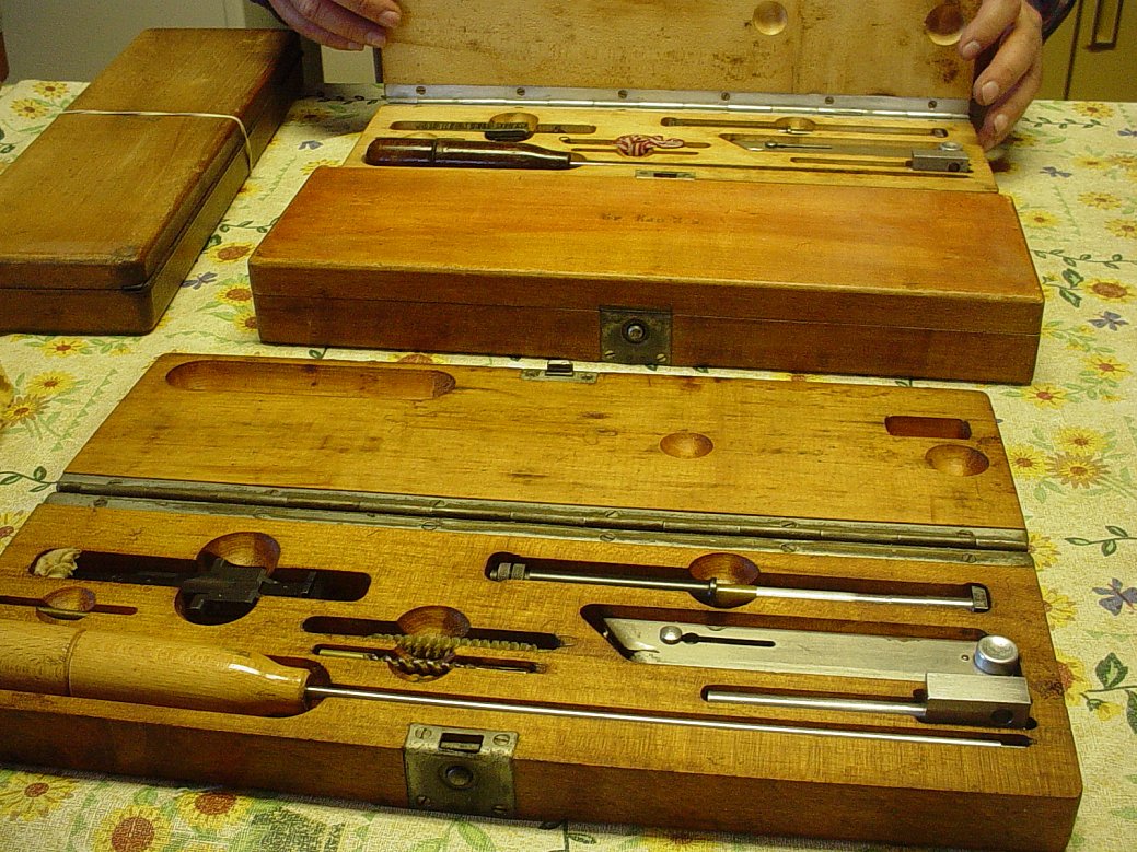

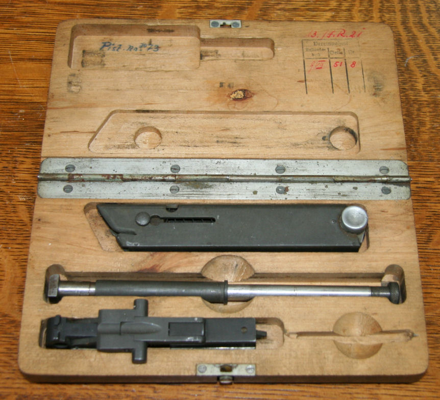

A friend of mine has an early kit in the long box with all the goodies, except the wood handled cleaning rod.
I doubt anyone has a spare for sale- but thought I'd ask. I'm going to make him one to fill up the empty space in the box. The Erma guys were so thoughtful in designing the box, they even put in a cut out to hold the original pistol ejector so it would not get lost! and the original toggle is suppose to fit in the space for the .22 toggle, as is the magazine in the magazine space.
I'll get a picture of his kit in box next time I see it, to post here.

Yes, I would like to see the box, just might want to make one up..............

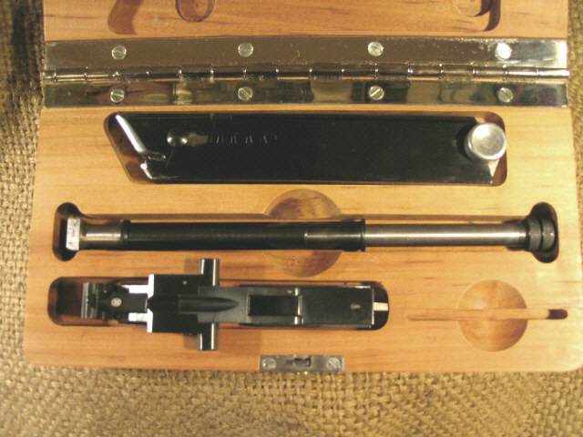

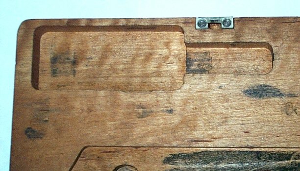

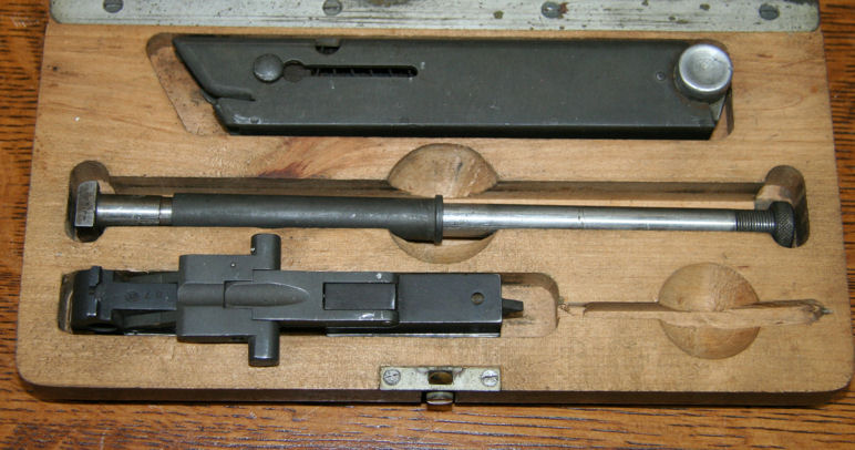

Unread 07-12-2015, 11:44 PM   #14
Here are some box pictures I have collected;
The following 4 members says Thank You to Edward Tinker for your post:
Unread 07-13-2015, 01:19 AM   #15
Yes, a small box seems quite do-able!
Thanks for the pictures!
