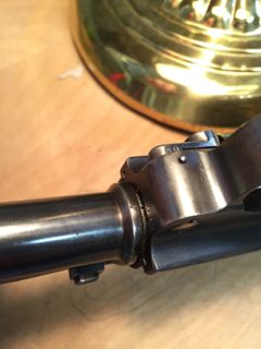

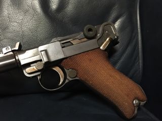

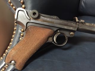

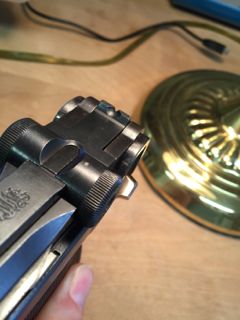

Hello everyone and thanks for the forum and all of your intelligent contributions. I have been gleaning some great stuff here. I wanted to ask if someone could tell me what I have here. I bought it because I like oddballs and this fit the bill. I also have a very modest collection of Lugers so this is hopefully my crown jewel. It appears to be in very good condition and is a .30 caliber.
I will describe it and try to post pictures as well.

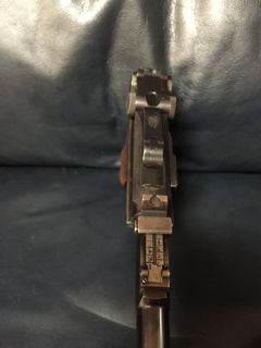

The frame has a stock lug pistol grip, 5 digit serial number with no letter, matching numbered on the bottom of the takedown lever, plate, and toggle behind rear sight. There is a crown/N on the toggle as well as a DWM inscription. There is no date on the frame or any other markings. The barrel is unmarked and the rear sight is graduated from 1 to 8. The front blade sight appears to be an artillery type.
Unfortunately, the barrel is canted about 1mm and there are marks on the barrel where it appears someone has tried to turn it. I was also wondering If there is anyone on the board that could fix this for me. I would love to shoot this bad boy!
If anyone could give me their opinion as to the originality of the barrel and finish or knows some history of this oddball, I would greatly appreciate it.
Thank you all very much! Adam

Congratulations, you have reached the top of the Luger odd-ball world!
But seriously, there are several forum members doing the heavy 'smithing (G. T. LugerDoc), and I believe that you will be hearing from them soon.
I suspect that the barrel will need to come off first, assuming that it needs to go tighter, rather than looser.
This gun looks like fun.

Adam. You have what I would call a 1920s long barrelled commerical luger. Most of these that i have seen, have an unnumbered barrel and unique (elevator button pushed from right side) tangent rear sight assy. Both Stoeger & Pacific Arms Corp offered these add on long barrels from 10" to 24" in either 9mm or 7.65mmP. See Lugers at Random pages 186 & 187. TH

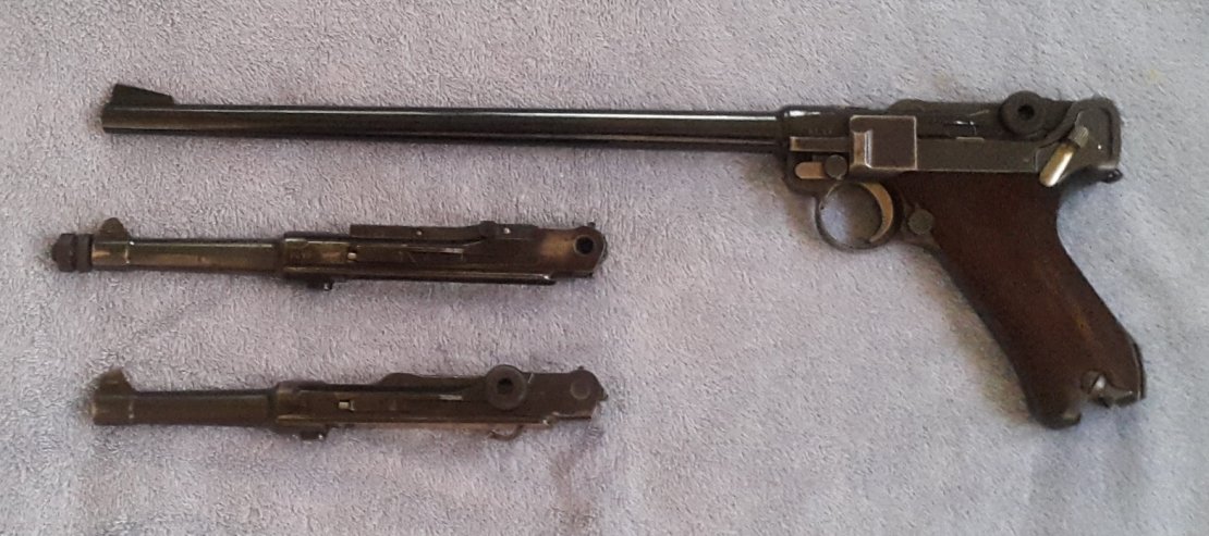

John you state "My only caution is that you should NOT attach a shoulder stock, as that would be illegal as a Short Barreled Rifle (SBR) (since the barrel is under 16 inches)... unless you pre-register the gun with the BATFE and pay the $200 tax stamp in advance for making an SBR ...
As long as I don't attach the shoulder board, it is legal to shoot? I have a 9mm 12" barrel that I have attached to a lower that I also attach a receiver for a .22 cal and a 30 luger receiver to. Will attach my set-up:

When you look down the barrel, is the front sight canted before or after the 12:00 o'clock position???
It appears to be only off a degree or two; if too far after 12:00 o'clock, the shoulder could be stippled to adjust the interference fit. If before, a bit of polishing or rubbing compound could possibly remove enough to make it fit correctly.
Easy fix. I would be more concerned with the surface where someone attempted to 'fix' it themselves.

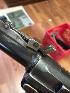

Like the LAR long-barreled 1920, yours also has the toggle rear sight as well as the artillery barrel rear sight. Does the toggle rear sight have a V notch? Can you tell if the barrel rear sight base is integral or soldered on? Kenyon comments on both styles.
Interesting. Might even be original DWM barrel. Looks like fun.
Perfectly legal to shoot this gun as a pistol, regardless of caliber or the barrel length. You tempt the federal law enforcers if you should "create" or "make" a SBR that is not registered. That would be a violation of the National Firearms Act of 1934, UNLESS you have paid the $200 tax.
You have something that is fairly unique. If it were mine, I would pay the tax, obtain a period and appropriate shoulder stock and increase it's uniqueness... Enjoy!

Sheepherder, the barrel is canted about 2 degrees to the right as you look down the barrel. I have attached a picture of the marks left by someone messing with it previously. I do not have any suitable gun smithing tools to tackle this job myself and would be afraid of screwing it up more if I did. The rear sight is fitted in a dove tail groove on the barrel and I do not see any sign of soldering. It would be great if we could determine if this was an original DWM barrel too. Thanks again.

Lugerdoc - The rear sight is exactly as you have described. It is good to know that this may have been deliberately put together and is an authentic "variation" rather than a one off constructed by a garage gunsmith. Unfortunately, I do not have Lugers at Random in the library yet but will try to reference that book. Do you do this type of work to fix these problems? I would be afraid to take it to just any gunsmith in my area.

There are several ways to correct this, none of them difficult. Gerry Tomek/Olle Fornehad have the skills + tools. They might be interested.

Since the barrel is slightly twisted, does the extractor fit in the barrel notch? To correct the twist might require some machine work, beyond just rotating the barrel. I'm also working on a 'Black Forest Carbine', but I have a 16 1/2" barrel, so no SBR cert needed. Then there is always the issue of adding a forend below the barrel and attachment to the frame, without paying thousands. Although carbine stocks, other than the flat military style, have been selling for thousands on the auction sites. I think the least expensive way may be to buy a stock attachment for about 1-2 hundred, and then an old wooden stock and machine the stock for the fitting.

Sheepherder - Thanks for your comments, the pipe wrench is definitely a bummer. You are also correct in they the barrel sleeve is integral with the barrel. Perhaps someone on the board would take a crack at this job. I do have a C&R license so the pistol could be shipped quite easily. I did look at your sticky post on removing barrels... very informative.

On those damaged spots, you may be able to carefully file down just the high spots caused by the wrench, and then touch the filed spots up with some cold bluing.
But Diver asks a good question: how does the extractor fit now with the barrel canted and what will it take to fit it once the barrel is uncanted?

I took a look at the extractor and it fits in the chamber potion of the barrel just fine. I can clearly see where the barrel could be turned just a mm or less counter clockwise and it would be in straight alignment with the frame. I have not checked the headspace however. I could live with the pipe wrench marks but the canted sights I think will drive me crazy. If I could have the barrel turned to remove the marks that would be great if I did not have to re-blue the whole barrel. Are the barrels on the Luger right hand threaded?

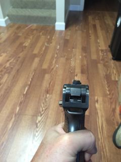

There is a photo of the current sight picture.
