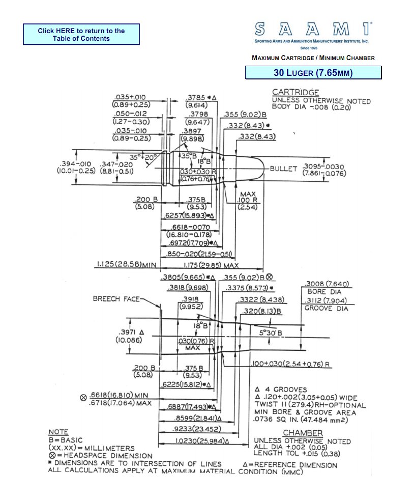

As the .30 Luger shooters know, Fiocchi is about the only semi-affordable game in town. I have however noticed a couple of undesirable quirks about it though. I'm just starting to reload it in quantity, and preparing brass, I discovered over 75% of my Fiocchi cases have the flash hole drilled way off center. I had to run my decapping pin slightly loose in the die to keep from breaking or bending it....Winchester cases were no problem. Also, factory Fiocchi ammo is WAY short on cartridge headspace. .30 Luger should measure .662 at a .355 datum point to the shoulder....my Fiocchi averages .642, a full .020 short. Winchester is a bit better, averaging .653. Fired cases from my 1900 show .671 chamber headspace.

Hi,
Your drawing of the cartridge, is it the original DWM drawing, or, a newer one?
Many modern pistols are chambered for the 7.65 Luger, particularly in Europe.
One would think that they headspace on the datum line, but is this true with the 7.65 Luger?
Sieger

NO, Sieg, it's from the Lee reloading manual....I'm assuming its correct, but can't be totally sure....their dimensions from other cartridges that I'm more familiar working with do correspond to other sources though.

As already noted, the Euro specs are not the same as SAAMI specs...But unfortunately, RCBS, Lee, Pacific, and Clymer all make their products to SAAMI specs...So we're stuck with them...

Actually, my Lyman dies resize fired brass to .660, so thats ok.

I chucked my RCBS sizing die up in a lathe and did a bit of "tuning" on the base so it would set the shoulder back just a bit more. My reloads now measure 0.670 in. and I am fine with that. My reloads function well in all of my 30 Luger barrels.
