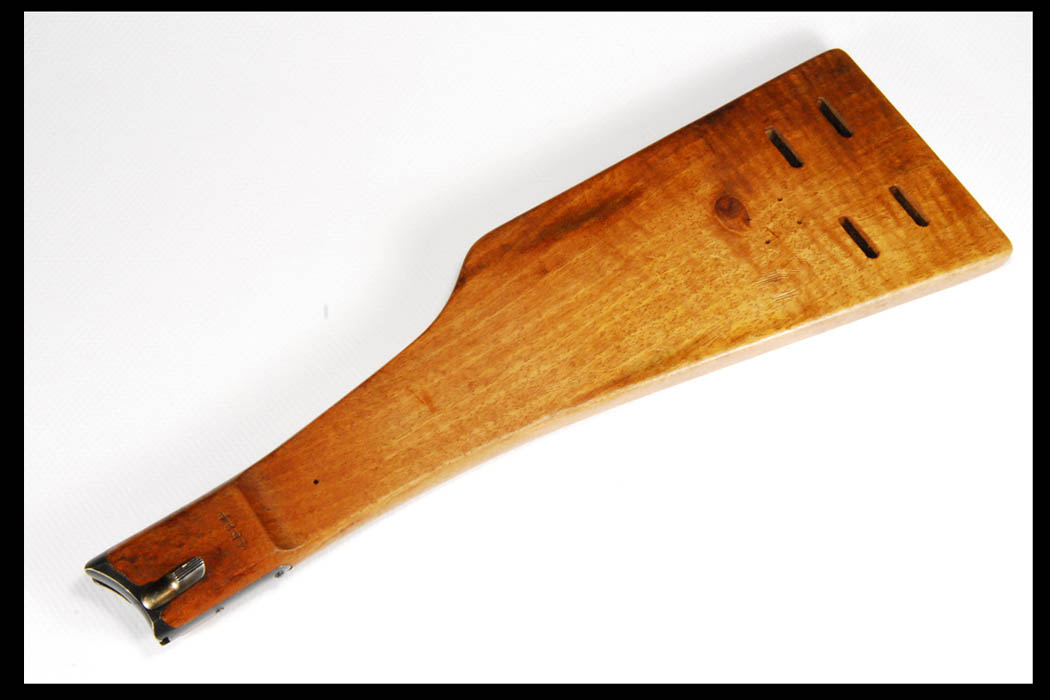

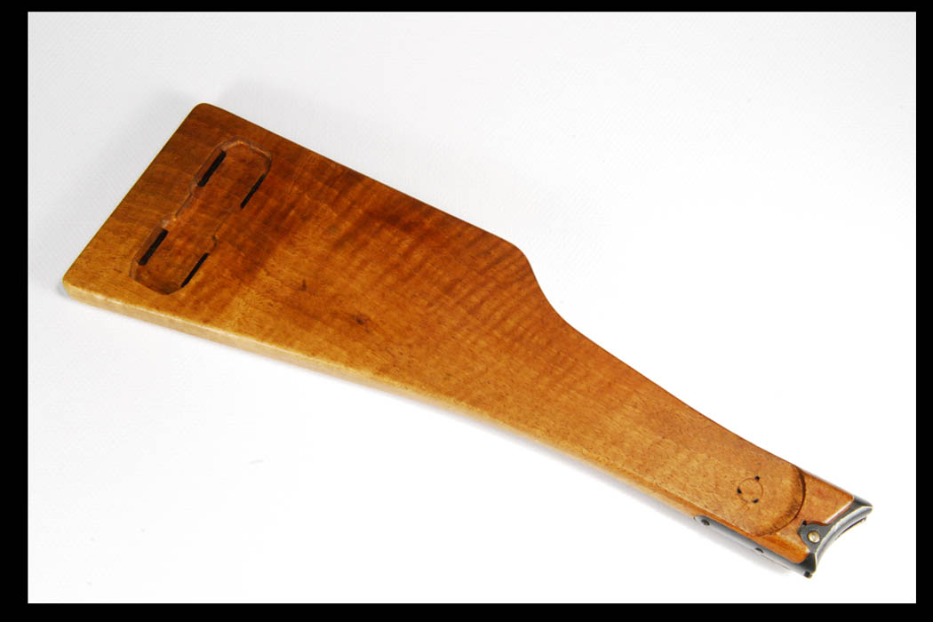

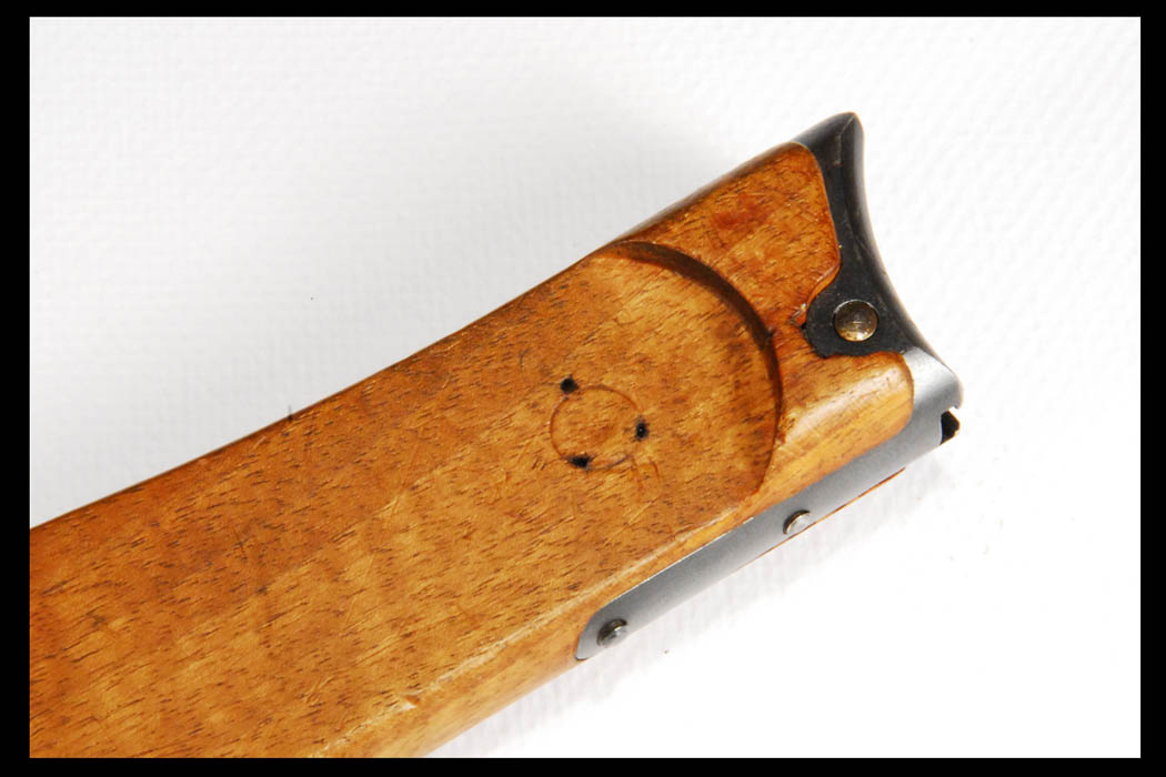

Hello, I recently purchased this stock from a dealer you all know and love. I trust him to have my best interests at heart. While I don't get screaming deals from him I feel that I get my moneys worth. Please speculate on the possible history of this piece. The stock has NO further markings, however I would like an opinion about the circular mark with the 3 punctures on the right side behind the iron. The holster mount holes have not been used to mount leather. I paid $725 Thank You in advance!! Joe

Joe, These strange stocks pop up frequently. Pretty wood..Has the honey color of European walnut. I like the grain & the knot...The wood to metal fit is good. Has some patina. The strap slots are not beveled..Correct.

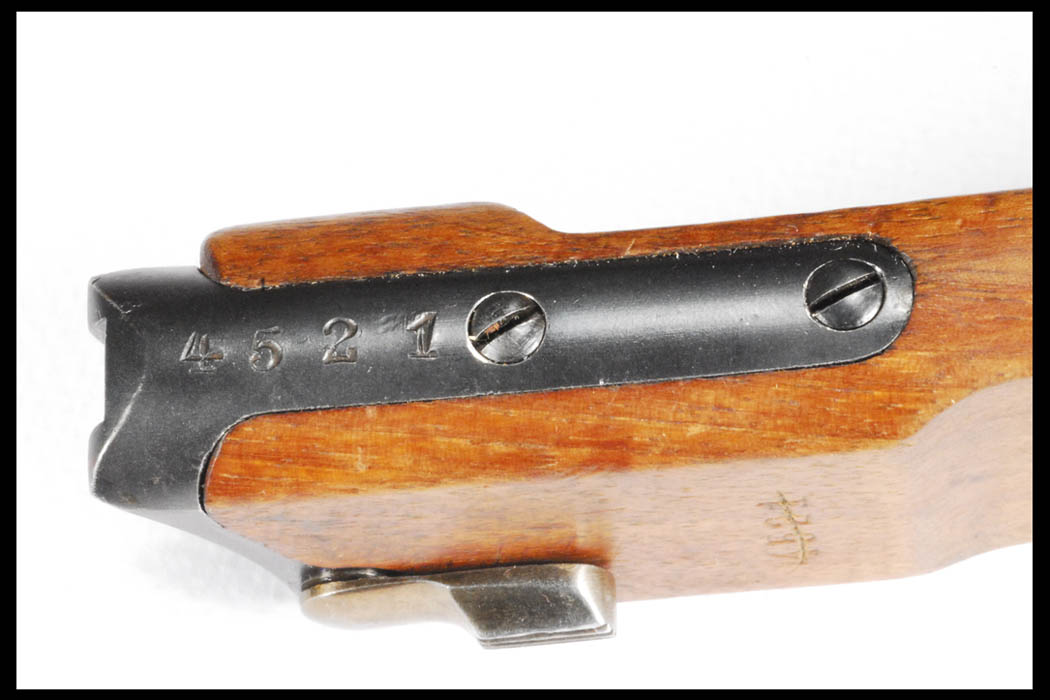

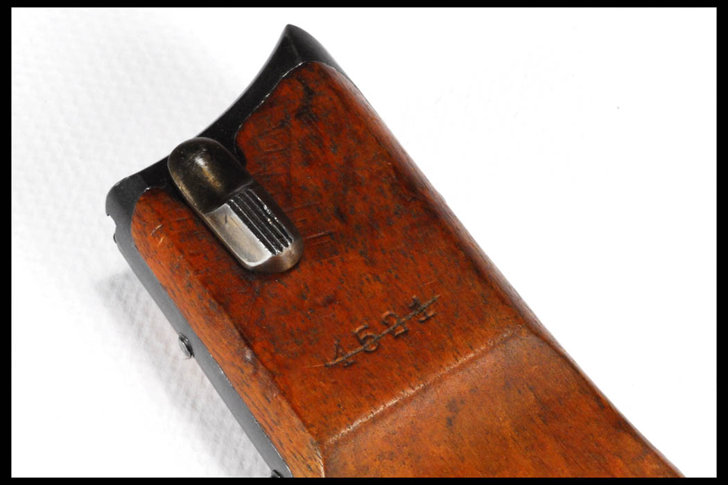

I don't like the serial #..too large and running linier to the iron. I don't like it on the wood either. The locking lever is smooth on one half of it? That's weird. The circular mark with 3 holes..that's unexplainable. I have looked at my share of stocks and have never seen anything like that.
It's my belief that these may have been leftovers from WW1 and were not Imperial accepted military's.
Have you looked into the stock block well and on the butt for any markings? I have one that is marked Germany in the side edges of the stock block well. Well hidden!
As far as price...One just like it recently went off on Ebay for around $350.
I collect military stocks and am not interested in those that do not have the Crown S-D etc. This one appears to be a period piece, just not a military. That being said..I believe some 1918 stocks may have slipped thru without the acceptance mark. Could be the pile that was sitting on the factory floor at the end of the war were not stamped as there was no Imperial anything left. Just hard to say.

I guess they call it NORWEGIAN wood. If I were to speculate about the circular mark, I would say that it looks like the mark you see on the end of OLD chair or table legs that lost the metal button they put there to prevent damage. The Finns are known to have used these stocks with 4" PO-8s for some time after WW I. Could they have attached a standard type PO-8 holster to this stock using a similar style button some how ?? Thanx Jerry! Joe

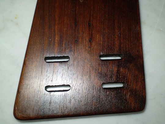

Another example of wood stamped stock.
This is different from the one we discussed previously.
Here some more pics of my wood stamped stock, it seems in any case old.

Looking at Baudino's photo, I feel quite confident that the placement and style of the serial #s on mine and the example in the photo are a decent enough match to prove provenance. Since the 1923 Finnish purchase of LP08 stocks was for 5000 units, Mine having a serial # 4521 would definitely put it into this block if the Finn's numbered them sequentially. If the serial # were greater than 5000, I would quietly fade away.

This "if' is big, I think, unless someone knows for certain. It is my impression that stocks were numbered to the guns with which they were issued. Would the factory have serialized a single contract, of stocks only, unto itself... starting with 0 or 1? If they were check-fit/fitted to guns in Finland after they arrived, why wouldn't they also have been numbered to match those guns? I can't see a reason to serialize them, otherwise. We must also consider that fully half of all possible pistol/stock mated rigs within any 20's production block had numbers under 5000.

Lifer is correct. The "Finnish" stock will usually have their original German LPO8 serial, which is quite often crossed out and renumbered by the Finns to the PO8 that they issued it with. TH

Regarding the circle and the three holes, I would assume that the thickness of the stock was reduced using a surface plane up to the point where the stock needs to be thicker for the iron and in order to get the rounded cut they used a tool that was held in place by those three holes and kept flat by the circle. Probably done in a machine similar to a drill press.
