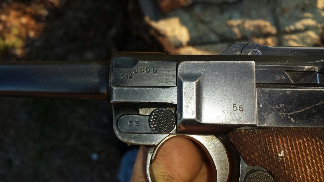

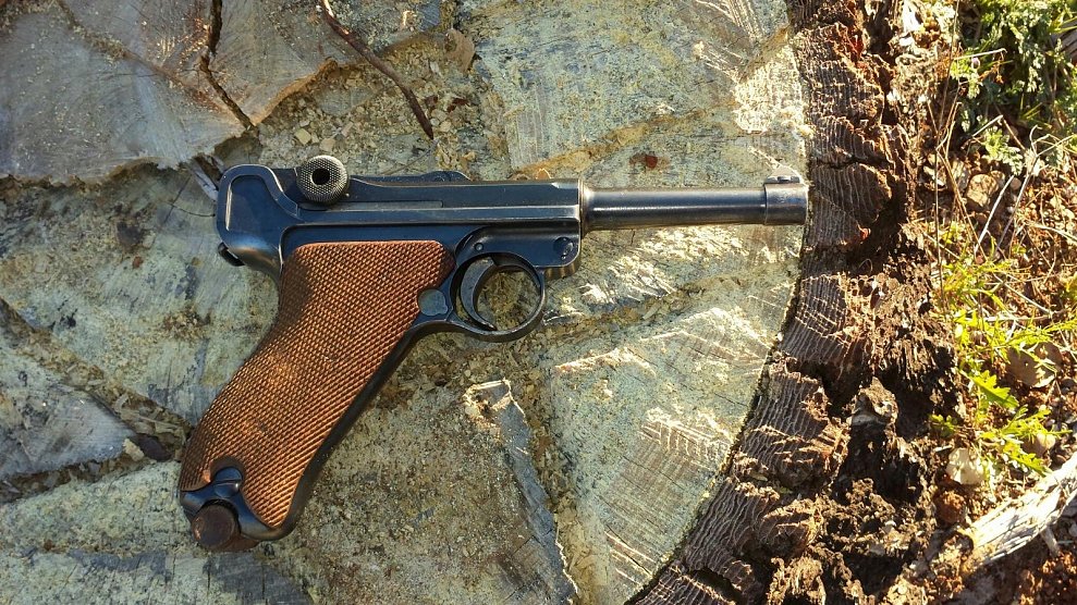

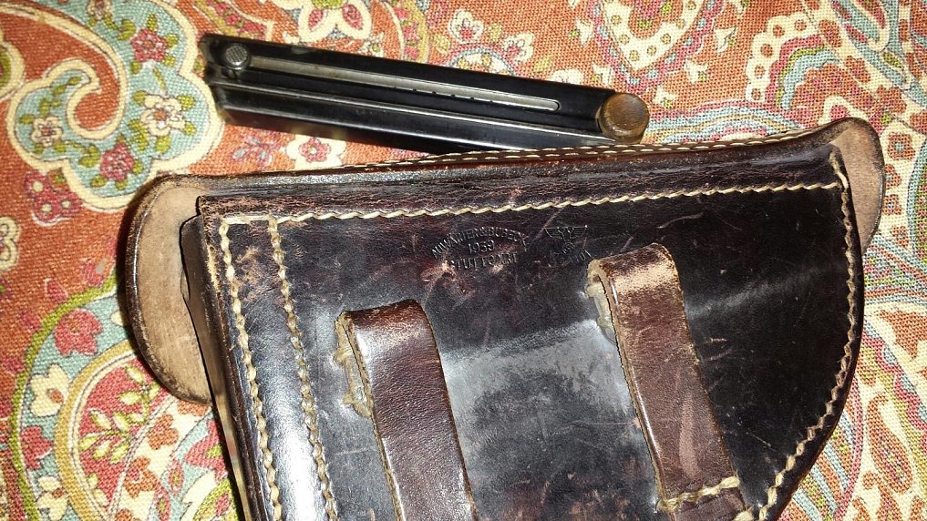

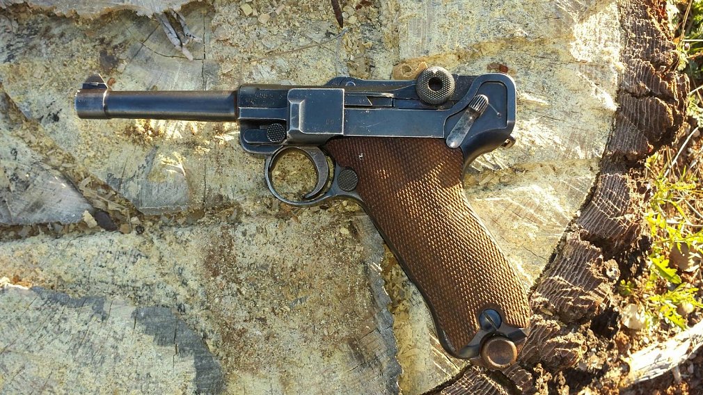

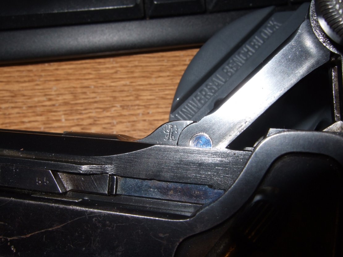

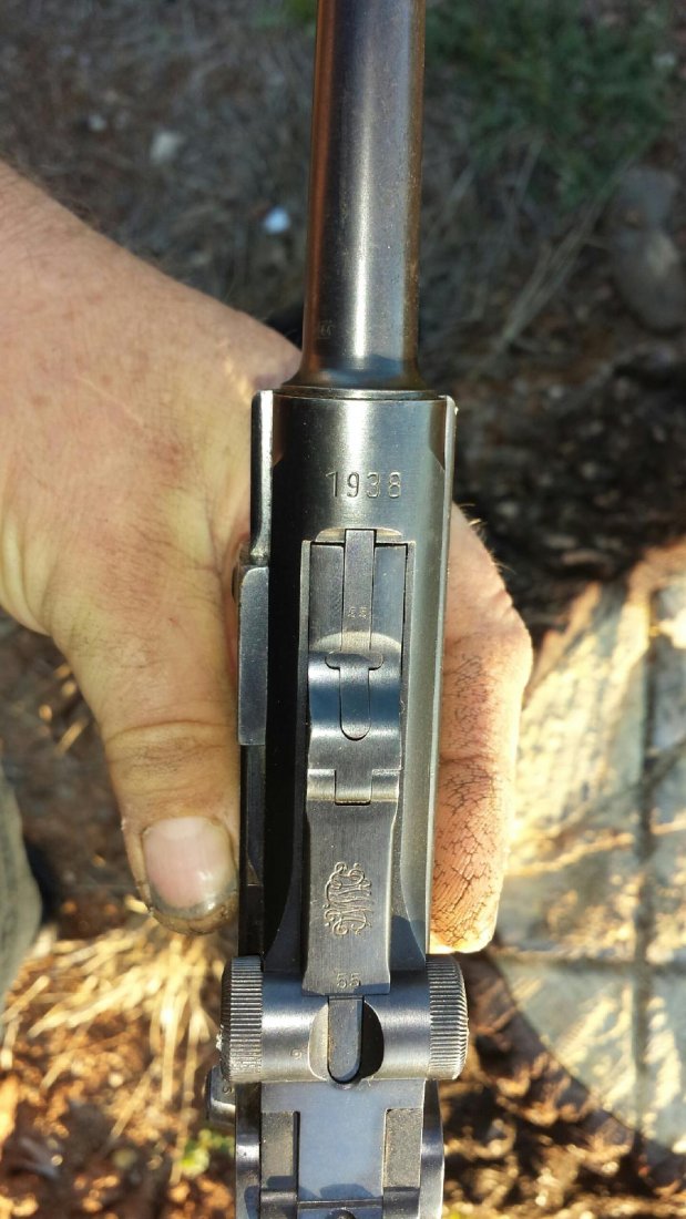

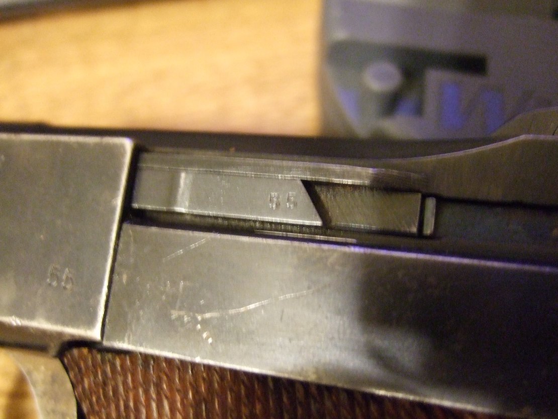

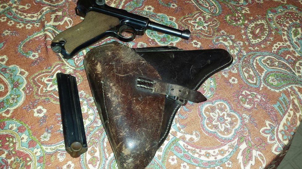

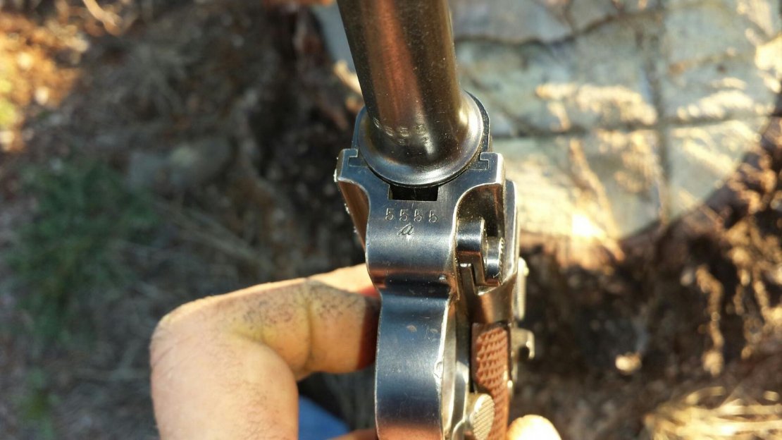

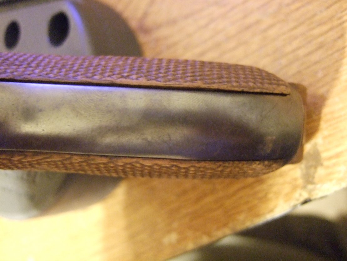

Hell all, I recently picked up this pistol as a part of a trade. I have always wanted a Luger and I finally have one. Knowing what I know now, there are several bits that do not belong on this pistol. I have posted these photos on other boards, and I'm not trying to discredit the advice I have been given. I am wanting to know more about it, simply. I have not shot it yet, but the bore is mirror with strong sharp rifling. The holster is a 1939 with eagle and swastika. The grips do not match the pistol, but do match each other. There is a small chip out of one.
Okay, I know the toggle, trigger, safety and frame do not belong with the barrel and receiver. However, each has been serialed. I took it to my gunsmith and is words were either someone had a lot of time on their hands, or this was done by an armorer. His opinion was why go to all the trouble to match it when a new Luger person can easily spot that it's a parts gun. I figured that was good advice. I want a shooter, not a collector anyway, so I am very happy. I can take further pictures if you will only tell me what to take them of. Thanks in advance, I look forward to reading through all the threads here. Andy

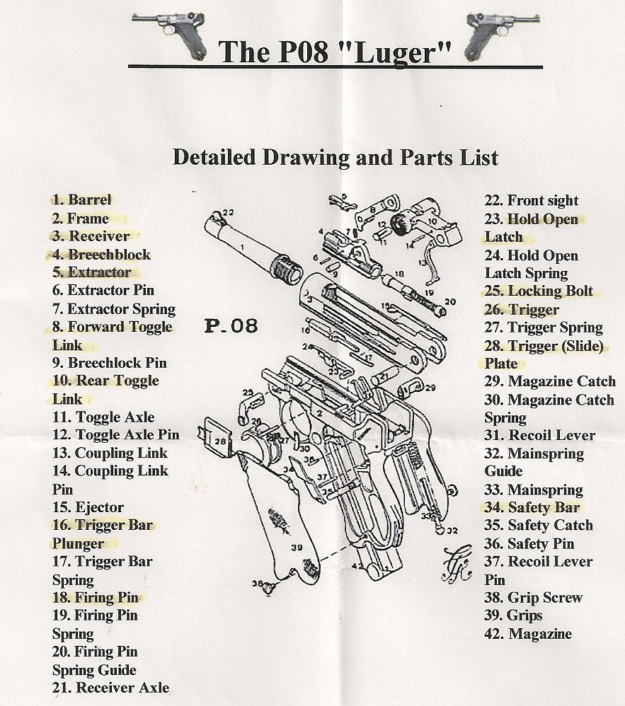

Here's a picture of the exploded view of a P08. Everything highlighted is serialed 55. I am really looking forward to shooting it. What ammunition is recommended? (gr, or brand) I know strictly ball ammo.

Yes, it does seem to have something of an identity crisis. It would be interesting to examine it more closely regarding the number stamps. But it is an old lower frame, with a later 1938 upper, which has no Mauser hump.
But regardless it is a nice looking Luger and hopefully it will shoot as well as it looks.
The holster appears original, and the blued mag. with the wood bottom is older, but their lineage is somewhat debatable around here.

Hi, I think I helped you on another board.
You most likely have a DWM Luger from WW-I that has had an armorer's replacement receiver installed just before WW-II in or after 1938.
While mismatched, it was most likely done while in military service and at a military armory.
Shoot standard velocity 115gn or 124gn 9mm Luger ammo.

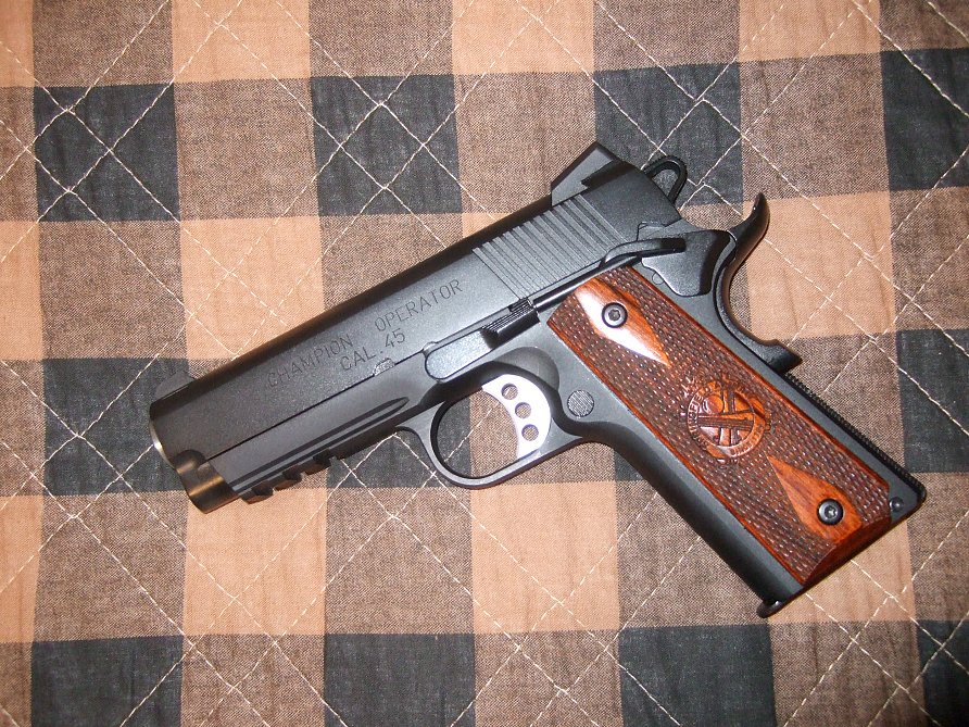

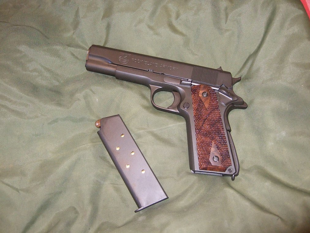

I have a lot of time on these (was my first issue sidearm, before the M-9). I know all about the wrist thing. Should be similar, I'm thinking.
