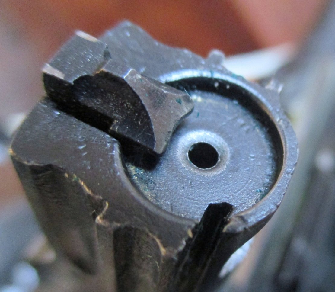

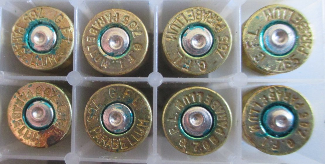

Took to range and observed the spent shells had primer deformation. Upon inspection,I noticed on the breech block face,the area around the firing pin hole is beveled? Collapsed? Worn? Metal fatigue?
Gun is in excellent shape. Non fluted firing pin in good shape.Functions great. Super accurate.(as all the 30 cal guns seem to be)
There was a thread from 2011 with a similar issue,but the OP never posted the outcome. My issue is a little different as there is very little raised area around the firing pin hole caused by dry firing.

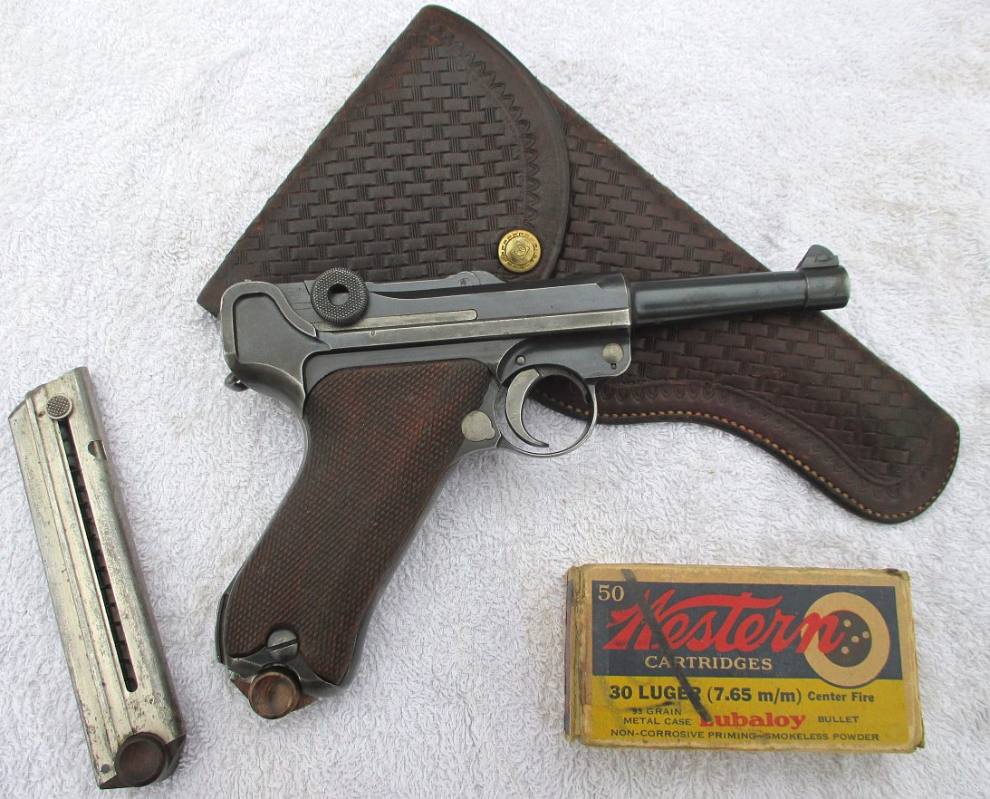

Here are some pics. The first is a gun portrait I did. I like period accessories!
Thanks for any advice and help.

That's a head-scratcher for sure...If it had been dented OUT, I'd say excessive dry-firing...But dented IN, WTF???
I looked at the breechblock print, the cross section, and that area around the firing pin hole is the thinnest part of the breechface, but I really can't see anything that could dent it in...
The only thing that comes to mind is maybe it was dented out from dry firing and some-bubba hammered it back in...Too far...
If that was true, I would expect the firing pin to not protrude as much as it should...

Gents.
Thank you for the feedback.
The center of the breech block face is not flat. It is sunken down.Almost like someone machined a bevel,as its very even in shape. When I look inside the breech block it doesn't look pushed in. However its hard to make out small protrusions at the bottom of a dark tube!
On the primer flow,it looks like the primer is filling in the sunken part of the breech block face.AFAIK Fiocchi is a little hot,but the gun exhibits no excessive recoil.

Unread 02-23-2015, 03:50 PM   #6
The firing pin hole in the breechblock "appears" to be oversize... at least to me.
I think I would find some hole gauges or decimal sized drill bits and find out what size the hole is and compare it to the Luger blueprints or other some other Lugers. Could be someone may have unintentionally damaged the breechface in an attempt to clean up burrs on the firing pin hole...
If it turns out to be critically oversize, it could be repaired by microwelding and re-drilling the firing pin hole to specifications.

Thanks: 2,746
As noted above, this is a most interesting condition. On examining the fired primers, it is obvious that there is a depression of the breechblock face in the area of the firing pin hole. It seems to be very uniform. It is as though someone used a tapered punch/drift and struck the area surrounding the firing pin hole., basically over correcting the problem.
I had a protrusion of material surrounding the firing pin, supposedly from dry firing, and corrected it with a flat faced brass drift and a hammer.......now the breechface is uniform. My spent primers look normal.
If you are overly concerned about it, and wish to continue shooting it, one could fit an aftermarket breechblock just for firing.

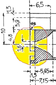

Unread 02-23-2015, 04:08 PM   #8
I just checked the blueprints (If you owned a set you could check them yourself --see the For Sale forum for how to obtain them...)
The firing pin hole size SHOULD be 1.6 mm + or - 0.05mm tolerance There should be no depression around the hole.

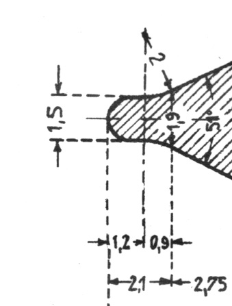

Unread 02-23-2015, 05:10 PM   #9
Default Firing Pin Tip Measurement
Hello Rick... just cause you asked... (and I bet you DO have a set of the blueprints tucked away)

Default I would.....
Try to determine if it was made that way..or dented in from flat... if the latter, I would remove the extractor, and with the breechblock set flat on it's face over a brass plate, take an old firing pin, and use it as a punch form to drive the depression back to flat from the backside??..... Maybe not the best, but it's what I would try...Best to all, til...lat'r....GT....

Default Primers Surface
The first picture of the spent cases look to me like all the primers have a convex shape suggesting some blow back. To my eye they appear to be raised as opposed to a flat surface. Perhaps these cartridges were to hot for this pistol and the primer caused the depression in the breech block.
You show a box of Western ammo. Were the cartridges you fired reloads or the factory ammo?

Aldo & Hugh
Thanks for the idea. So perhaps the expanding primer is causing or has caused the indent in the breech face?
The ammo I was shooting is factory loaded Fiocchi FMJ. I understand its loaded a little hot because it is also used for those pesky SIGs, Browning HI Powers and Benellis that have barrels in 30 luger.
I have not shoot this gun much at all. Maybe 50 rounds since I have owned it.I wonder if a PO put some hot reloads thru it?
