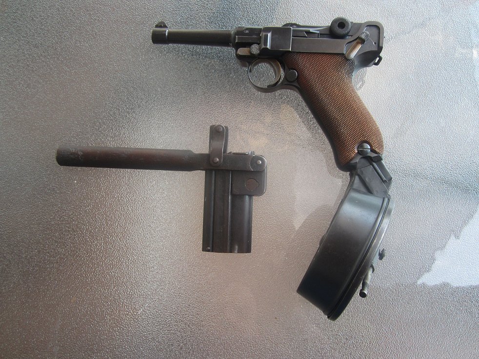

I'm thankful I own 12 mags. At 5 loads each I will have 60 shots before reloading with my trusty face cloth!! My other alternative seems a little over board!~~Eric

Unread 03-20-2014, 06:32 PM   #19
Curss
Curss's Avatar
Join Date: Sep 2009
Location: Florida
Posts: 307
Thanks: 304
Thanked 98 Times in 75 Posts
I like the alternative!!!
-Chris
