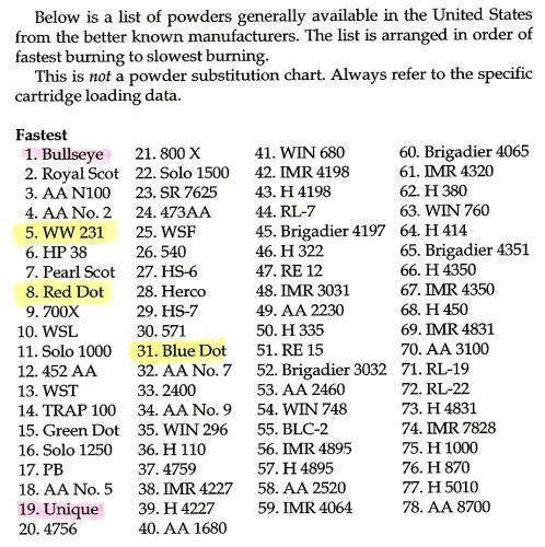

I thought it odd that you'd select AA#7 rather than AA#2 (which is on my wish list), so I checked my Hornady powder comparison list [pic below]...
I presently use Red Dot. I have most of a can of Blue Dot (similar to your AA#7) but too much goes unburned out of a 4" barrel (I use it in my larger magnums). I like WW 231 but it is not available in my area for several years now. I detest Bullseye and Unique and haven't bothered to try newer powders.
(Ignore the highlighted powders - they were for a different comparison).

It has always amazed me as to how different the burn rates are depending on whose burn rate chart that you read. When I compare my Hodgdon Burn Rate chart to the one that Sheepherder posted, they are way different. His lists BE as the fastest, and mine lists BE as #9, with others as faster, including Red Dot as #6. Winchester 231 is #23 with Unique being #25. HS#7 and Blue Dot are very close as to burn rates.
I guess one looks at many burn rate charts, and try to extrapolate the results. I would think that No. 7 might be a bit dirty when loaded low because it is such a slow powder, but if it works for you, then you have a winner.
