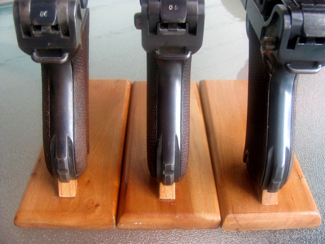

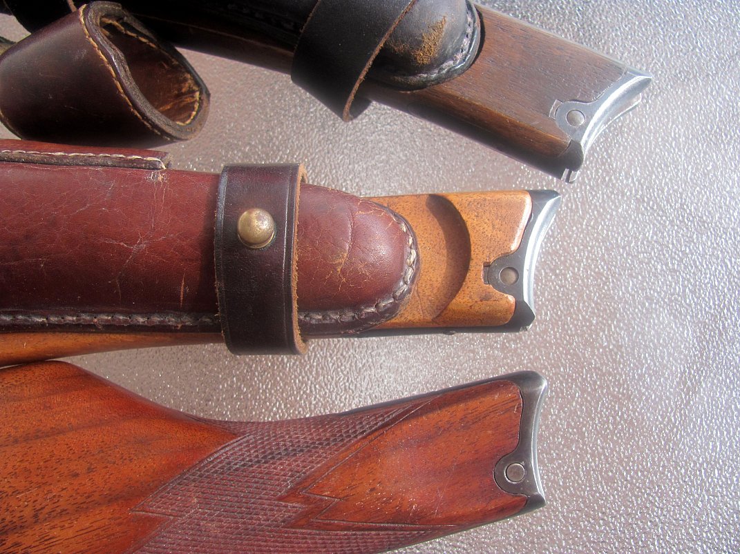

My stocks are not interchangeable! Neither are both my artillerys. On the left is the artillery with most wear! The logistics of fitting each must have taken a lot of work and time! The 1908 navy is in the middle with nominal wear. The is no wear at all on the 1937 Krieghoff. A stock lug maybe used only in production process and in the blueing process~ Eric

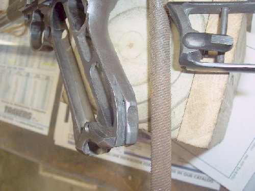

My attaching iron wouldn't latch right...But I fixed it...
Unread 01-06-2015, 04:16 PM   #3
That wood rasp looks effective, but wouldn't a cutting torch been quicker?

My stocks are not interchangeable! Neither are both my artillerys. On the left is the artillery with most wear! The logistics of fitting each must have taken a lot of work and time! The 1908 navy is in the middle with nominal wear. The is no wear at all on the 1937 Krieghoff. A stock lug maybe used only in production and in the blueing process~
I think the most time I have spent on fitting a stock iron is maybe 15 minutes. You don't have to remove a lot of metal. I am sure the original fitters knocked them out very quickly.
