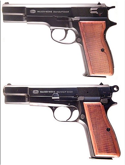

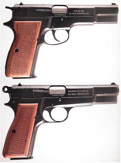

Here is the Mauser Model 90 DA. Produced by FEG for Mauser, based on the S&W Model 56, which in turn was a combination of the FN Hi-Power and the P38's double action feature.
Shown together with Mauser's / FEG FN Hi-Power clone.
