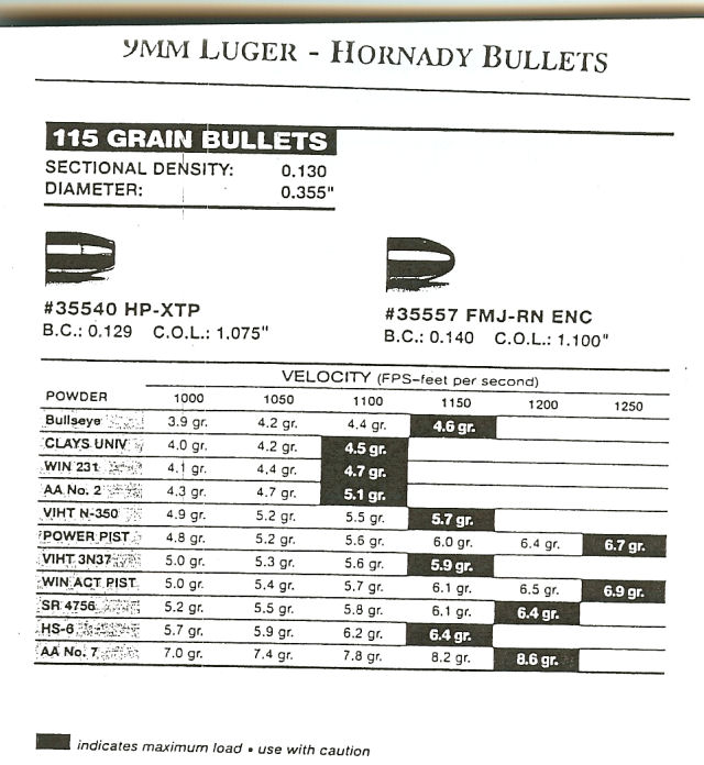

Hornady's Fourth Edition Vol 1 lists 5.5gr of W231 as max; 4.5gr is lowest for the 115gr FMJ-RN.

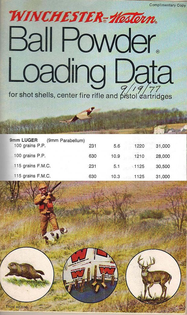

And just to show that you can't trust just one source, here's a scan of a booklet from eBay...

When I first started reloading, this is what Winchester had for 9mm loading data.
-Peter

I see what you're saying. If you look at the load data from the WW booklet, all it gives is 5.1 gr for a 115 gr full metal case bullet (see previous reply) so I didn't consider the 4.7 gr hot.
