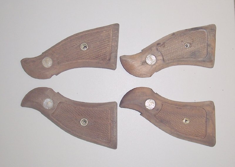

I have used a combination of Citrus-Strip [and let dry] and lacquer thinner [and let dry] on these S&W K-frame grips. I just wanted to get rid of the remnants of the OEM varnish or whatever S&W uses. I'm not too particular about oil stains or chips as these are going on old police revolvers which show a lot of use on the metal parts. I just wanted a uniform glossy finish.
I spent a bit of time on the left set. Oil & grease came out pretty well with the Citrus-Strip & lacquer thinner.
To refinish, I tried BLO and it didn't look glossy at all. Strip & try spray-on polyurethane finish. Still not right (I have a new set of grips to compare them to). Strip again; same two-step process. Citrus-Strip & let dry; lacquer thinner & let dry.
Now they're dry. I'm thinking Minwax Furniture Varnish, brushed on. Neutral color.
Any ideas???
Ron???

I like BLO, but the approach I take is to dilute it with mineral spirits, and build it up over several layered applications.
BLO has to be rubbed into the wood, and works because of the heat you generate as you do this.
Doing this over checkering is more difficult than on smooth stocks.

The checkering sure screws it up when using oil, it makes it difficult to wipe it off and it tends to build up in the checkering if you don't get the excess off. A toothbrush is a really handy tool for this, I buy them in 6-packs at Wallyworld for $1. I usually use Formby's tung oil (which I believe is actually a mix of oil and wipe-on varnish), and it works well as long as it's fresh and thin. If you put on enough of this, you'll get a nice "almost gloss" finish, but it takes 10-15 coats to get there. If you're in a hurry, you can also use oil from an old bottle, as it tends to thicken afterwhile. This won't soak into the wood nearly as well as the fresh oil, but it will build up the finish quicker.
For the S&W grips I'd use rattle can poly, it comes in several different sheens so it's mostly a matter of finding the right kind.

I have had good luck with Formsby's Tung Oil for a matte finish, and Caseys Tru Oil for a satin sheen. It usually takes me 3-4 thin coats, and I use a soft toothbrush to remove excess finish from the checkered areas.
