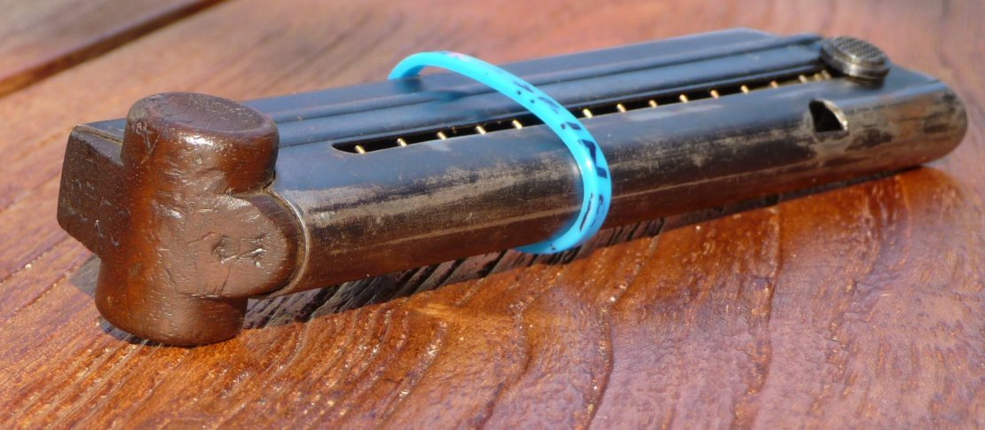

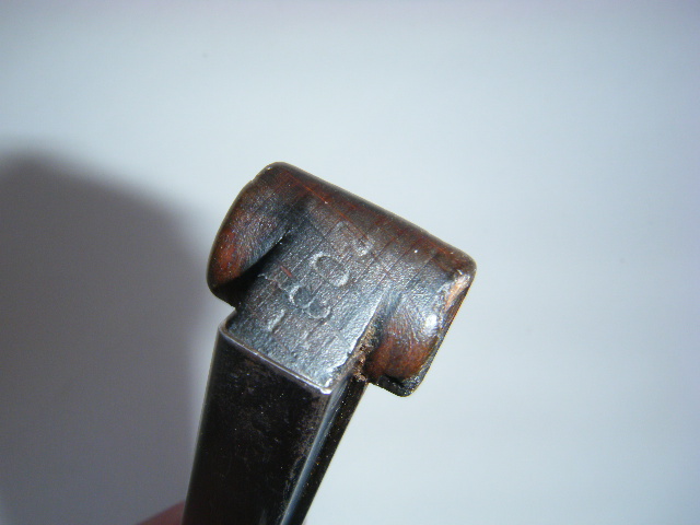

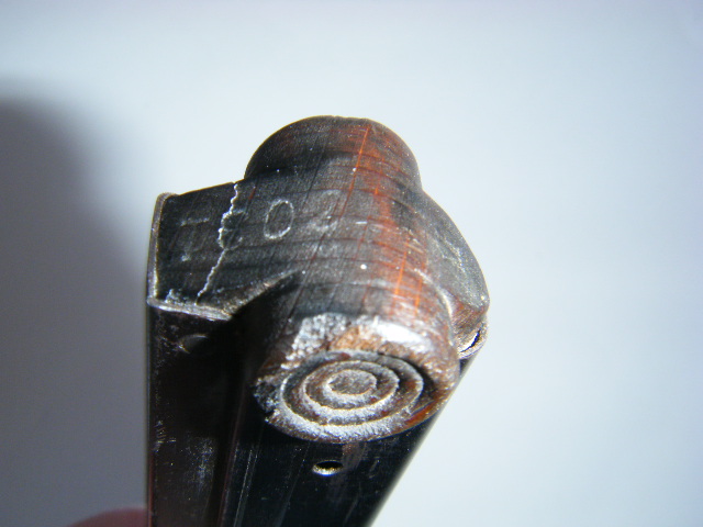

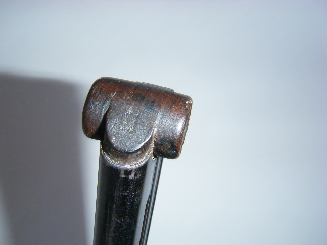

Unread 08-31-2014, 02:48 AM   #6
lfid
Location: Wichita, KS USA
Posts: 453
Thanks: 573
Thanked 96 Times in 53 Posts

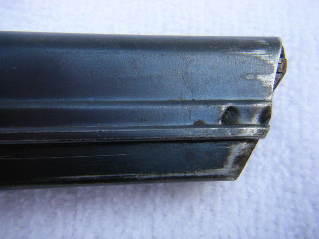

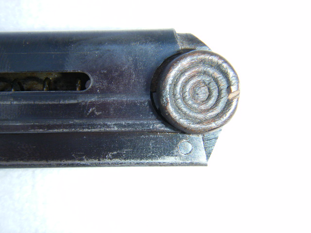

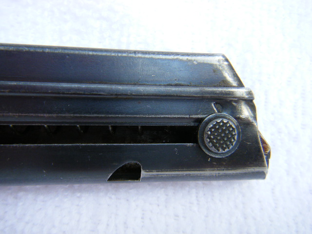

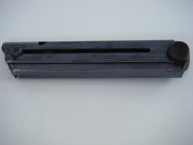

Norm,
sorry for delay in getting pictures
here are some of my best pictures so far for this blue body mag discussed in prior posts this thread
please take a look and comment
I also have a very similar mag with original looking unmarked standard wood bottom if that is of any interest
The two mags came to me from two unrelated sources / events
thanks
Bill

Unread 08-31-2014, 10:02 AM   #7

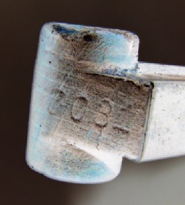

Hi Bill, It's a very interesting mag, I've never seen one like it. The late war beechwood base looks authentic and the rust blued tube sure looks like it was made by DWM. I'd like to add it to the list of orphan Navy mags that I keep, but I can't quite make out the number, is it 3801?
Regards, Norm
Unread 08-31-2014, 10:28 AM   #8
...I can't quite make out the number, is it 3801?
Regards, Norm
Looks like 3081 to me...
Unread 08-31-2014, 11:55 AM   #9
Thanks: 1,123
looks like 3031 to me.
Unread 08-31-2014, 02:41 PM   #10
Ron, it looks to me like the third number, bottom curl, is longer/reaches higher than the first number/three...
Bill, if you can't tell, maybe a couple more pics taken at different angles, right to left, would be more telling...
I'm no expert at anything, I just like to manipulate pics with different Gamma settings, and sometimes a negative image will show details that other effects don't...
Unread 08-31-2014, 03:21 PM   #11
Thanks: 1,123
On the third number the little "dot" at the start of the top curl is a dead giveaway that it is a "3"
I bow to the expert...
Unread 09-01-2014, 03:48 AM   #13
lfid
Posts: 453
Thanks: 573
Norm,
bright light and magnifier and various angles for about 30 mins , with my best near vision glasses and before the doze ...
I think serial is more likely 8031 than 3031 , since the top curl of the first digit is not as tall as the top curl in the clearer 3 3rd digit , and it doesnt seem likely they would have used number dies with that much variance for the same digit
I dont think the base has been changed out on this mag - the base pin is tight and looks aged like the lower mag body and has no tool marks on pin or mag body
please add to the orphan navy list as could be either number ( assuming 3031 and 8031 are in the range of valid navy serials )
are these large font serials running down the back plane of the base actually correct for a 1916-17 Navy ? or more likely for a 1906/1908 Navy ?
regarding my second mag that looks very similiar but with standard unnumbered base, I now think it has a partial proof mark on the base - did dwm proofmark unnumbered mags ? looks maybe like small crown over a C with a toupe between the C and crown
anybody have ideas on valuation for this Navy mag ? and also the similar standard base mag ?
thanks !
Unread 09-01-2014, 09:12 AM   #14
Hi Bill, Thanks for the serial number. Large numerals running lengthwise are correct for Navy magazines. Navy magazines in decent shape run from $300.00 to $500.00, however that cracked base really hurts. I'd guess $150.00 or thereabouts.
Regards, Norm

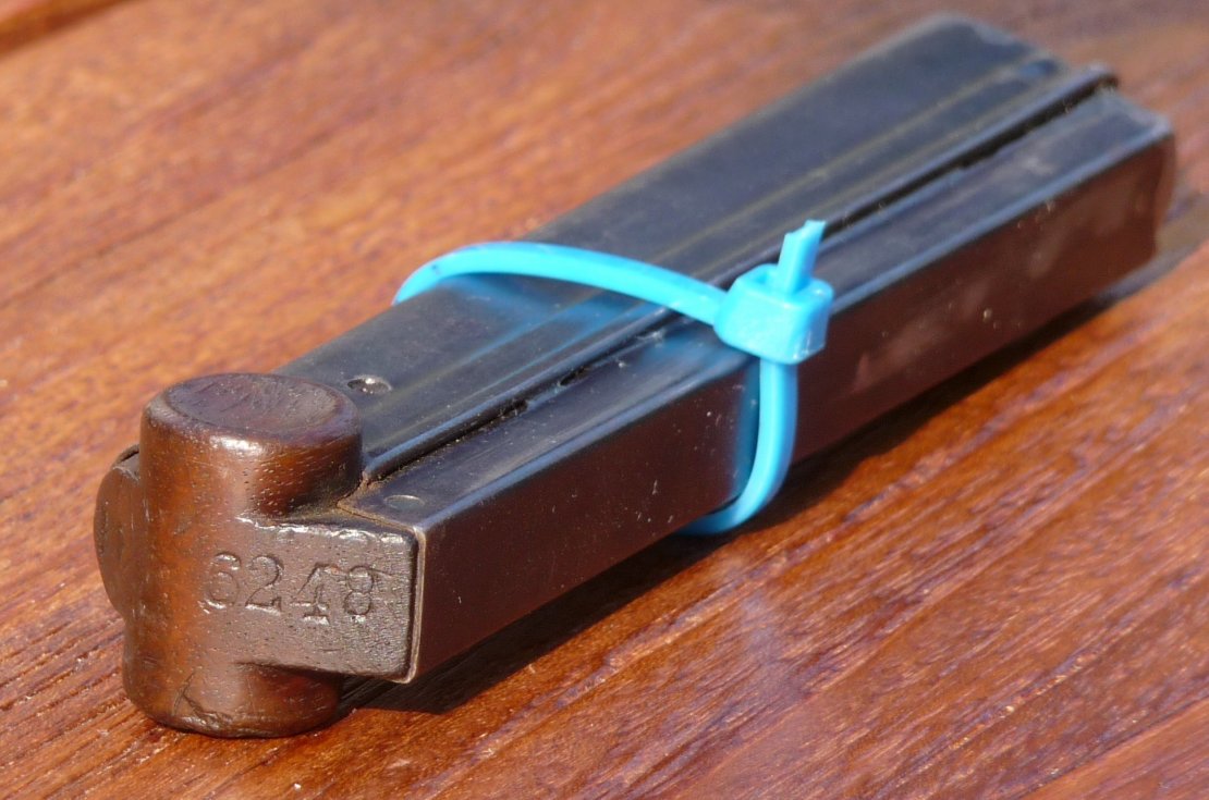

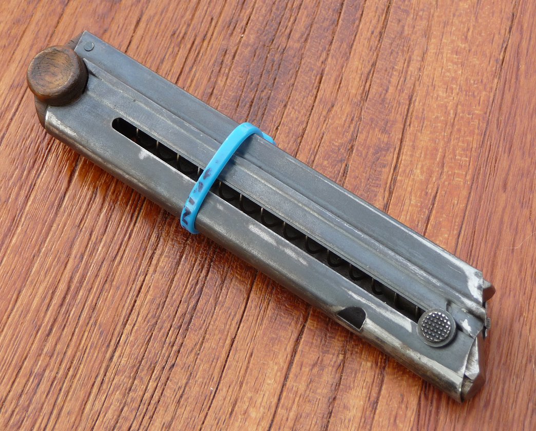

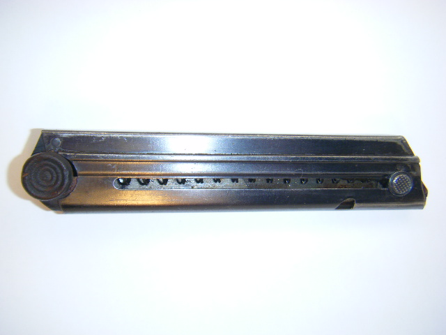

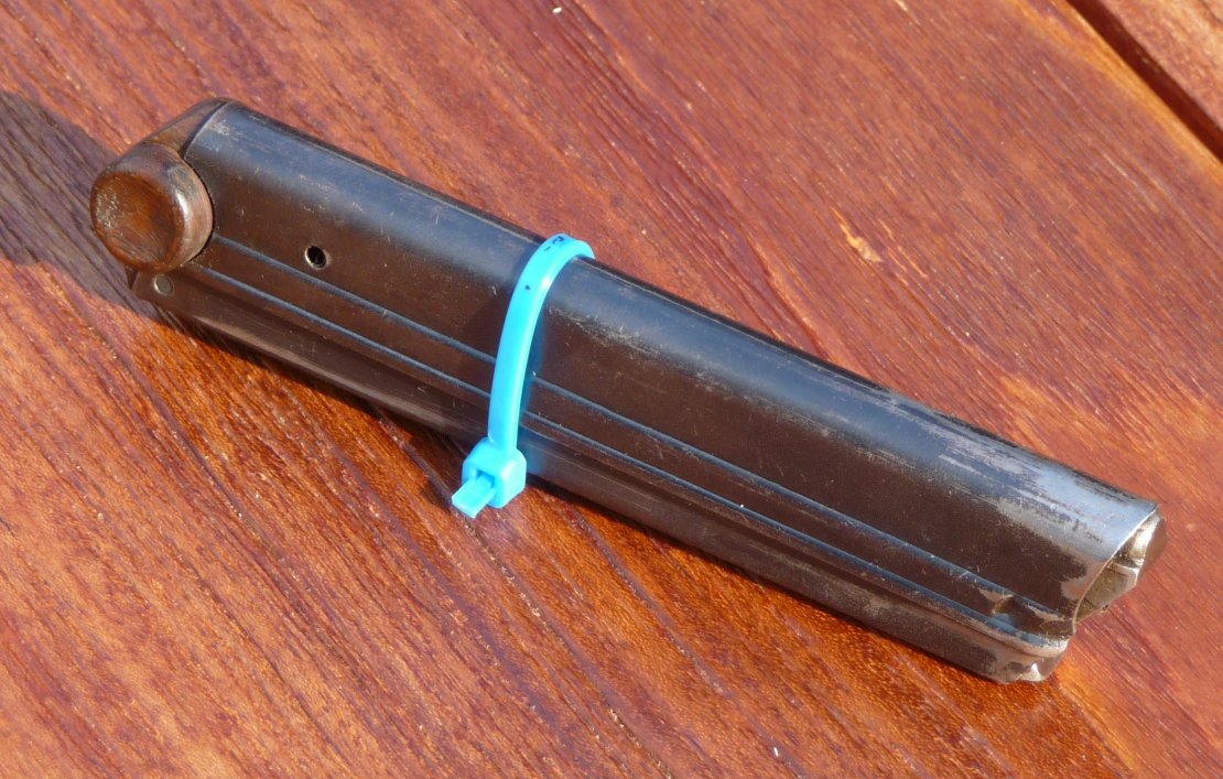

Unread 09-10-2014, 08:14 AM   #17
Armin
Location: Germany
Posts: 35
Thanked 11 Times in 6 Posts
Hi together,
here are a couple of pictures from another blued Navy clip.
Geoff Sturgess mentiones somewhere in his books that this kind of magazine was produced for the Navy towards the end of WW1 when economy ran tight.
Regards, Armin.

Unread 09-10-2014, 08:39 AM   #18
Armin
Location: Germany
Posts: 35
Sorry,
I forgot to upload the picture with the magazine's number.
