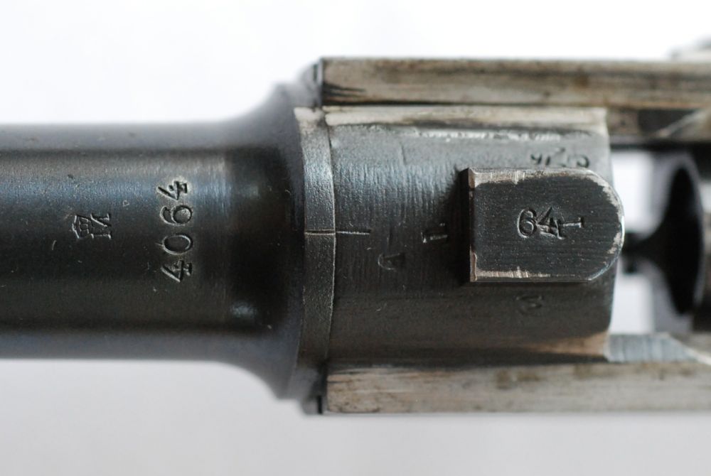

Hi John, 1916 Imperial Navies were numbered 1 to 8000, but the receivers had no external numbers. They were numbered with only the last two digits on the recoil lug (see photo).
Regards, Norm

So what about the lower receiver/frame serial numbers Norme?
