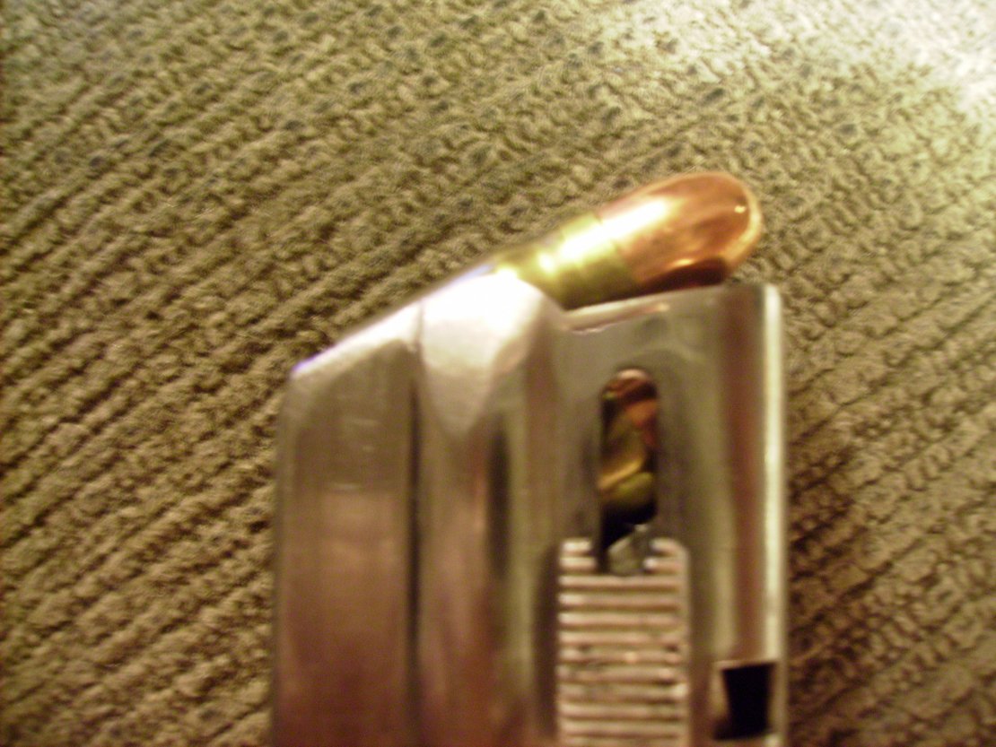

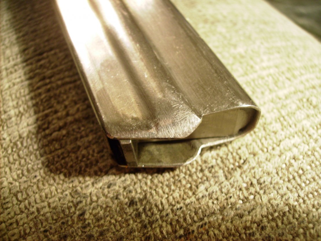

Anybody gotsa couple of pix of the top of a working nambu mag - with and without loaded rounds? It would be very helpful for comparisons...

Here's a couple quick ones.....Oh and we need to try to get John to quit hatin' on the Nambu! Somebody write a post about a Glisenti !
Thanx for the pix, Nuke! That should be enough to get me started!
